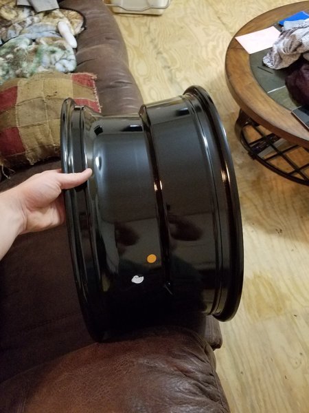

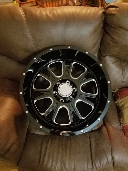

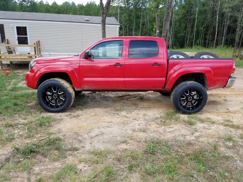

    I know it's not a common thing to run 20s on here, but I ordered some vision 399 deep dish fury 20x10 with 4.5 inch backspacing and they came in today, gonna wrap them in some 275/60 20 terra grappler g2s tomorrow and throw them on. I'm running 887 coils up front with ome shocks, so I'm sitting at exactly 3 inches of lift. Pics will come tomorrow to show off my new setup just in case anybody else wants to run something close to that there will be a thread that I will detail everything I had to do to clear them. It's 95% a pavement princess so I'm not worried about rubbing under flex offroad, but I've already trimmed the standard inner fender for normal 33 inch tire clearance. Like I said I will keep this thread detailed with all I had to do for minimal rubbing issues. Here's a spoiler of the wheels!!

    A little bit of an update, a CMC is definitely in order, and other than that a bit more plastic wheel well trimming and some slight trimming of the fender flair corners should be all that is needed in order to clear from full lock to full lock. Not to much unexpected though. So 10 inch wide wheels are definitely possible if your willing to put in the work.

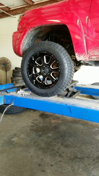

  3. Jul 29, 2016 at 1:39 PM
    Dalton092
    Dalton092 [OP] Well-Known Member
    Dec 20, 2013
    #118949
    318
    A closeup of tire and wheel

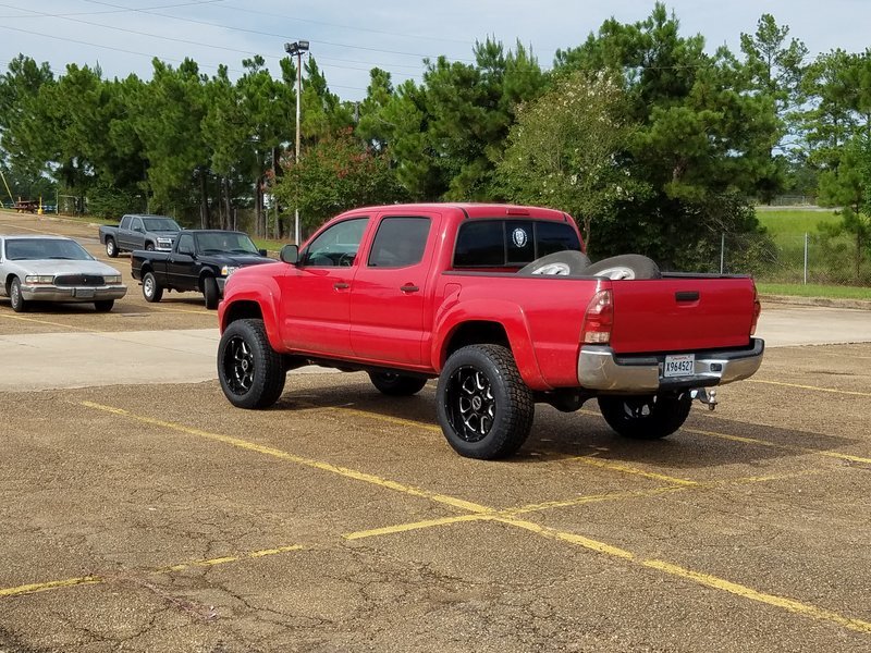

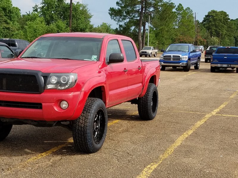

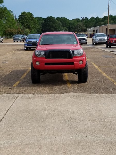

  4. Jul 29, 2016 at 4:06 PM
    Dalton092
    Dec 20, 2013
    #118949
    318
    More pics
