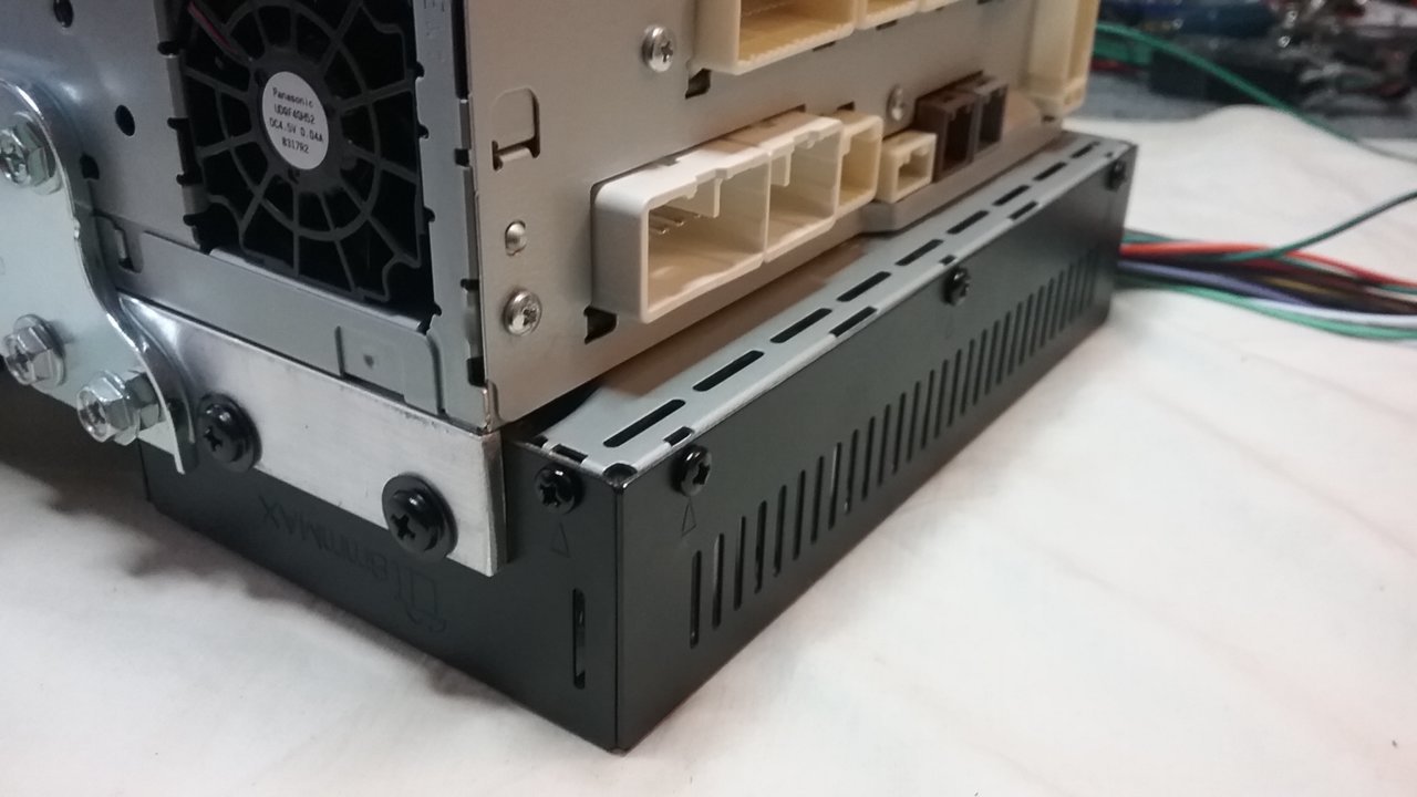

    The Pioneer DEQ-S1000A was just what I needed!
    Problem #1) Some source material is recorded too low to play loud enough on the factory head-unit.
    Although the Pioneer DSP's built-in amp isn't any more powerful than the head-unit, it has its own volume control that provides enough gain to compensate for weak recordings.
    Problem#2) Muddy bass.
    The Pioneer has the means to counteract the factory EQ curve, but I didn't mess with that. I did adjust the on-board EQ a little by ear, but the biggest improvement was provided by using the high-pass filter. I set the front channels to 63Hz, and the rears to 125 Hz, both at 6db/oct. The bass from the crappy little factory speakers is now nice and CRISP!
    With these adjustments, along with the time alignment and tweaking the individual channel levels, the system is now dialed-in where I feel good enough about adding a modest sub (using the DSP's provided sub-out).
    I ditched the XM unit and installed the Pioneer in its place. I mounted it upside down and backwards, with the cooling vents just aft of the head-unit to allow heat to escape.
    I was able to mount it to the factory brackets with these aluminum strips I fab'd up.
    Overall, I'm pretty happy with it, although the Android interface was buggy until I went with an OTG connection. It's nice that the unit provides flexibility with having its own amp, as well as having pre-outs for future expansion. $200 well spent IMHO.
