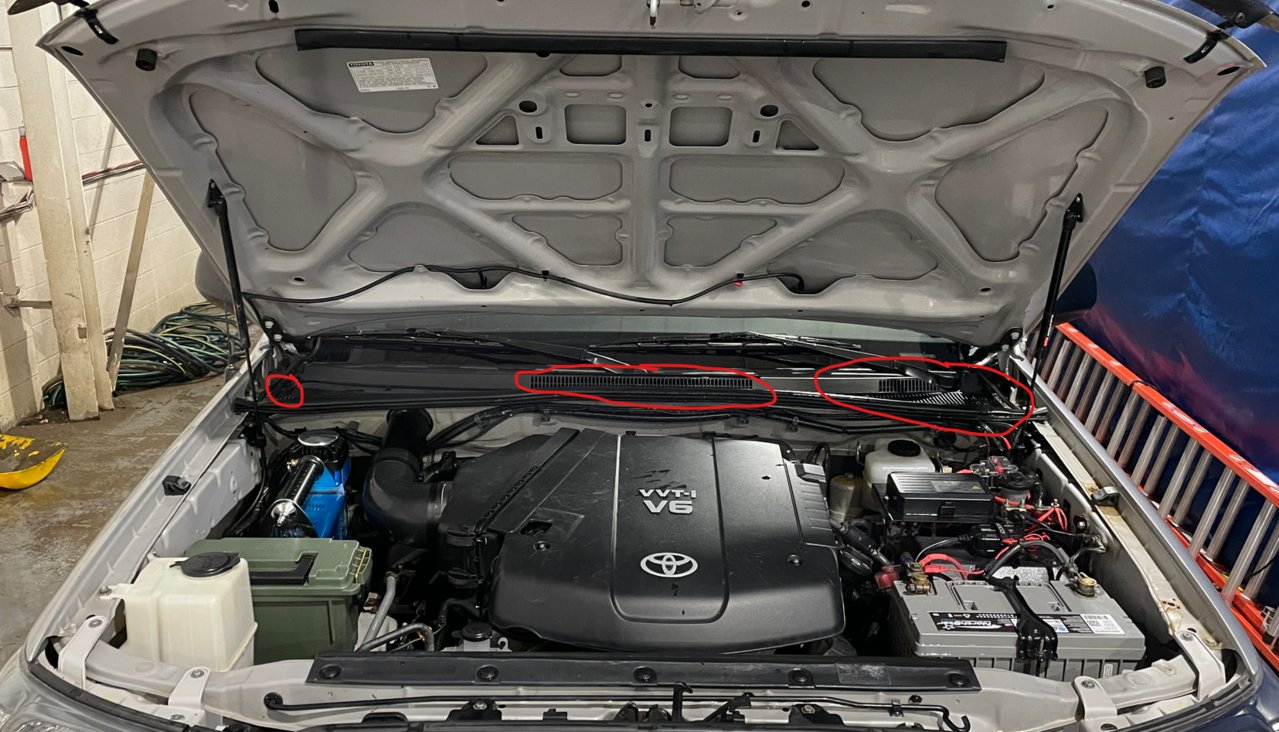

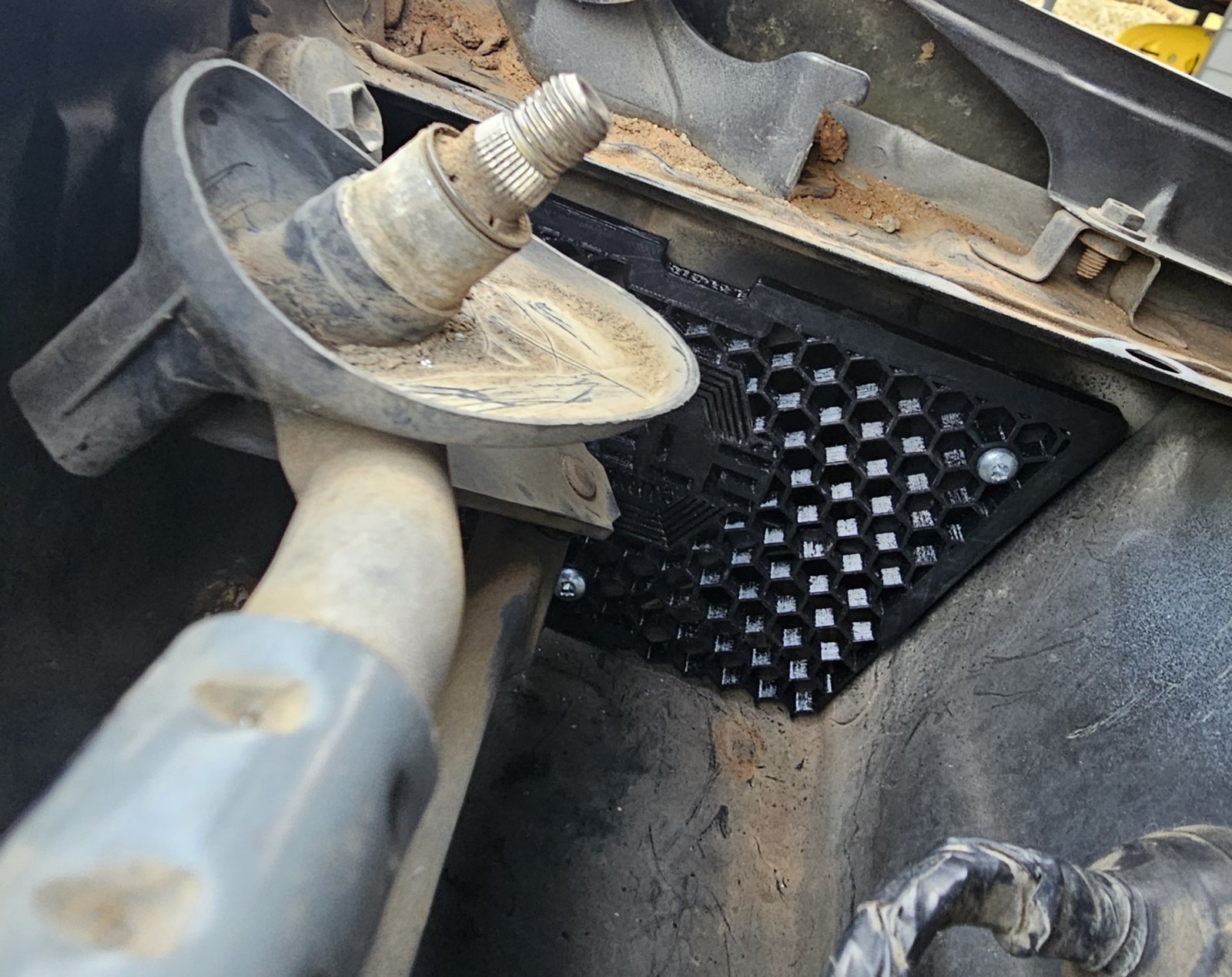

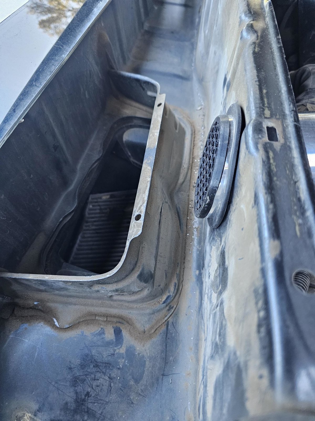

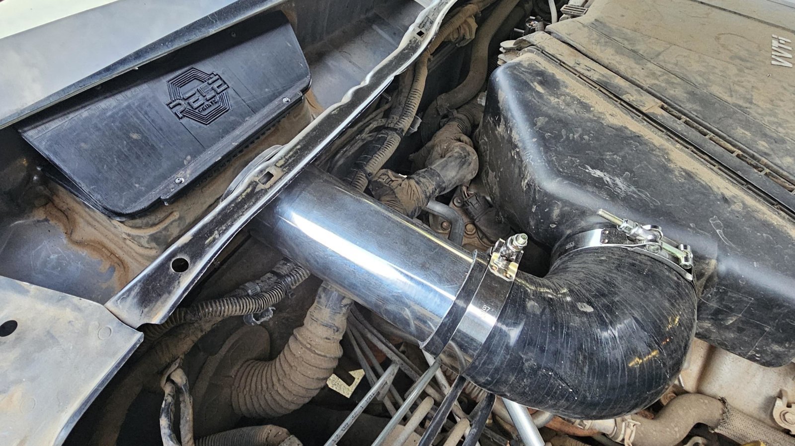

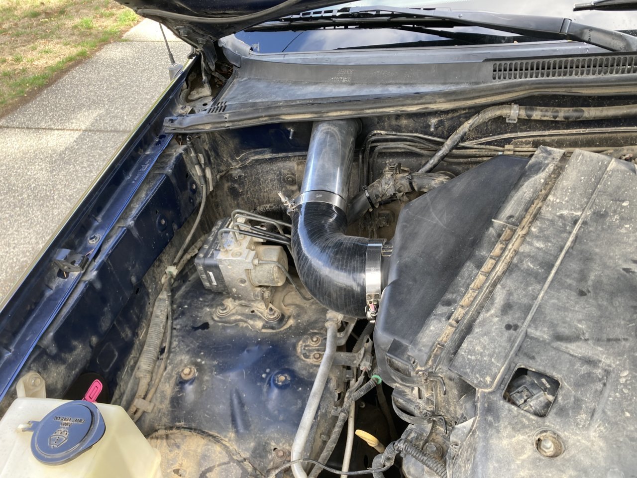

    I've never had water come out of my HVAC in a downpour when driving.

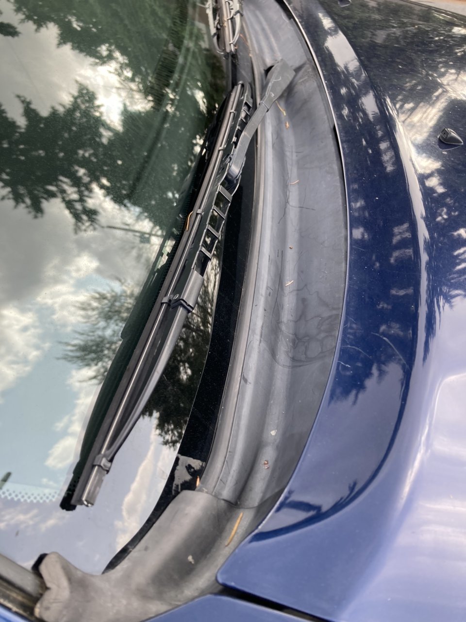

    Also, don't forget there is the plastic cowl cover that hides all of inners. so technically water cannot flow off of your windshield, off my HVAC cover, and into the intake. I'd recommend taking your cowl cover off to see how it is all built and placed. Way easier to understand. Here are some pictures to help explain.

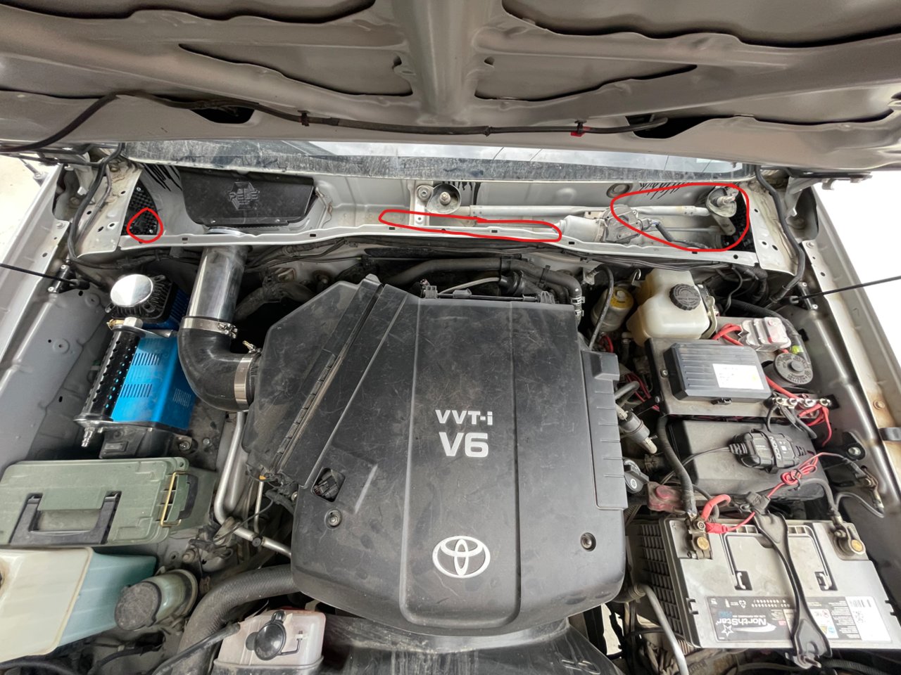

    Red circles are approximate locations of cowl holes for air flow.

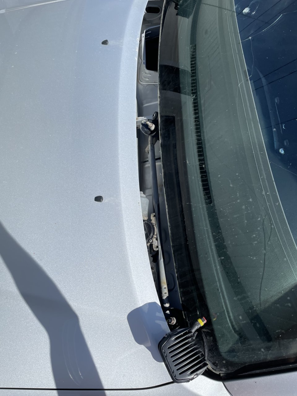

    Here is what the it looks like with the cowl cover off and the hood closed.
    If your cowl area is filling with water so much that it overflows in your HVAC intake, I would recommend cleaning out the sides. Leaves and debris can build up in there.

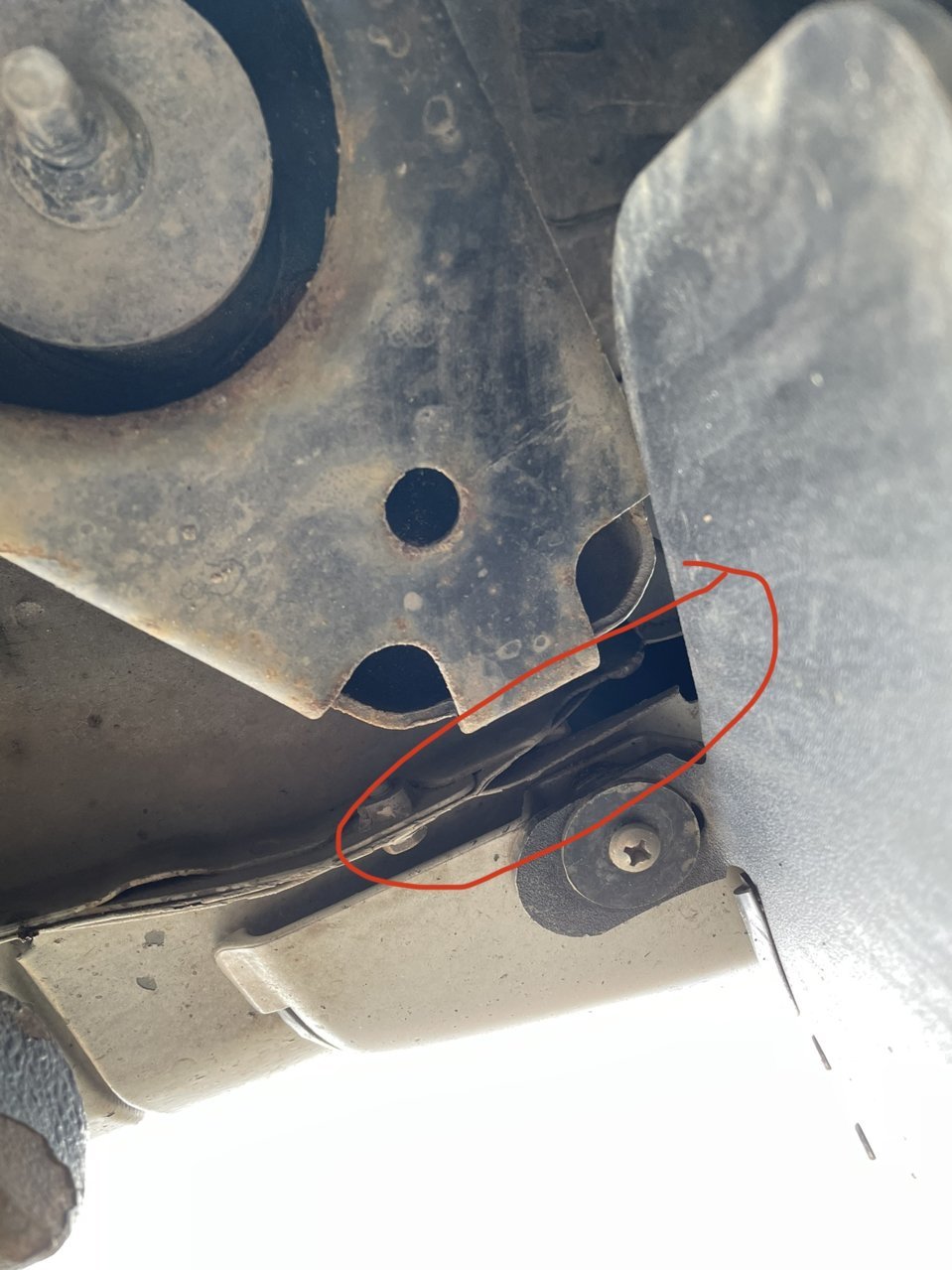

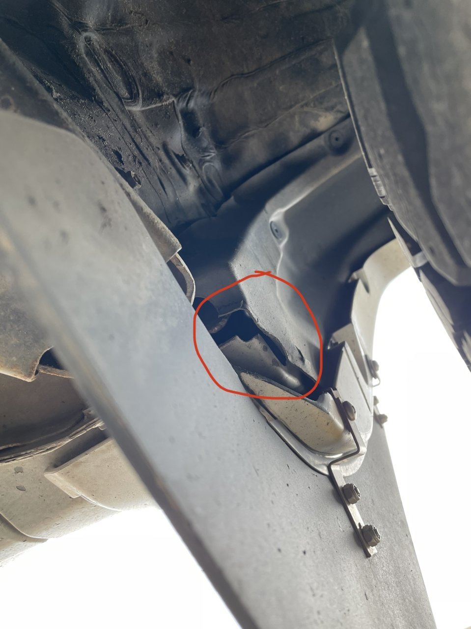

    Here is where the water drains out (right near your front cab mounts):
    Let me know if you have any more questions or concerns!
    Cheers,
    Dan

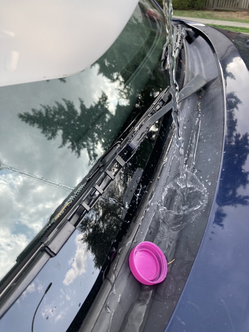

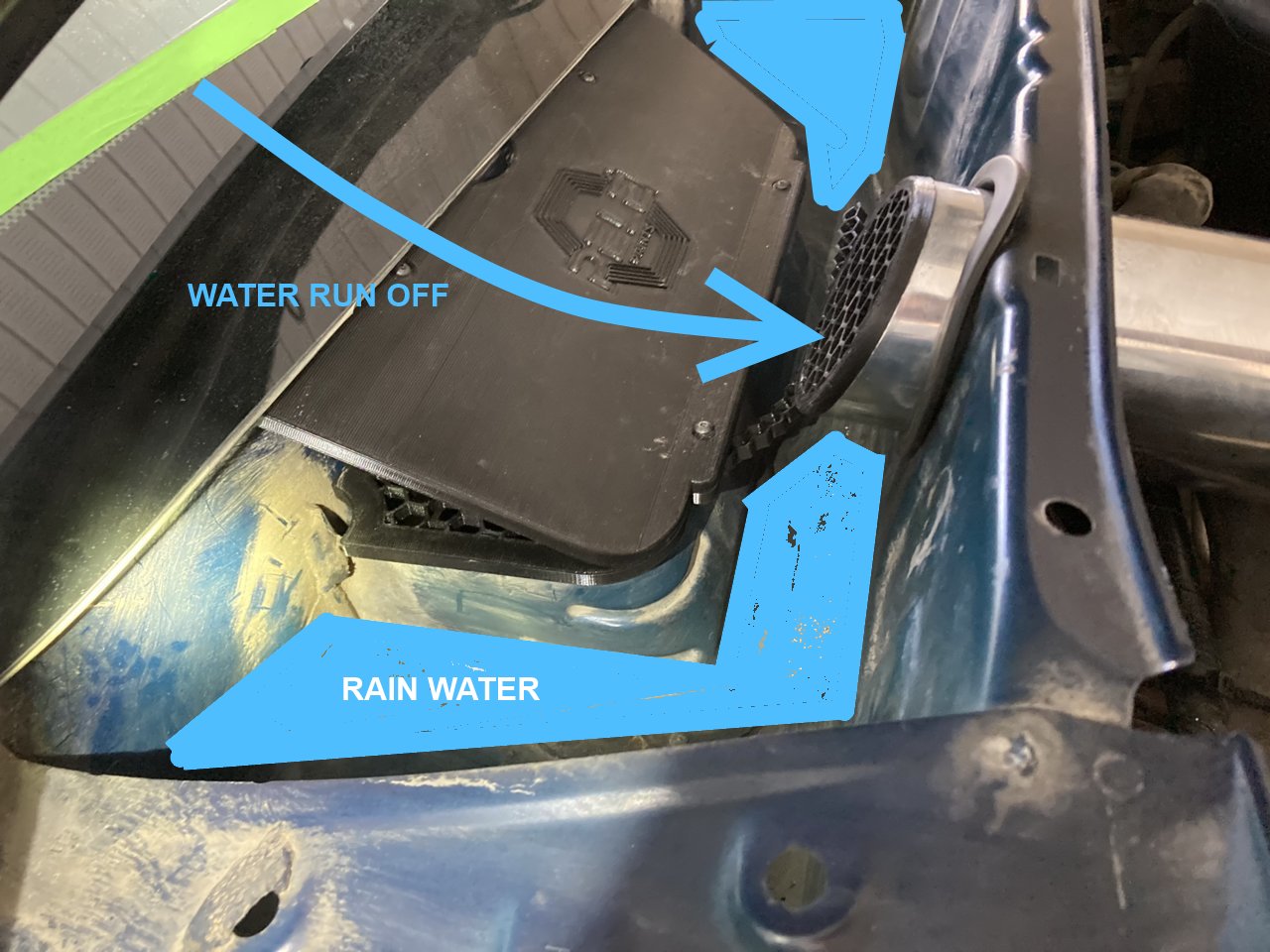

    I don't see how that's a possibility, unless you drive around with no cowl.
    I just did a test poring water onto the cowl here is why it looks like.
    Also, I see your point about there vents in the Center of the cowl.
    I don’t see how water droplets can make 4 90degree turns without losing momentum and hitting something.

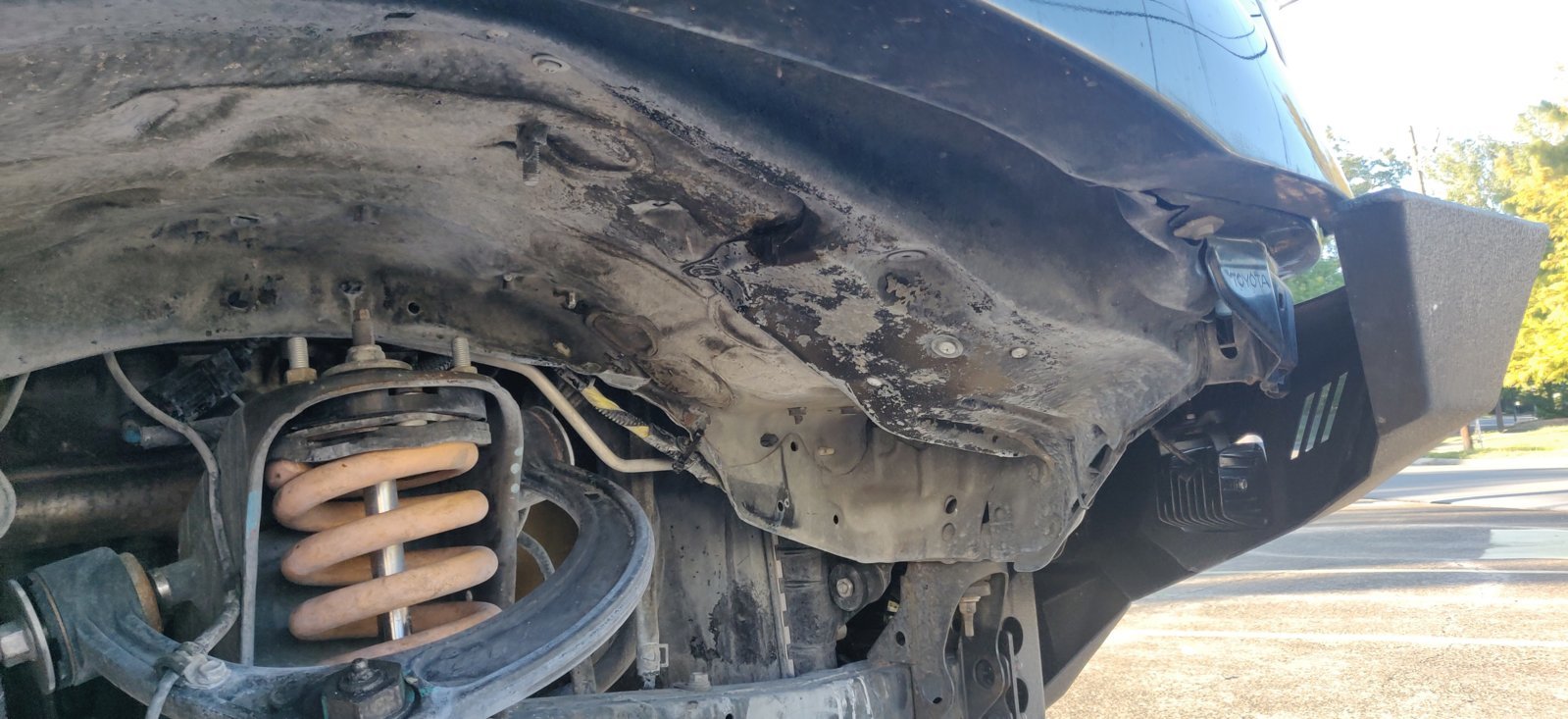

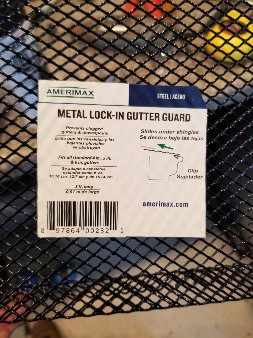

    When you add a bumper and have to cut the liner this is how you avoid what happened to you. You cut the liner to where you can screw it shut

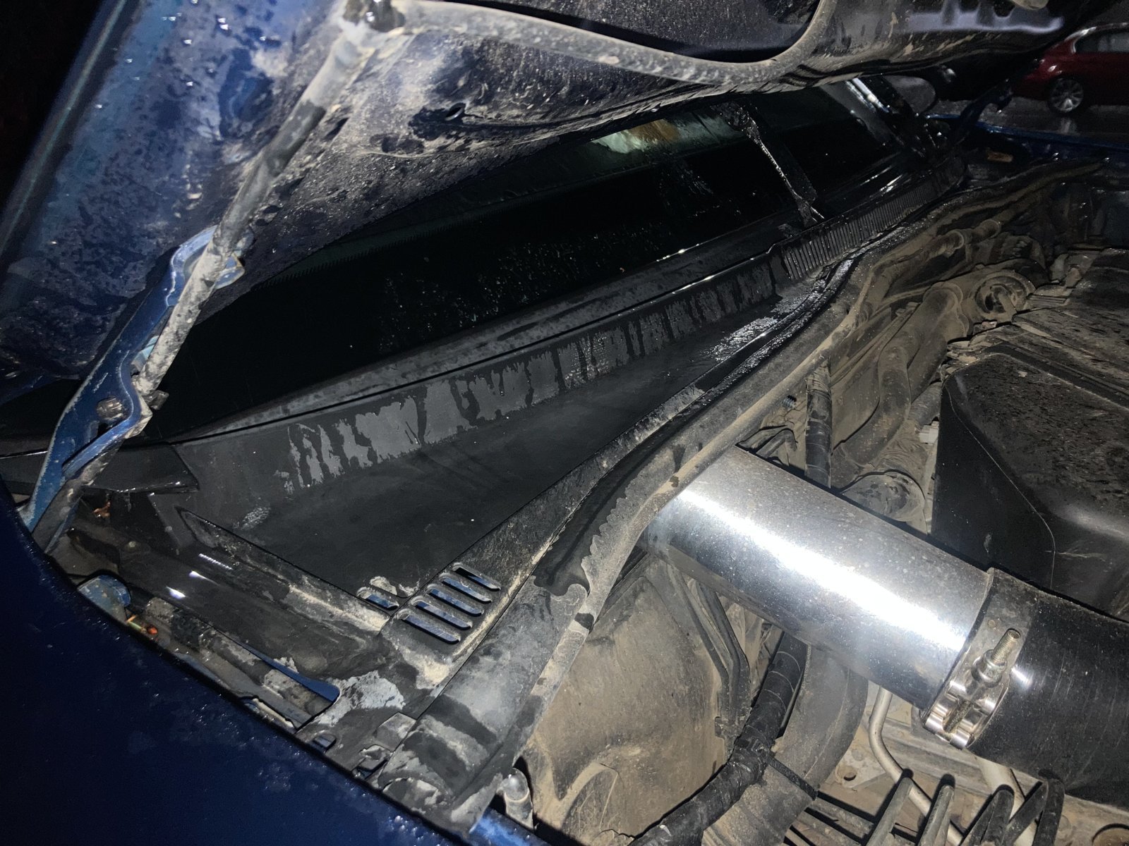

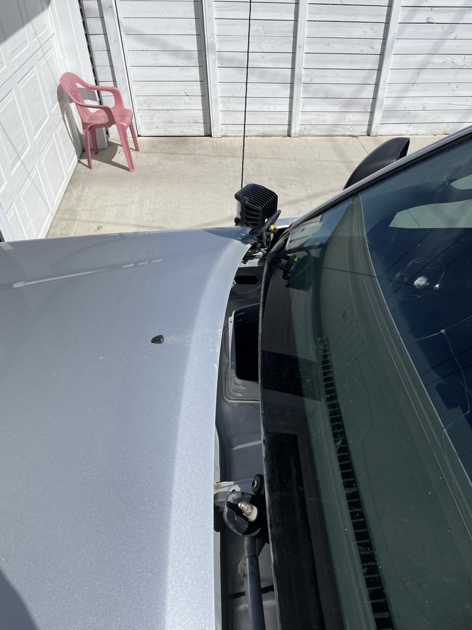

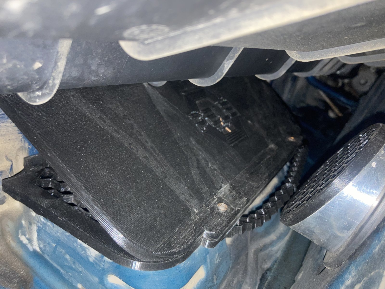

    It’s raining pretty heavily and drive thru some flooded streets at speed for fun. :D
    Here is what the cowl intake looks like.
    Looks pretty dry.
