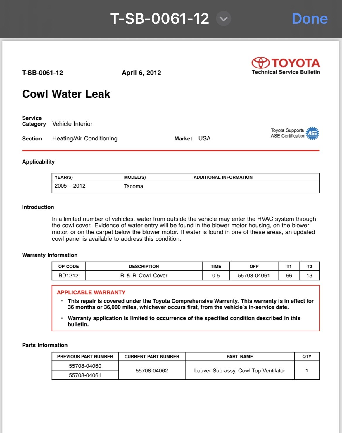

    3. anyone dealt with stock “trim” gap leak? The black factory plastic cowl piece basically. The long one.
    Had my windshield replaced by a good glass shop who pointed out the gap and suggested it could be warped from age which I believe.
    It looked installed properly, and I just took it back off and on again in a way I think is also proper. Yet there’s still a gap water would obviously sneak through.
    gonna look up part number. Hopefully a new one would fit better, resolve the gap, and confirm the old one did in fact warp. After all, the truck is old, I’ve seen this type of stuff before on other cars. And it even lived in the desert with 110degF summer and beating sun.
    edit: apparently there is a TSB for this advising to put a new cowl which looks expensive as hell. Must be some sort of high HP TRD Performance Cowl

    I did not mark the holes. I put the screen in place and drilled the first hole with drill bit and then installed a screw to hold the screen in place. Then I used drill bit to drill other holes. Then I removed the screen, drilled the optional 2 in hole and then hit it with some paint. Then put everything back on. It was tedious but all screws are secure
    I did not but was considering it. I did unhook wire that gives power to the wipers. I used a 90° drill bit attachment and drill bit extension. Without these I would not have been able to complete it on either side.

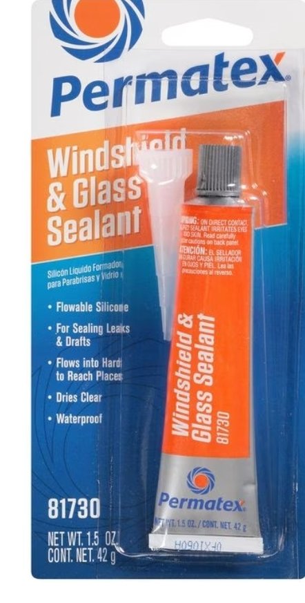

    Yes I did. I noticed the same thing and tried a couple of times to get it secure but then realized that the little plastic clips that are there to hold it on tight were gone. I did a test and poured water onto the windshield and it went right through the little gap and into the new intake. I did not have it hooked up to the engine so I could see if any water came out and it did. I called Toyota and was quoted $550!
    I did not want to spend that much so I did some searches for the best product to fix this and I put some of this silicone in the small channel that secures against the windshield.
    I then placed pieces 2x4 wood and stacked some weights on top of it to put pressure. I left it overnight. I did another test and it is completely waterproof and completely sealed.

    honestly, I think the stock cowl is bad new. And even worse with time due to heat, age, sun, deformation/warp. Have seen the same thing on other car cowls as well.
    was at the dealer parts dept for something else. Asked them yo by any chance does the computer also reflect revisions, as it should
    Yes.
    Makes sense. The above TSB is dated old.
    They said as of today, there have been a total of 4 revision PN's, with the latest ending in 4. According to my VIN, an '08. Also around $320+ new for a piece of plastic.
    I believe 55708-04064
    The gap is still small. So I'm not getting much water. Add the cowl shield I put from PELE which helps.
    But ideally at some point I'll replace the bad original cowl with a gap, with a better current one that I'll assume is better design and resolves that gap.

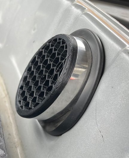

    Hello @dpele , wondering if you can share the rubber grommet style you are using? Does it shroud around both sides of the sheet metal, is it more of a bulb seal type thing, is it just hard edge seal material? Hard to know from photos and I can make some guesses, but would be better to know for sure. I only ask as I've been following the other cowl intake megathread for a long time and the choice of gasket type seems important.
    Also curious for anyone who has this kit if you've heard any rattles from the intake banging on the hole in the firewall or experienced any cracking on the sheet metal? I wouldn't expect it but have to ask. Not every day you cut a huge and somewhat permanent hole in your truck, and I've been on the fence about taking the plunge because of little things like this that can grow into bigger things.
    Overall looks like a nice kit and I'll probably be ordering once I stop being a chicken. Thanks for making it and sharing with our community!

    Hi!
    I use a rubber grommet with an inside groove. It fits the hole and pipe perfectly. The metal cowl sits in between the grommet grooves.
    This this the best picture I have of it:
    There can be play between the hole and rubber grommet if the hole is drilled out slightly larger. It is best to drill the hole nice and slow.
    If there is any play, one fix could be to use silicone between the grooves of the rubber grommet. Or perhaps a thin width of tape (electrical or similar) between the grooves of the rubber grommet.
    The two kits I have installed have no play. Sometimes the pipe will squeak but some silicon lubrication fixes that right away.
    Drilling a big hole like that is no joke! Scary, but it's like cliff jumping... just do it!!

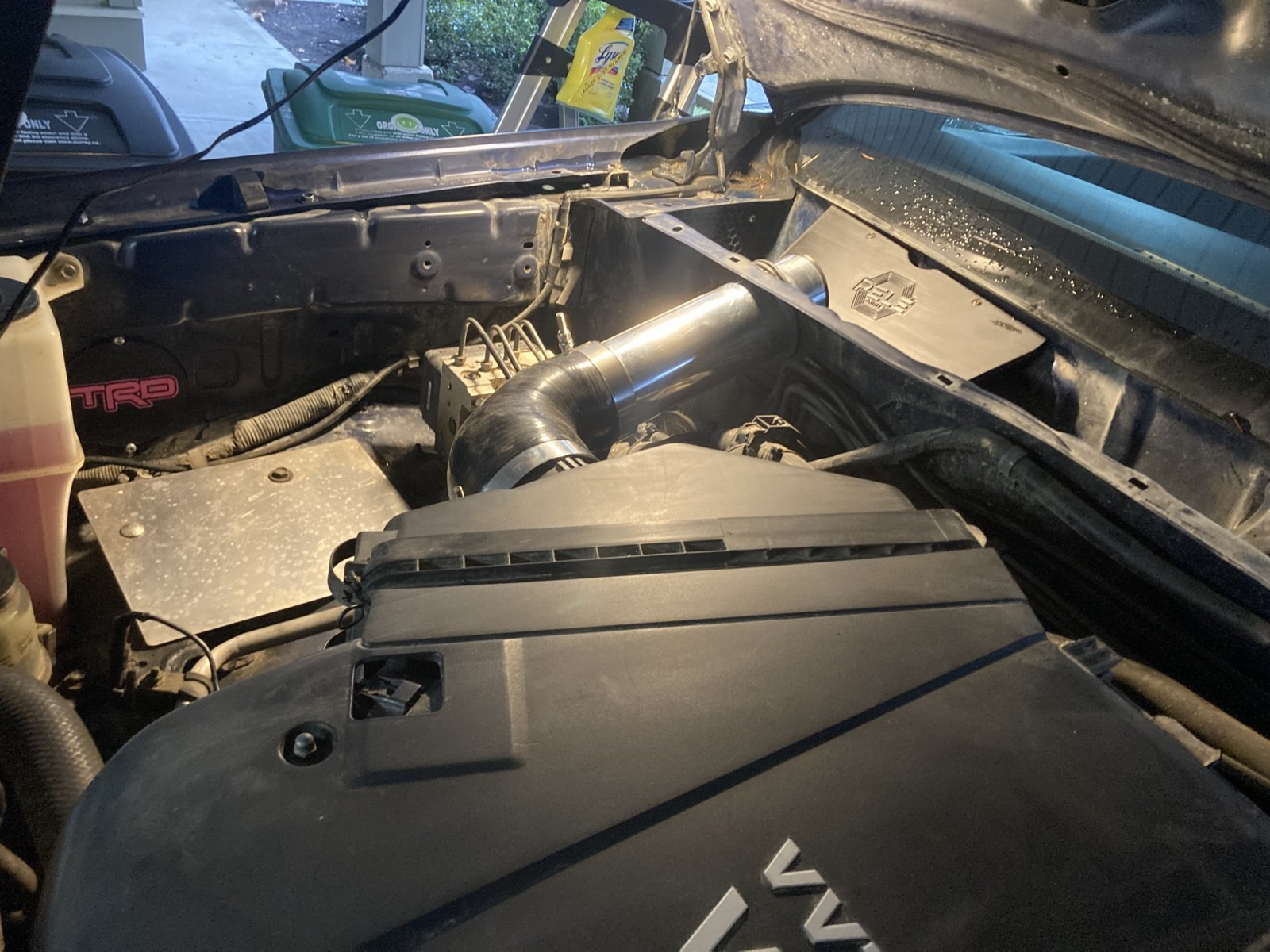

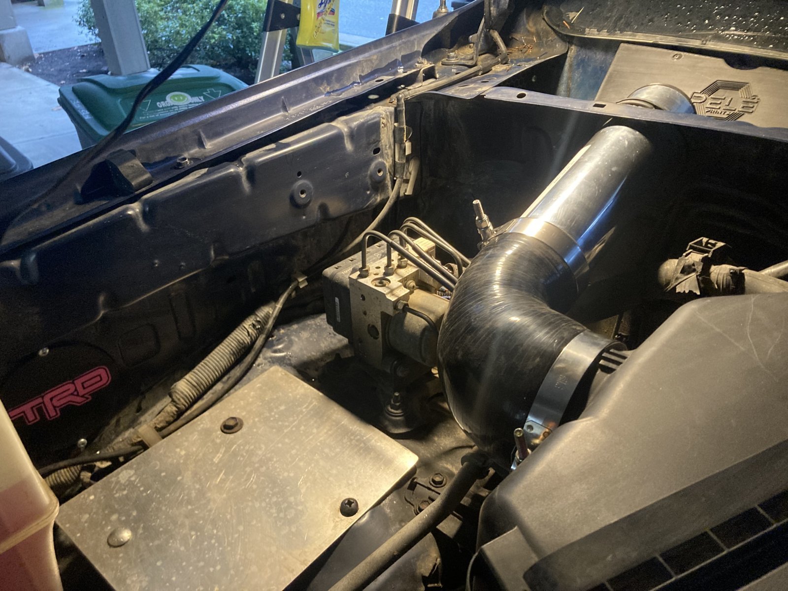

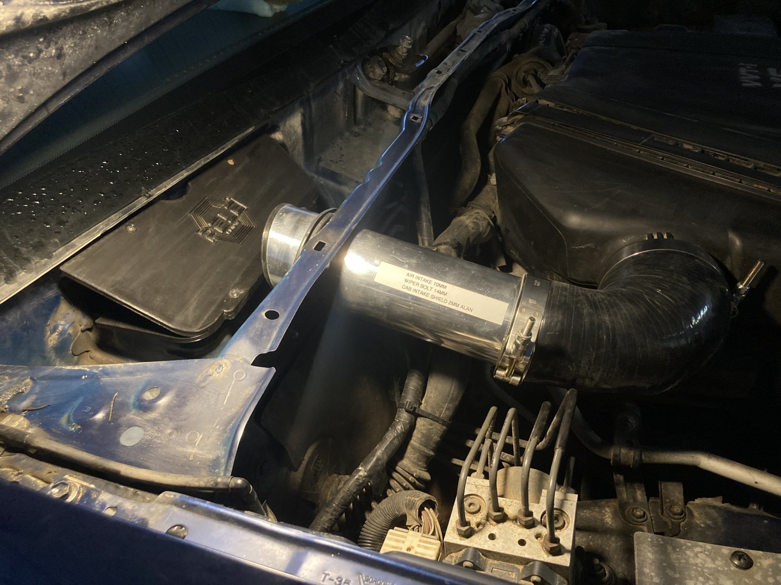

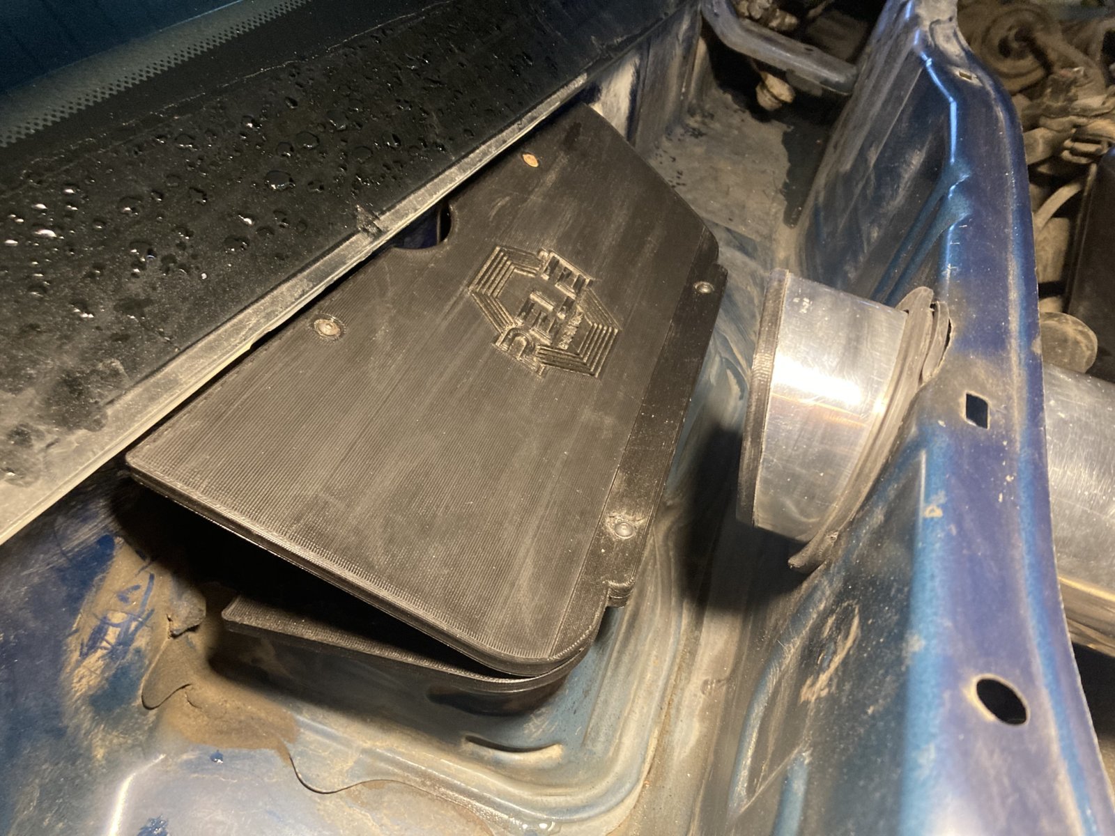

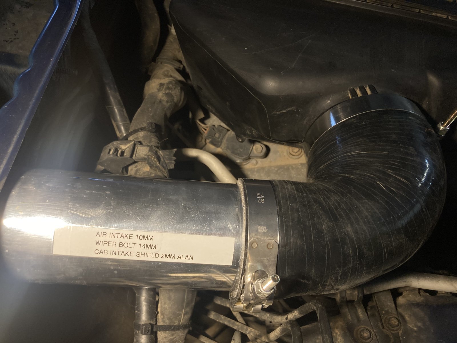

    Phew. Finally got one day off today I was finally able to completely finish the install. The got the re-designed part months ago.
    Overall, since my last post on the install it has experienced snow, heavy rain, and dust in -14c to 20c. Id have to say I’m very pleased with the product and the design.
    No FOD or liquid ingress into the cowl that would make a significant impact as compared to a snorkel or factory intake.
    10/10 Timbits.
