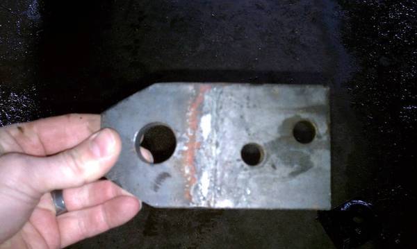

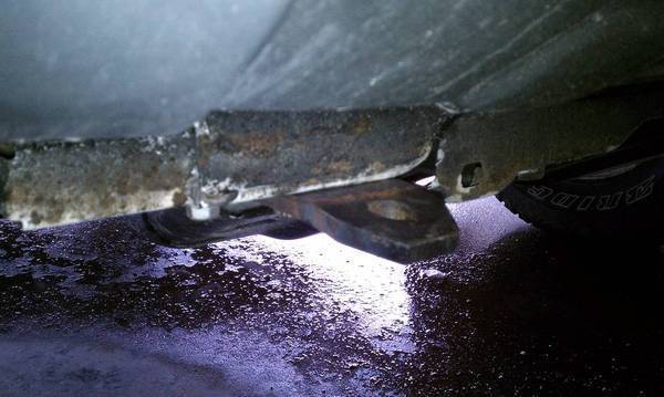

    I made a different version after it was mentioned that the old version could get hung up on obsticals. This new version is also 1/2" plate and is made to accept a 3/4 shackle (7/8" pin). I will have pricing info tomorrow after I get a material quote back. If you are interested let me know.

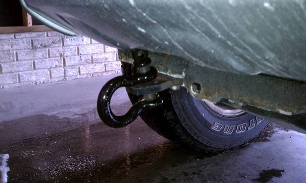

    I much like the one seen in the 1st pic above ^^ on the ground. Oh & with the bushing of course, just because in my mind that's what it should be. If a fellow gets hung up on the first model, he has more issues than just what that beefy lil' attachment point is causing.

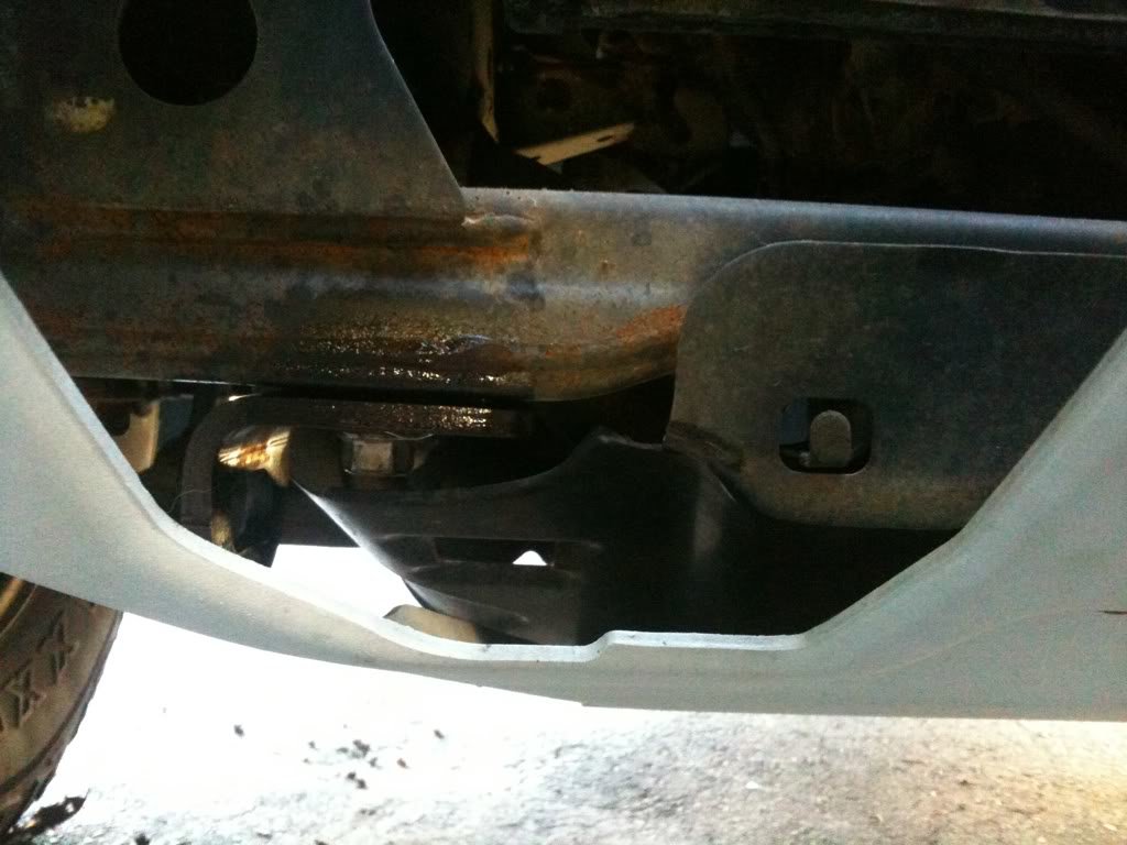

    Willy... will your 1st model bolt up with the TRD large skid plate installed?

    I agree with you 100% on your comments of the first version, it just takes longer to make and I have to drive 60 miles one way to use my dads welder. I believe the 2nd version is just as strong and I can sell them a lot cheaper. I'm not sure if either fit with the skid plate. As soon as I come up with a price I will post these in the buy sell forum.

    I used a gen 1 hook. It is a little tight with the trd skid plate but my strap fits in just fine. Let me know what you guys think.....

    If you could offset the shackle hole by angling the plate slightly toward the center of the vehicle, it should work with the optional skid at most pull angles.
    Edit:
    Playing around under my truck it looks like if you can get the shackle hole around the middle of the skid opening and about 1.5" out from the frame, shackle should sit nicely.
