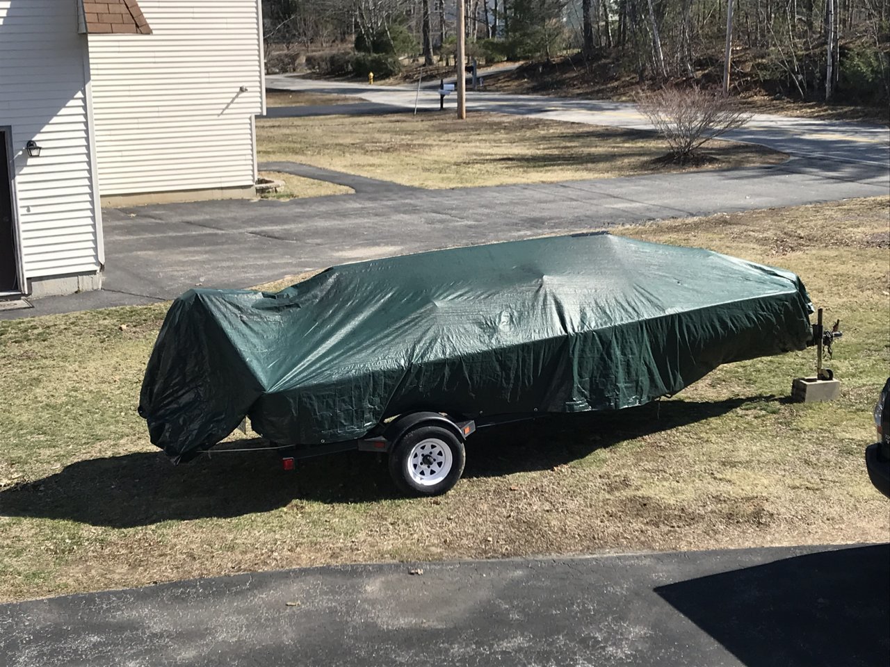

    Moving it was enough.
    Dam it’s still to cold.
    Frozen water in the garden hoses..

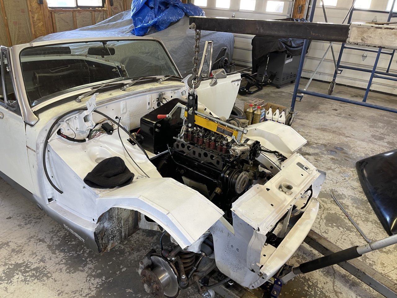

    Well, you put it in the right hole anyway..
    tee hee

    This time... if it ever kersplodes, I know where there's a turbo 2 rx7 sitting with a good engine.

    That would certainly be the hope. I also just looked at my roommate with the "right hole" comment. We had the same idea, rear engine midget with a trans axle.
