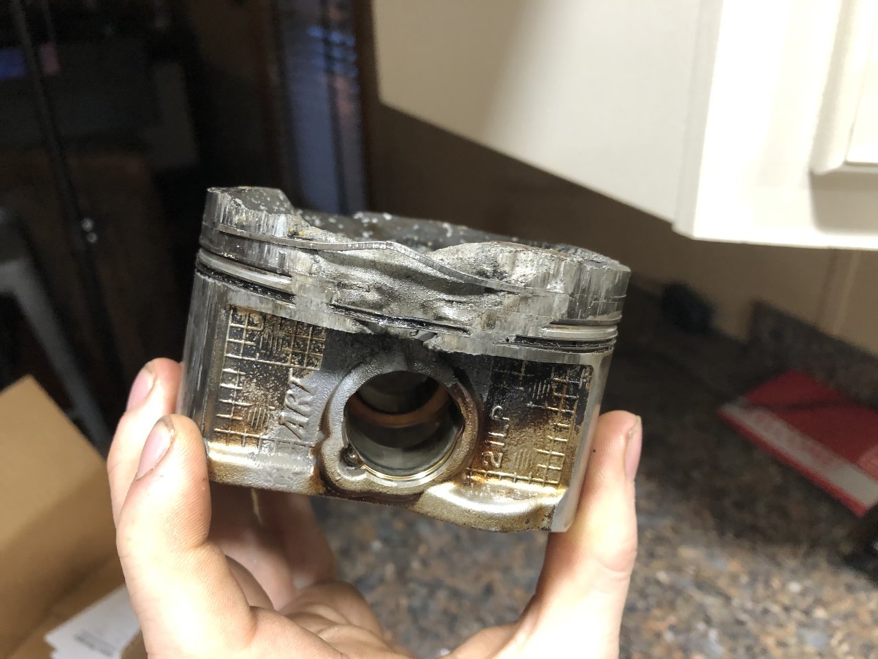

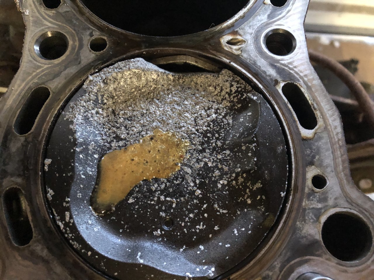

    Been awhile since posting. Life has been busy but today I got to tear down the free spare engine for my Tacoma and found out why it has zero compression in cylinder 1.... AAC1CBBE-57A9-4FC8-80D8-E69787746377.jpgCF49D2A5-4028-47F3-AAEC-272B802498A8.jpg

    That sucks!!!!!!:(
    Do you think it's rebuildable? ???? Or is the cylinder to far damaged for an overbore?

    Yikes! That would certainly give you zero compression

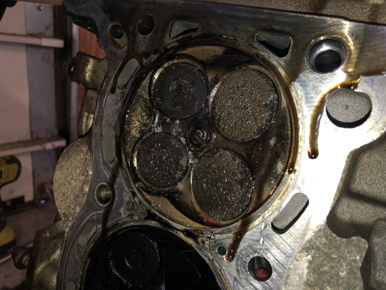

    It's definitely rebuildable. Needs pistons, hone or bore over (depends on severity of damage), bearings for the crank and rods because I'm in there, ARP studs, gaskets, idler pulleys, lifters, head/valve cleaning and re-lapping, and a set of plugs. The plan is to build it for boost... so hopefully all goes well. 0FD3058C-9D15-4C82-8692-8EA3A71B19A9.jpg
