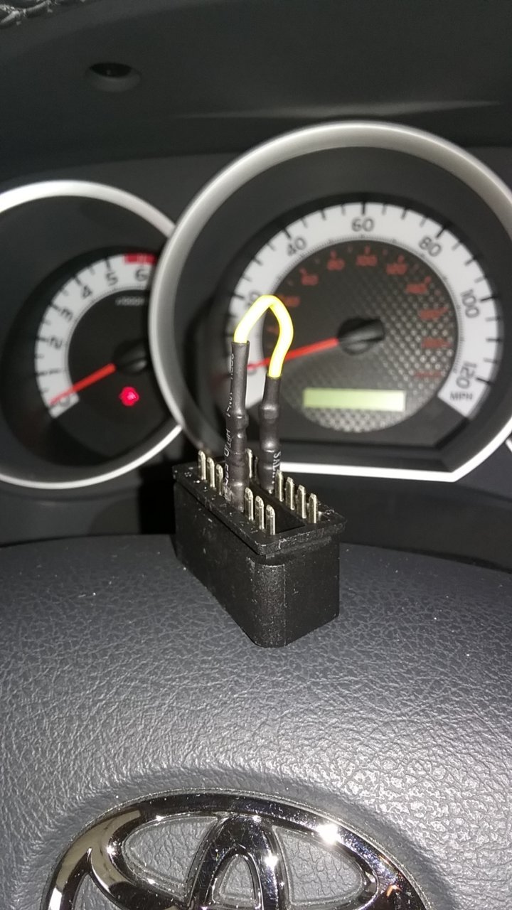

    There's a good write up around here. I'm sure you've seen it. Personally, I think it's more accurate than using a temp gun on the pan. But that's just me.
    This little cheat takes the guess work out of the wire jump method.

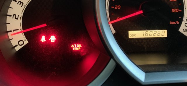

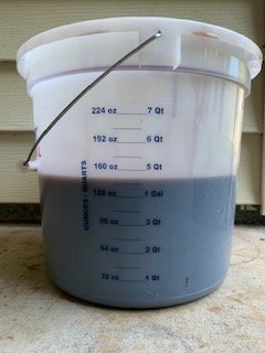

    13 DCLB TRD SP PR OTT
    "If it ain't a longbed it ain't shit! :)
    Drained 4.7ish and added 5.0 quarts of ATF. Got into the A/T OIL TEMP mode and checked overflow - 3 drops came out.
    I think its close enough to drive until I can swing by the dealership and grab another quart. (will add 1/2 and check)
    Thoughts?

    Was the engine running when you pulled the overflow?
    And you can always throw in a little bit of Valvoline Maxlife atf to top it off. It's available at Walmart
