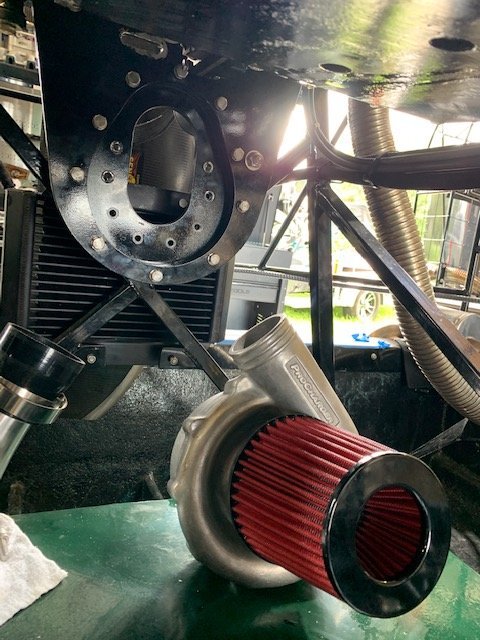

    Are you shimming the housing or the pulley?
    Since you said shims I assume the housing..

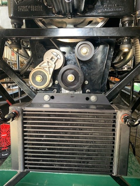

    Yes the housing! moving the procharger 1/2" toward the front of the boat. Here is a view from the rear of the boat and the pulleys involved. Once we move the procharger forward, we can mount the offset pulley and get a better alignment. The pulley has enough shank that we may have to mill it a few thousands, or trim the shims. We plan on mounting the unit with 2 shims and see where we are.

    Running a 10 rib belt.
