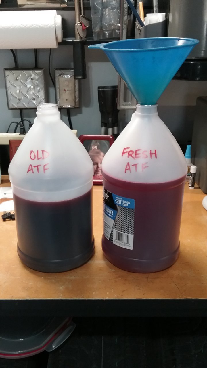

    I don't know ...probably. Some people rig up a long hose from the fill port to the engine compartment with a funnel on the end and fill from up top.
    I've always just used a cheap transfer pump and two 1 gallon jugs....one for old, one for new. That way it's easy to measure the same amount + a bit more for the last level check....as you see in the picture.

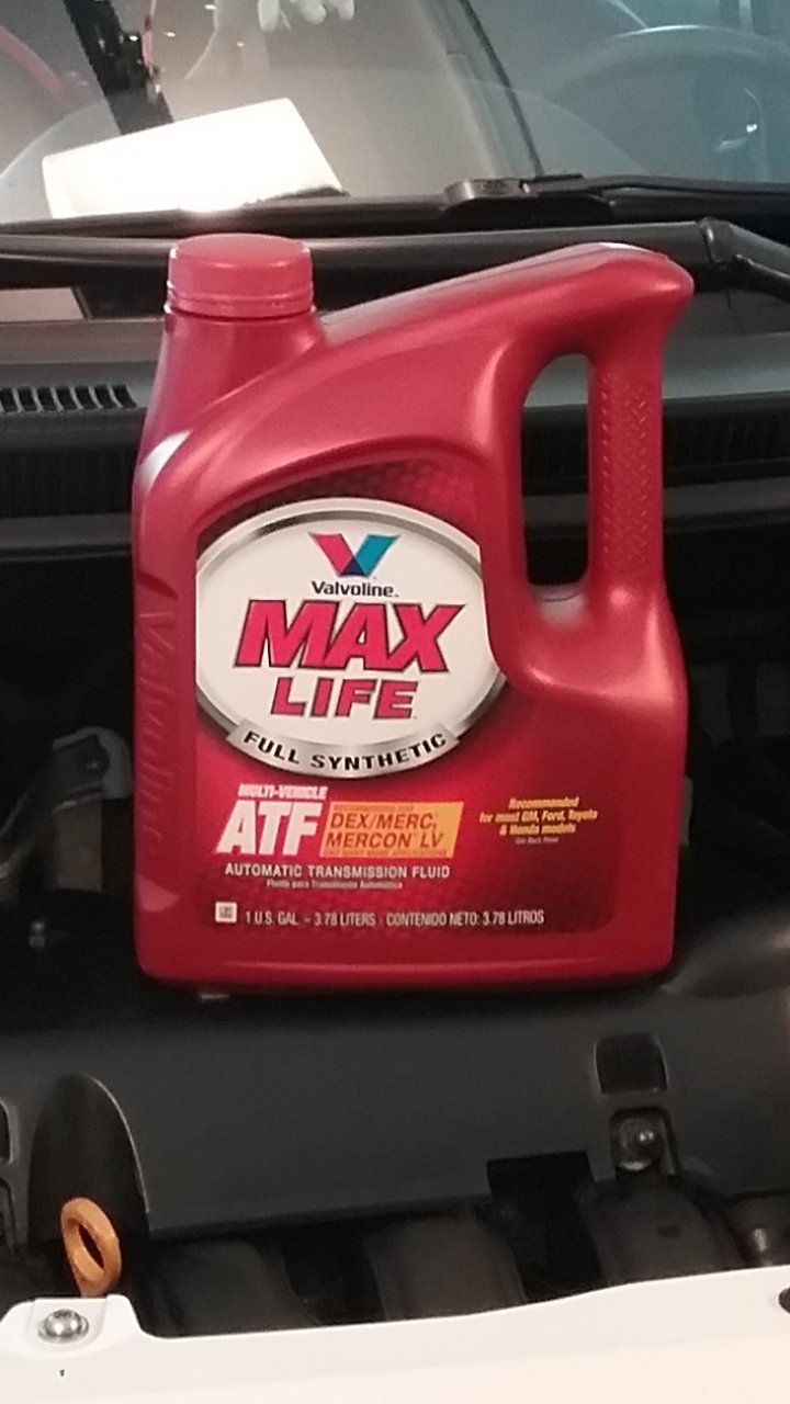

    Yes.....but I think the jugs are 4 quarts....1 gallon.

    Yea it's a little odd they come in gallon jugs instead of the 5qt's like the oil...
