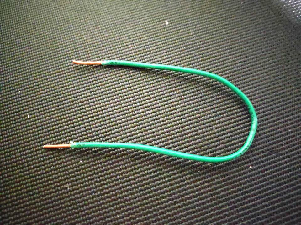

    Going to practice the transmission temp check mode process.

    It's easy. It's always 4 over from either direction.
    Pull the wire once it's in check mode. It will remain in check mode until you cycle the key off.
    And that non stranded wire you're using is best
    Sig45[QUOTED] likes this.

    Figured stranded wire would just bunch up. Found a scrap piece in the trash can at HD (in the electrical dept).

    Wire is too thick (14G). Won't fit/stay in the ports.

    Just shave it down or use stranded wire
    Plain Jane Taco likes this.

    Or make a jump wire with connectors

    What type of connector?
    I've whittled and it still won't fit it and stay.

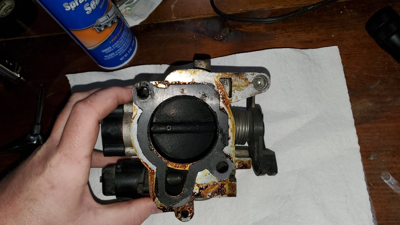

    Got er' all cleaned up!
    However, it's still a fail. :rofl:
    Had a weird slight hesitation at 2500RPM's. Still took it on an extended drive. Came home and pulled the codes and low and behold a P1294. Sure enough spraying brake cleaner around the throttle body gasket area it bubbles up a little bit and idles ever so slightly different. I noticed the mating surfaces were slightly scarred up from previous work, worst of it on the TB itself. Used some high-tack to hold the gasket on there, but apparently wasn't enough to seal the imperfections. Now I know why there was some mysterious goop all over this thing. As much as I hate to do it I'll have to grab another gasket and some good gasket maker. I bet with just the little bit of high-tack on there the gasket ain't coming off clean... :annoyed:

    I just took blade connectors and used the grinder on them for someone.
    I have a computer so I don’t need a jumper.
    on edit.
    Smash the friggin wire end and flatten it out and form a connector end..
    on edit, edit..
    be real careful with that connector.
    If you distort those connectors a techstream will have a friggin fit trying to communicate.
    Plain Jane Taco and 907rx7 like this.

    Thanks. I can pick up a couple of those 16G pin terminals. Wish there was still a Radio Shack nearby, I bet they'd have em.
