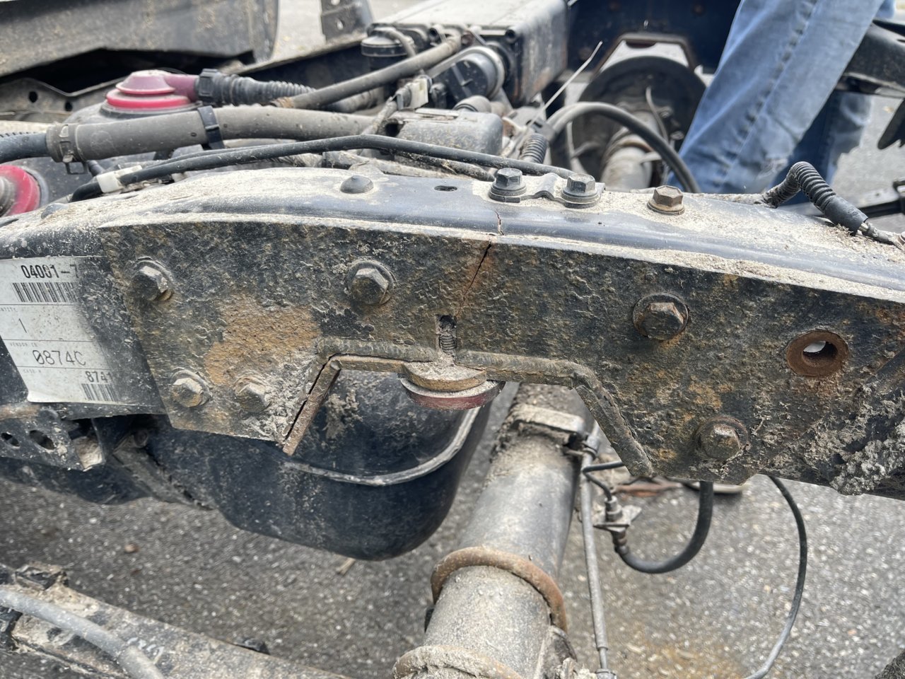

    So I started the bed removal process with the obvious, removing the six T55 bolts. Thankfully somebody prior to me put neverseize on them and they came right out. 4CD0F56C-E85E-4FEF-8C6F-A4C87490B961.jpg
    After that was completed, taillights came out and wiring was pushed back through. Not pictured, I removed the filler neck cup from the bedside. 8192206E-E185-48BC-BCC9-5C650E54471D.jpg
    After that my roommate and I ate our Wheaties, and lifted the bed off. It's a bit tricky with two people as the bed wants to tip backwards when lifting from the top of the wheel wells. (Tailgate was off for this too)2E169163-4EBE-4D69-A3F9-8D3A49196557.jpg
    With all that said and done, we got to assessing the damage. Both sides of the frame cracked, and both support plates broken in half with welds pulled apart. I will say the welds looked very cold, with practically zero penetration. 5698A554-BB37-474E-B142-54FEEC471B45.jpg799218EA-DD21-4354-90F5-5CBB5441987D.jpg DB086128-4CF8-4D7B-9049-8BAD2437DF2C.jpg1213256F-90F7-40DE-9F23-10F95B84956C.jpg CE191F30-46AD-45D2-8502-5F6D03086631.jpg
    After regrouping and analyzing, we cleaned up the frame, grooved the cracks, drilled the end of the cracks, and tig welded them closed with 308 stainless filler. 426E4EF4-742C-44F7-9E82-54BD1AA5C933.jpg44A4E87E-CC74-4FB1-BAB5-6B71426A4BD6.jpg
    After that we hit the frame with etching primer and fresh black paint. B3570D36-5508-4171-AE6D-651294578F3E.jpg12885B13-D22A-4CB6-99EB-F0691A981D2C.jpg
    Sig45, BassAckwards, Delta09 and 4 others like this.
  16. Sep 13, 2021 at 6:54 AM
    BananaMan
    BananaMan Well-Known Member
    Sep 4, 2019
    #304247
    8,273
    Bumfrick nowhere Maine
    06 2.7 RC 2wd manual "squattytruck"
    Then we ground down the reinforcement plates, and tig welded those back together as well. Hit them with the same primer and paint, then slapped it back on with new grade 8 hardware. 8A99B7BF-5BC4-4BCB-AB7D-ADCFEE5BE752.jpg419D7D1E-F3AB-4C99-A902-B8FAB115556E.jpg
    After that we tackled the wiring, which I posted the results of earlier. Here's a couple pictures of the mess, and one of where the wire was sandwiched to the frame. 3BFBC429-0D91-4AE2-A6A2-7F297EC0F634.jpg722403EB-CC86-414B-9DF4-201E8B557693.jpg 3D3EA770-0B5A-4451-93B0-2DC9517A1302.jpg
    Started this at 11:30 am, and here it is at 7 pm about to put the bed back on. I also put in an LED flasher relay to fix the hyper flash issue. And also put in the stock manually dimming rear view mirror. 4C587B02-B82D-479A-A3E8-80D6BA95567A.jpg
    Edit: I didn't get pictures but we also welded the exhaust back together and got that all installed with no leaks. (For now)
