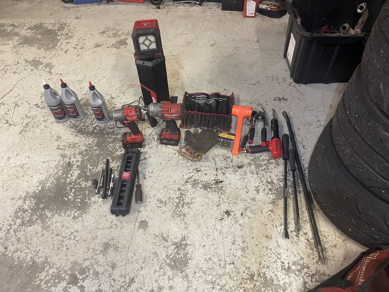

    The initial tool spread. Plus my housemates fully loaded toolbox at my disposal.745D048A-14FF-45DE-BB4C-3432D04C9D4B.jpg

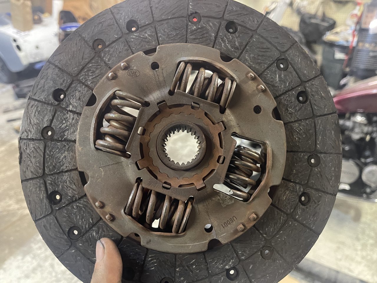

    My WiFi at the house died apparently? So I can't upload photos yet. But I'm on final reassembly now. Final diagnoses was that the truck had a LUK clutch in it and the springs broke. Hence the horrible noise. And the pieces of spring got stuck between the fingers of the pressure plate and the clutch preventing it from fully disengaging. Also the TOB looked to be original to the truck and had also failed, made bad grinding noises when rotated. New ones in and torqued to spec!
