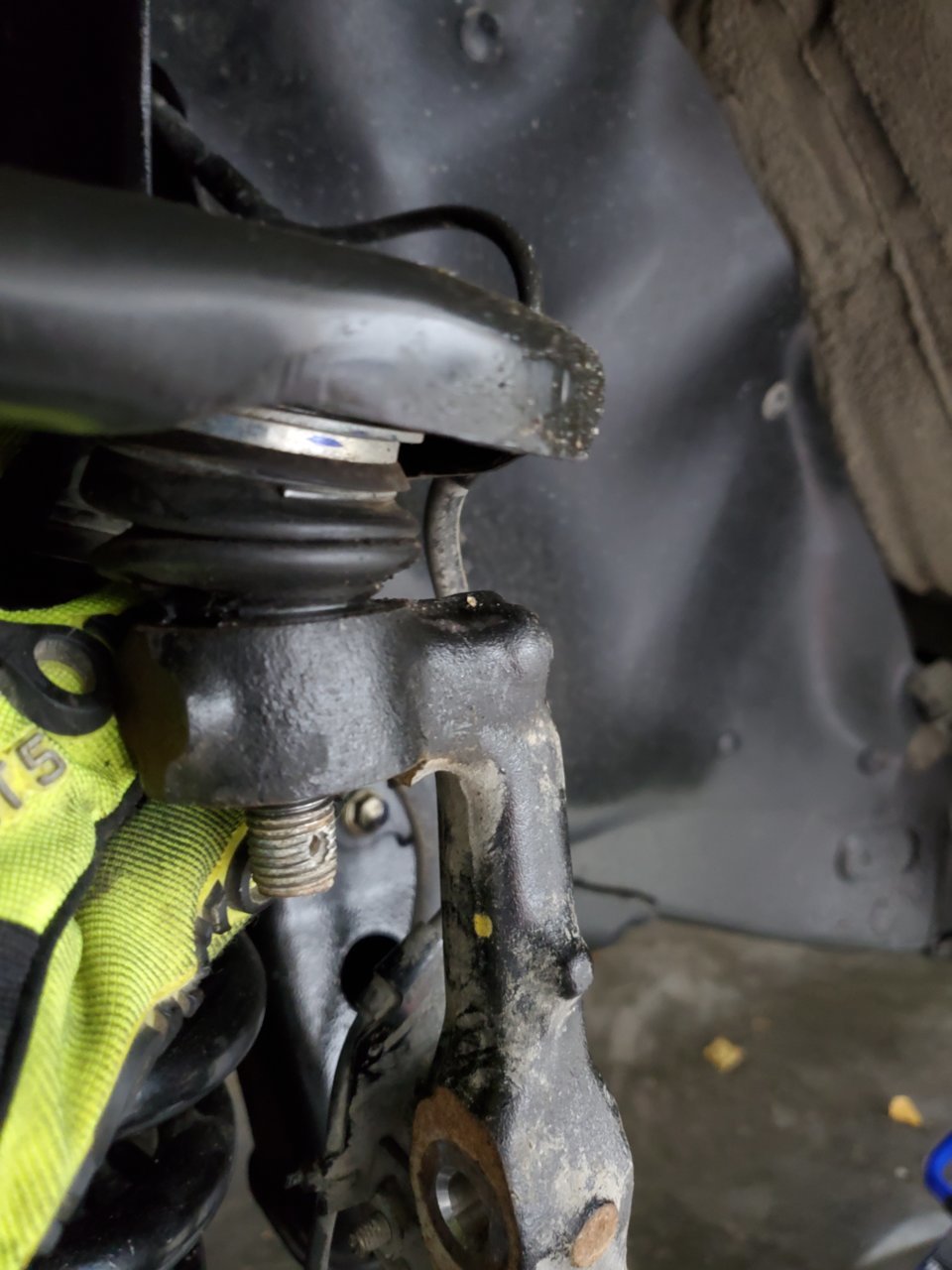

    Any tricks to get the upper ball joint to let go other than a big hammer?

    Put the nut back on 3 or 4 turns.
    Jack up the truck from lower control arm.
    Wedge some wood between frame and upper control arm.
    Put it back on the stand.
    Whack it….

    Thanks, didn't do exactly that but made me realize supporting the lower control arm was needed. After that a combination of spreader and mallet did the trick.20211011_114251.jpg

    Yea you need to create downward pressure since the strut holds the pressure and control arms are along for the ride

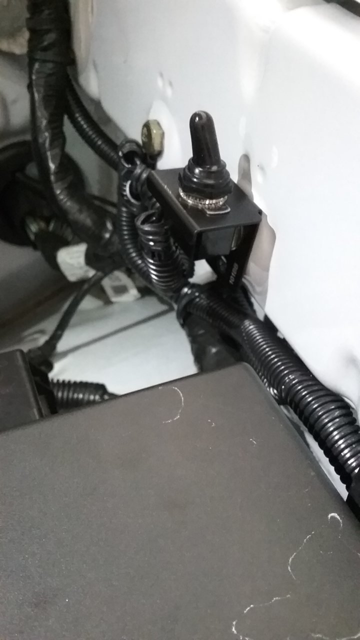

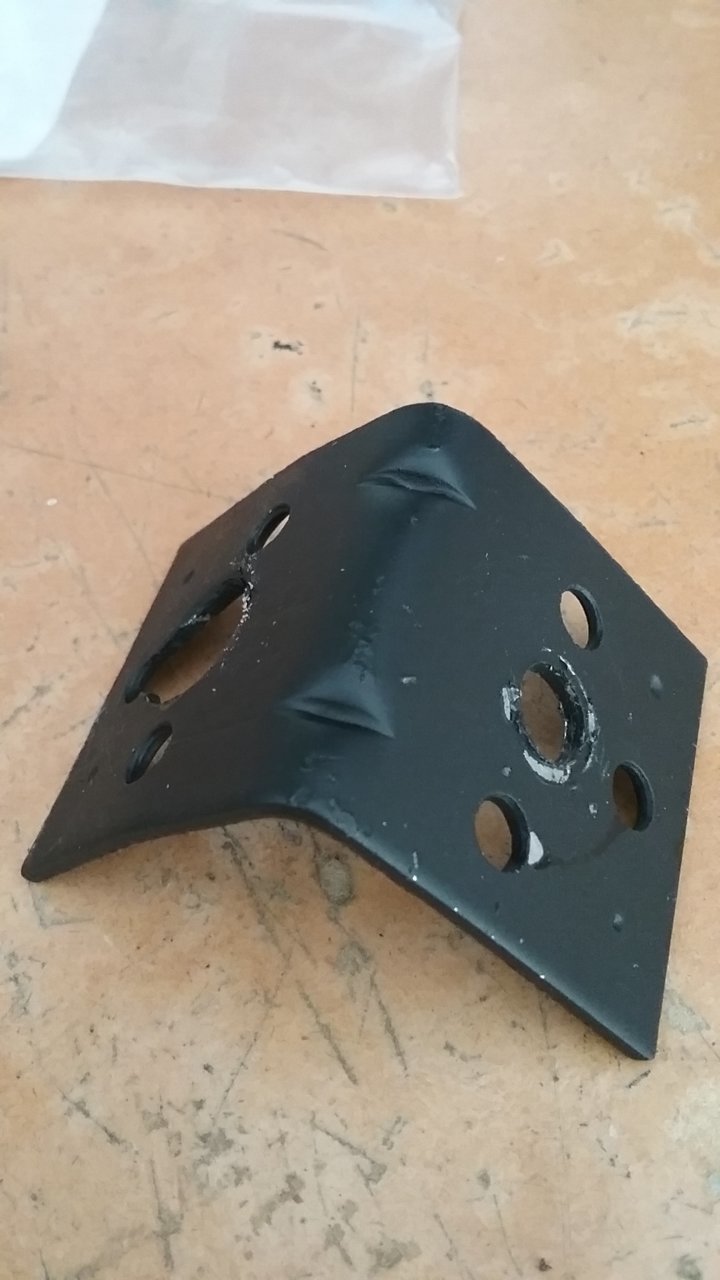

    Got my toggle switch holder in.
    Replaces my temporary homemade job.
    Underhood lighting project is officially done.
