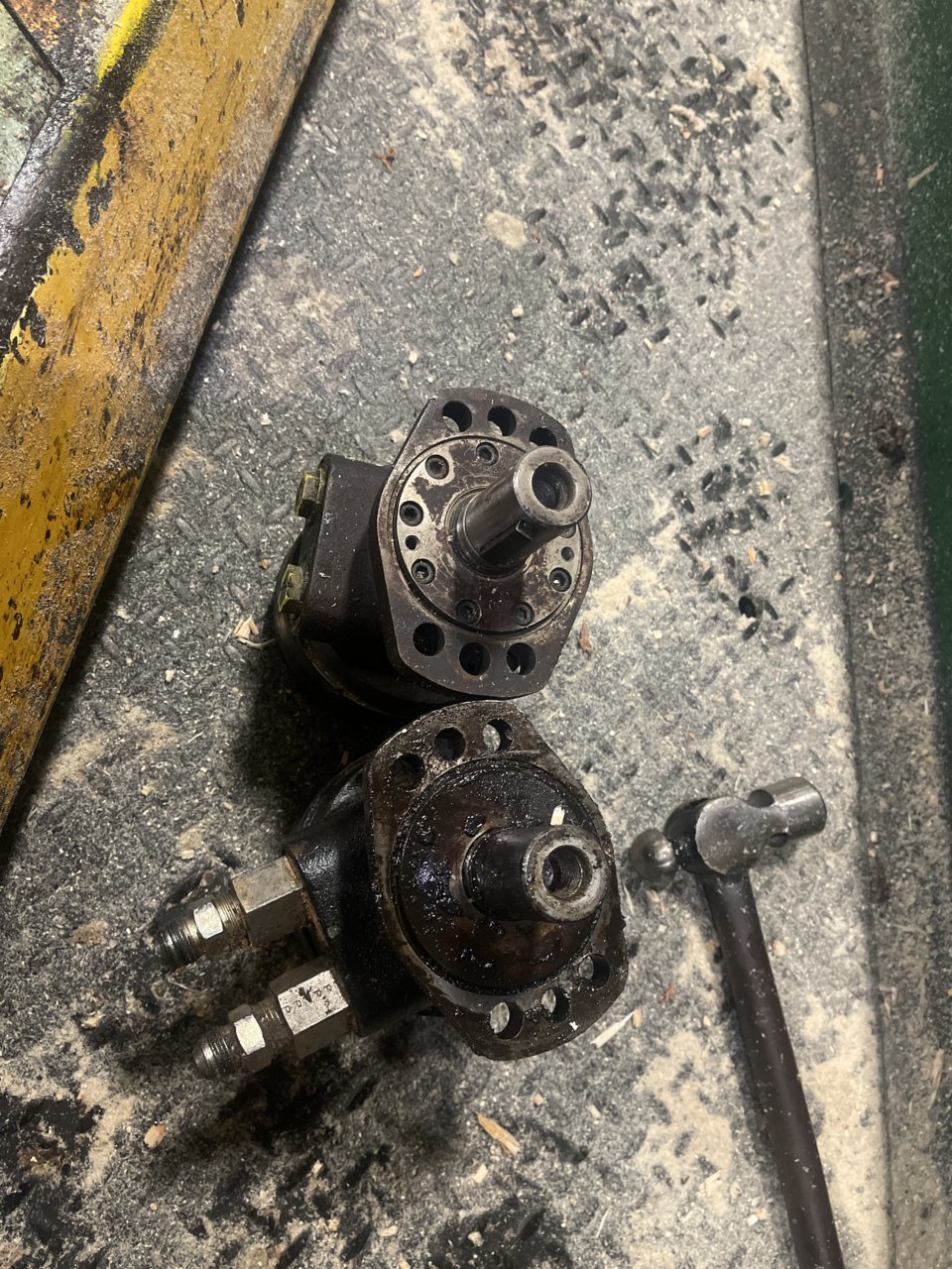

    Bearing going bad and overheating?

    Old one on the bottom, the shaft has a couple thou of play, and the shaft seal is gone. Can't turn it by hand either, so that resistance is probably why the motor got as hot as it did. Didn't help that somebody put 14-22 amp heaters in the bucket and the motor draws 9 FLA.image.jpg

    Hydraulic motor changed, one new hydraulic line, lovejoy replaced, and correct sized heaters installed. Time to call it a day. Now to drive 50 minutes home. Yayyyy
