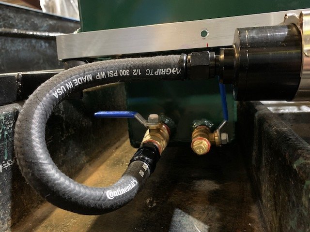

    I fired up my airboat after it sat for 8 weeks, running E85 and one of the fuel injectors was not working. I swapped it out and all was good. The mechanic stated he used Lucas in the fuel to keep the injectors lubricated and clean. Was looking for some input on a fuel additive for E85 if anyone had some experience. (yes Florida)

    E85 is a whole different ballgame.
    Myself, I would use a stabilizer, like stable 360 marine for moisture , Lucas etc, and I also would use Marvel Mystery Oil as a top cyl and injector lube. That being said I would not leave e85 sitting in tank storage.
    No no no..
    I do not know your system or tank config but if it was me a planned storage I would be draining or purging the E85 and running a purge tank quick connect assembly ( more than likely not poss.) or draining and adding a gallon or so of “e” free fuel or “e” 10 or better yet they have lead free race fuel
    you could purge the system with it. Doesn’t take much. Like 30 seconds of runtime. Even 10% up here I purge on storage with some sort of ethanol free fuel…..

    Mike thanks for all the great input and I will adapt a plan to minimize the effects of E85 as suggested. I have 2 valves to drain the tank if needed. (see photo)

    Drain it, can it, and store it if you think you can do it safely.
    Throw a gal of eth free or similar with additives, run it, shut it off and walk away.

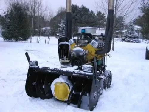

    Nobody tell Mike... I'm thinking about changing the muffler on my snowblower for more power. 1A336D75-D627-47B8-95F9-68919D817512.jpg :rolleyes:

    Just add a brace and don’t put it straight up. Might want to close the ends about 30%. :burnrubber:
