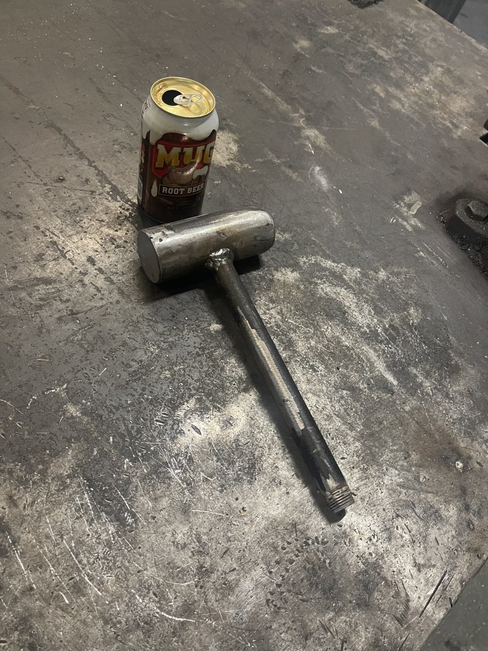

    Had a broken piece of shaft kicking around, cut off the jagged end and zapped a handle on it. New mini beater!38560F3B-DBDB-4576-8BF9-DE9C37AAC1EC.jpg

    How’s the balance when you throw it?

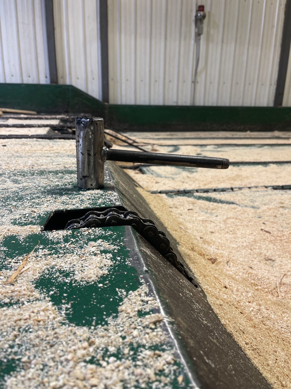

    That's the best response ever!! Saving that one... and the balance is a little head heavy :rolleyes:image.jpg

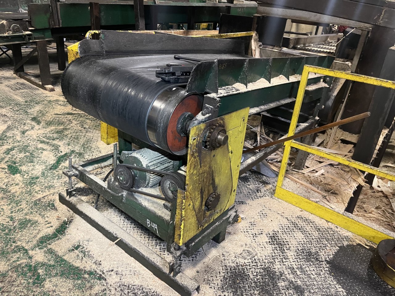

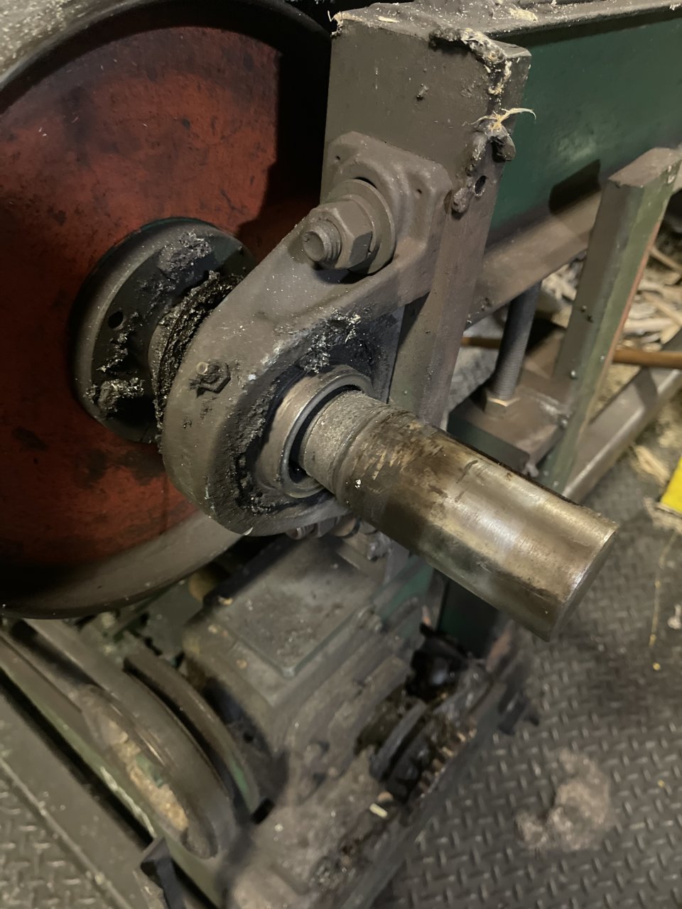

    Houston, we've got a problem! 1 15/16 shaft worn down to 1 1/2 at the bearing surface. It's also a keyed shaft so it looks like I'm going to be cutting the belt off, taking the roll out, and making a new shaft. C7C3BED1-A4E0-4029-A8DD-ECD6A9107786.jpg09B85FE0-D6FE-45BB-ADA2-D87642A9E73B.jpg FB1F2AE0-8CEF-4FCC-A083-8316EE76947F.jpg

    WTF ruin a perfectly good belt?

    Yikes. That bearing must have turned to dust

    Not ruining it. Cutting right at the lacing, then re-lacing it back together once I have the roll in.
