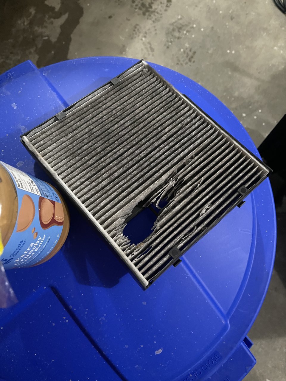

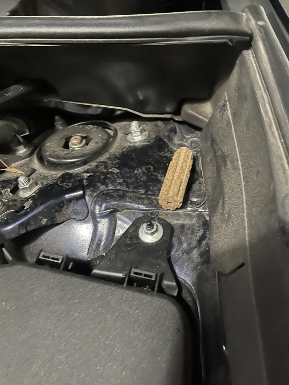

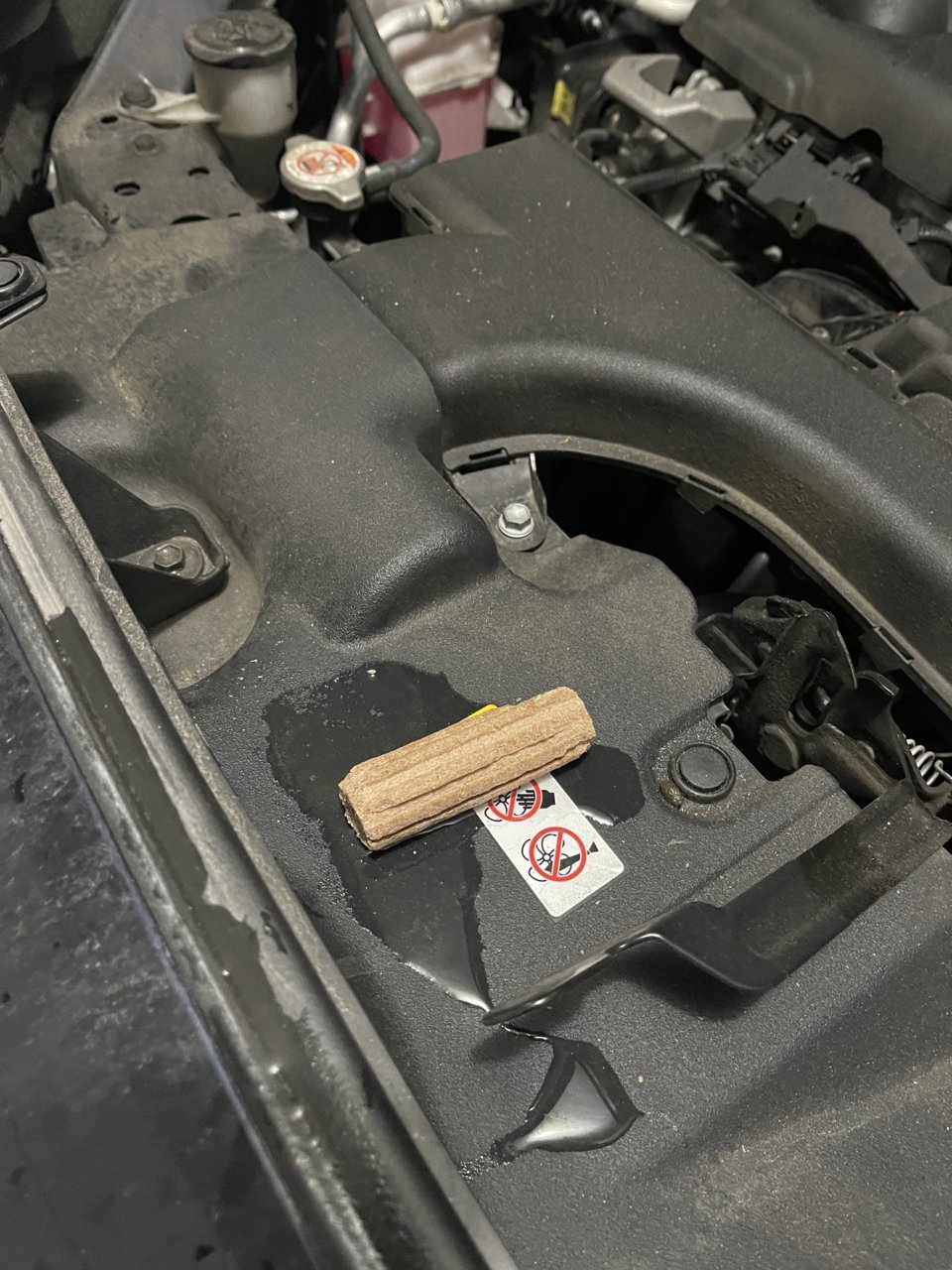

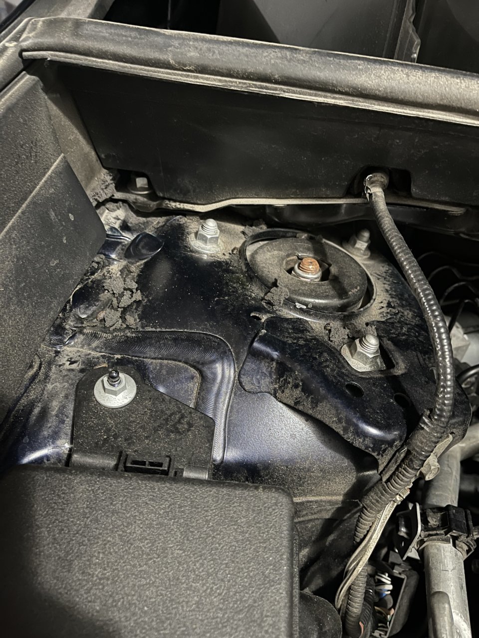

    Well- so much for tacos. Went to put some fresh windshield washer fluid in my fiancé's Rav and found this. D9B06828-9CDE-47E7-96C4-128D1198ED90.jpg 64E32959-9423-4DA1-9CFD-F3EB9EF0CF9D.jpg 95AA3C6C-00A9-4647-8371-529F559D2F7A.jpg
    So I did some more digging- little bastards went right through the cabin air filter!

    That's for the mouse traps I'm setting in the garage/basement in case they're lingering. Doesn't look like they made it past the blower fan, so they're not likely to be in the interior of the car.

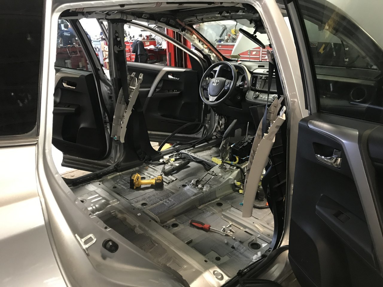

    Kick panels
    Center console
    Pull pinch weld down and pull down headliner edge about an inch or so and look inside with a flash light on all doors. Any discolorations means pee.
    Any signs at all you going to have a complete interior removal..
