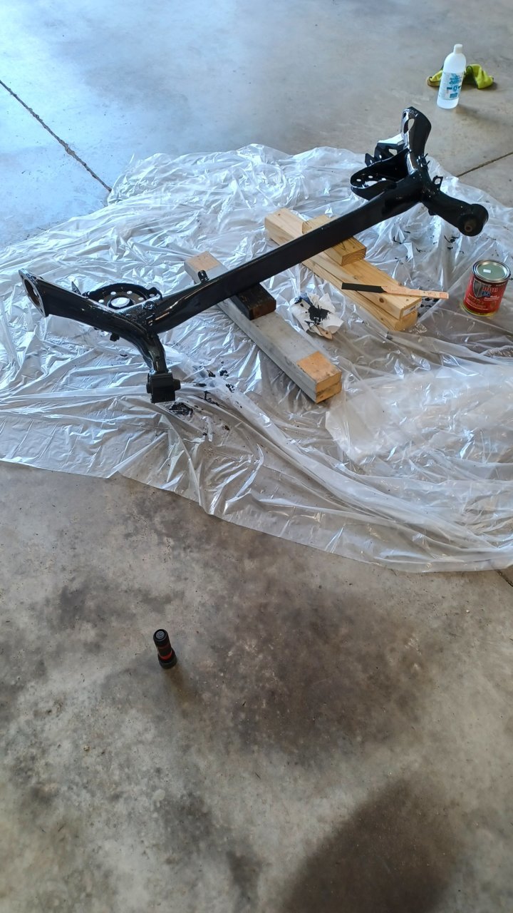

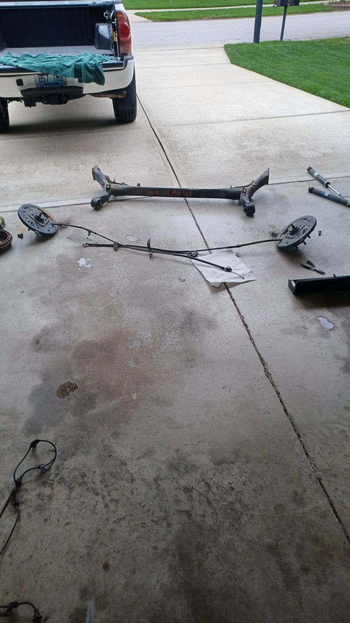

    Nope. Spent it's whole life in Central KY. It's a subpar design that seems to allow dirt and moisture to build up inside the trailing arms that eventually rots out the welds from the inside where the arm and beam come together.
    We get just enough winter, that over the course of 12 years with salt and brine took it's toll.
    I degreased and washed it down, inside and out and have applied the 1st coat of POR15 to all the welds and even down inside the arms as far as I could reach. Once the POR sets up I will flood the inside of the arms with Liquid Wrench rust inhibitor.
    Watch till the end.

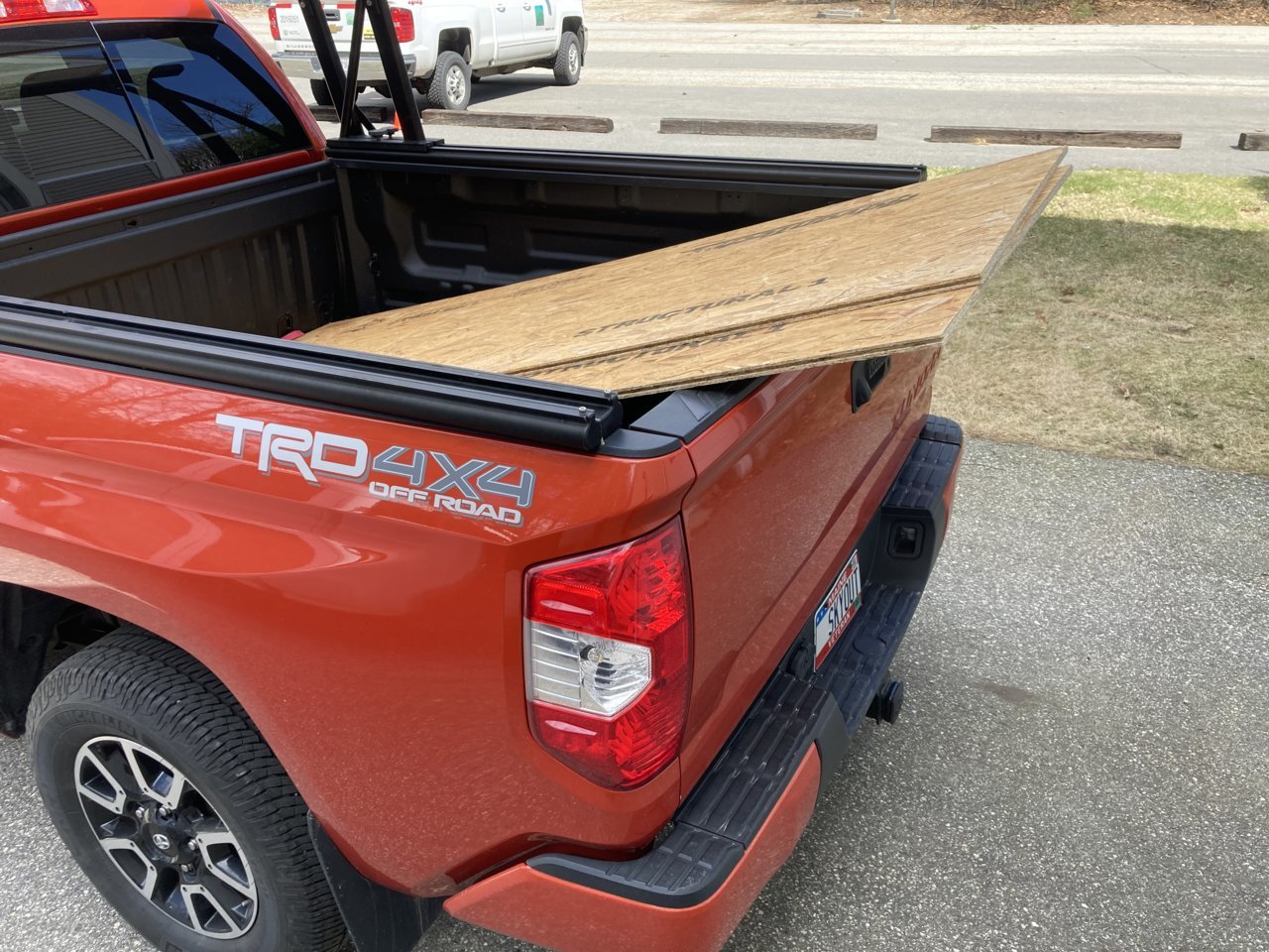

    Parading two sheets of advantech around flaunting my wealth.. :rofl:
  15. Apr 22, 2022 at 10:58 AM
    Tacoma Mike
    Tacoma Mike [OP] 48 Year Chrysler/Toyota/ASE/ Master Tech.RETIRED
    Aug 6, 2011
    #61230
    31,514
    Southern Maine
    Trade that for some more tractor attachments, you know what you got there… lol

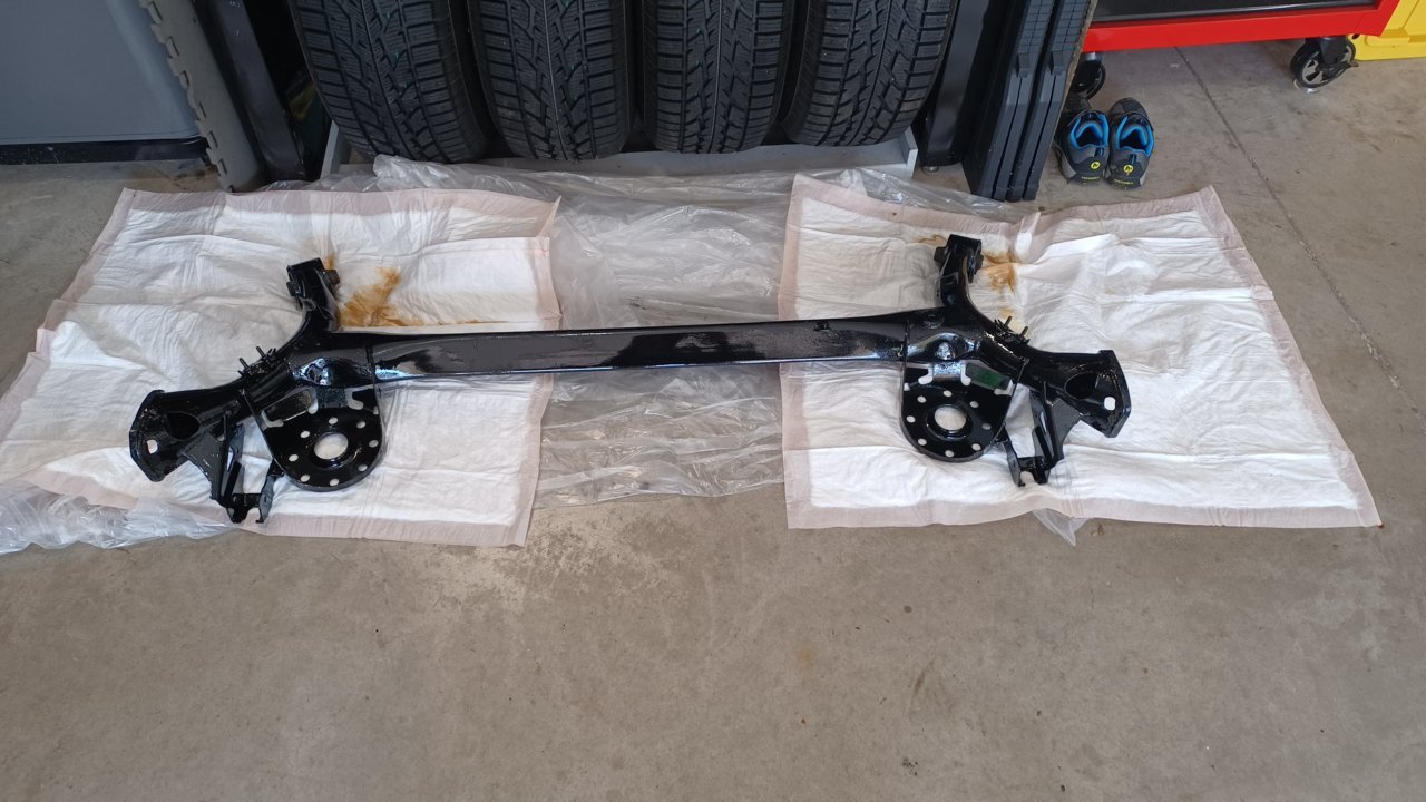

    "New" beam is prepped. 2 coats of POR15 and trailing arms flooded with rust inhibitor.
    The party commences at 9am EST.
    :fingerscrossed:

    The puppy pads are a nice tough :rofl:
