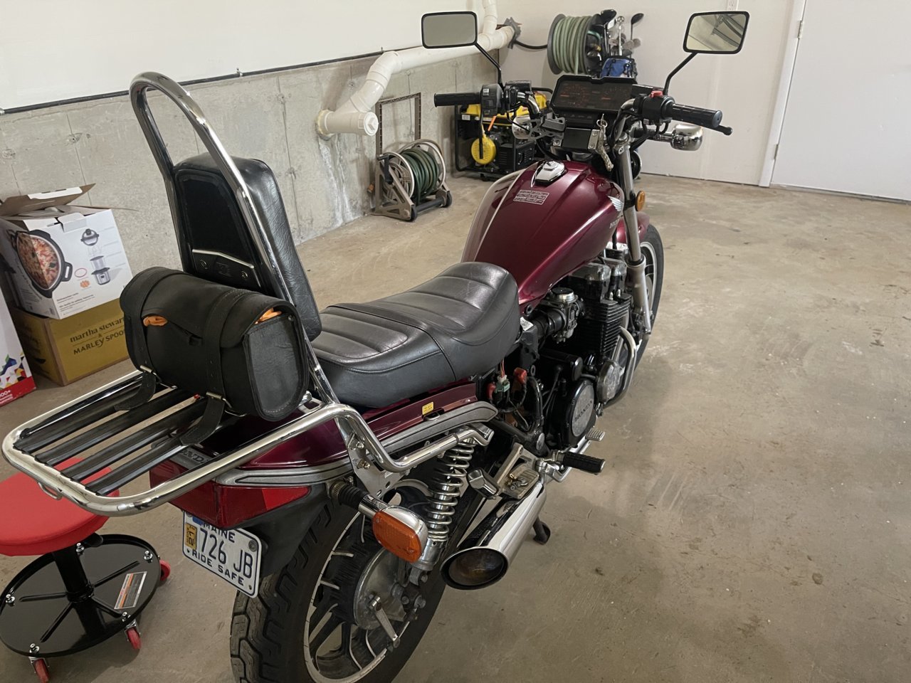

    @kidsmoke my bike lives, but I'm having an odd issue I've been trying to track down for over three years. And anyone else is welcome to chime in on thoughts/ideas for a fix. 605502AB-8200-444F-B3C6-B74B9F8DEF9C.jpg
    The issue is that in 3rd gear and up, it has a skip/misfire that completely stops the acceleration of the bike. It acts like a fuel delivery issue, but this has persisted across two separate racks of carbs, both thoroughly ultrasonic cleaned and rebuilt with all brand new factory jets and gaskets. Also confirmed all four floats are at the correct height. No modifications to the bike, original everything as far as intake/filter/exhaust/engine internals.
    I've done all the basics, plugs/wires/coils/carbs and can't figure out why it won't take any throttle in 3rd and up. First and second you can rev out no problem.

    Clutch slipping in the higher gears?
  5. Jul 10, 2022 at 10:11 AM

    If the clutch was slipping it would start revving with no increase in speed. It just hits a wall at 3-4k rpm and won't increase past that at any throttle %

    1983 Honda nighthawk cb650. I believe the only limiter is valve float? I've also replaced the cdi box with a known good one as well.

    Man. You've done everything I could suggest from my Italian only vantage point. I threw your description at my Honda pal. He's flipped over 20 CB's over the years, and shows a half dozen others. Maybe it's a thing? I'll let you know if I hear anything constructive.

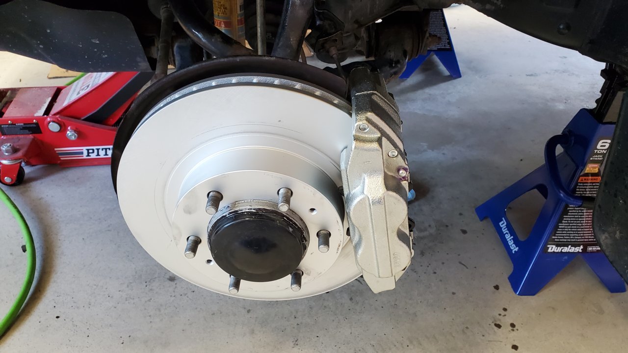

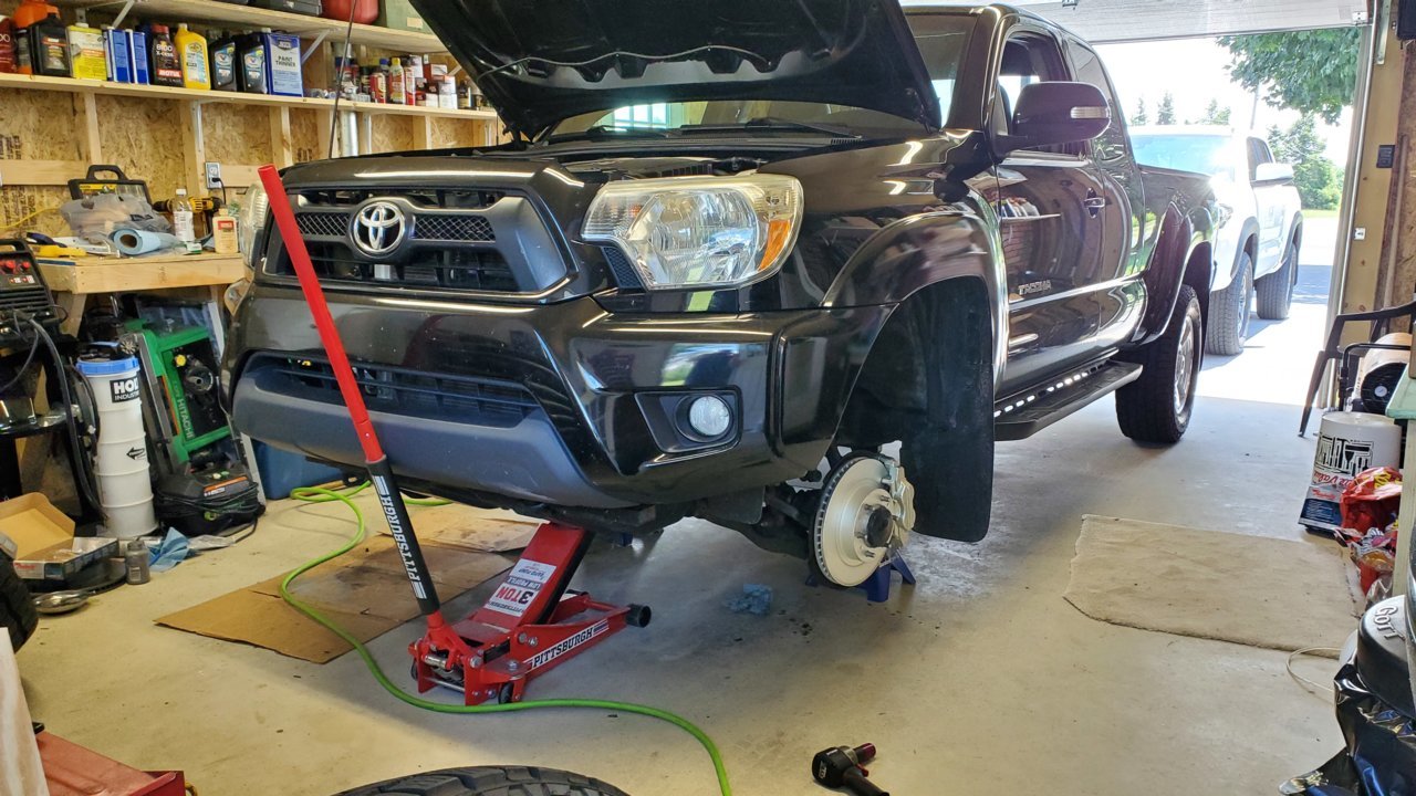

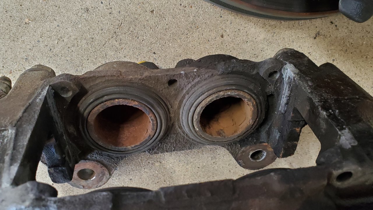

    It did take a little bit to get them fully bled, luckily mother is a seasoned brake pedal person! The drivers side caliper pistons were really corroded. Glad I spent for the good new ones, not remans.

    Started at 9pm on Friday and finished at 4pm on Sunday! Good job!
