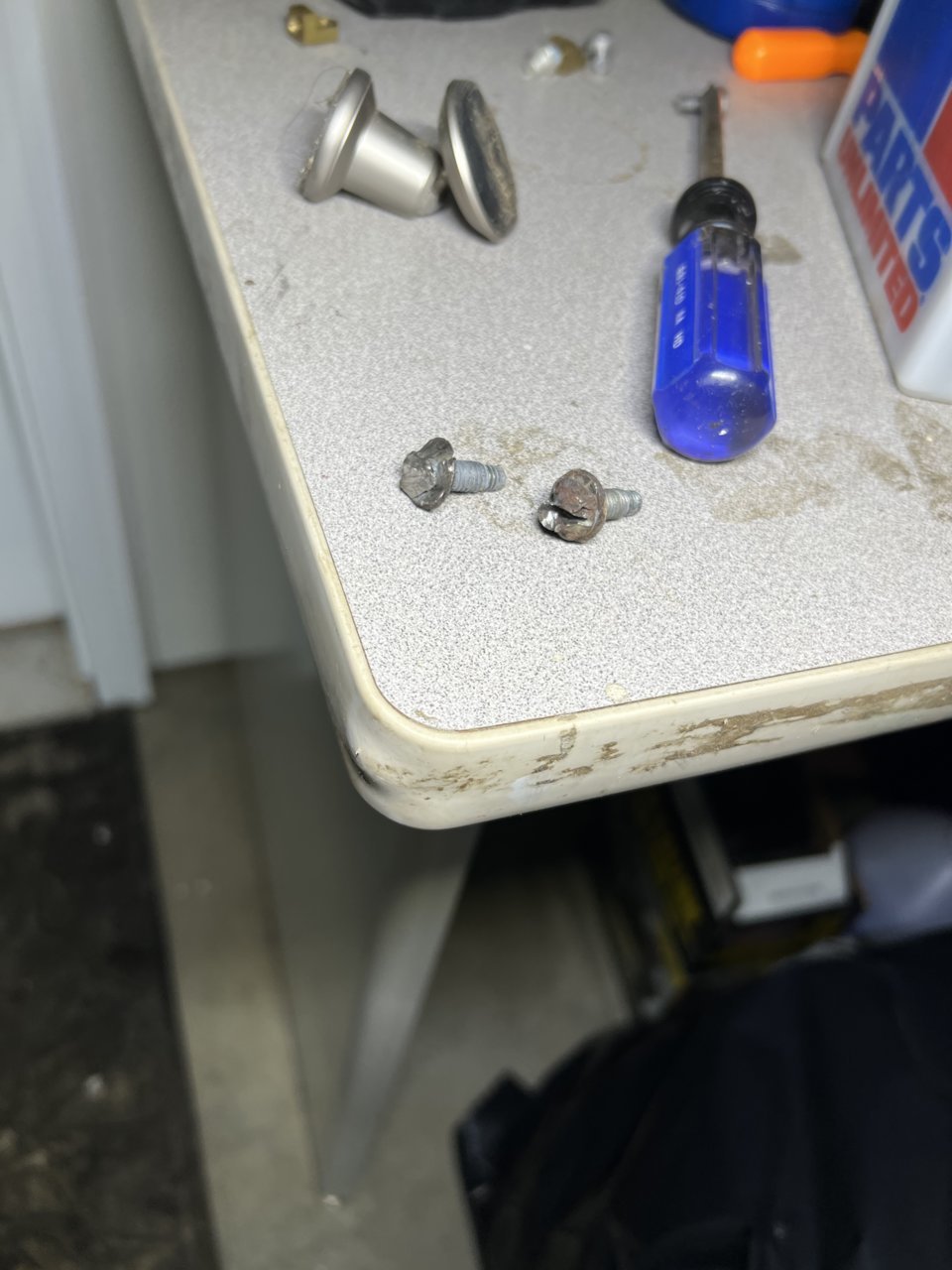

    Lower oil pan bolts are out. Well, what's left of them...

    Damn, they're not even really rusty o_O

    The pan lip around the head was packed solid scale rust. Had to chisel it away to get to them, and they certainly weren't 10mm anymore...

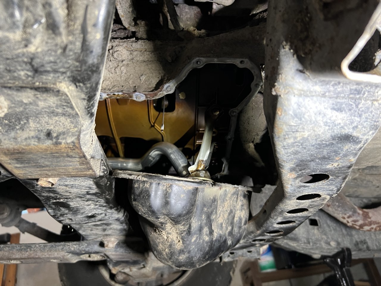

    Update: oil pan is off. Also fun fact, the lower pan does not clear the cross member and can not in fact come off the engine while in factory location.

  15. Aug 21, 2022 at 4:21 PM
    Plain Jane Taco
    Plain Jane Taco Well-Known Member
    Apr 19, 2009
    #16179
    40,279
    USA
    Lift the engine a bit?

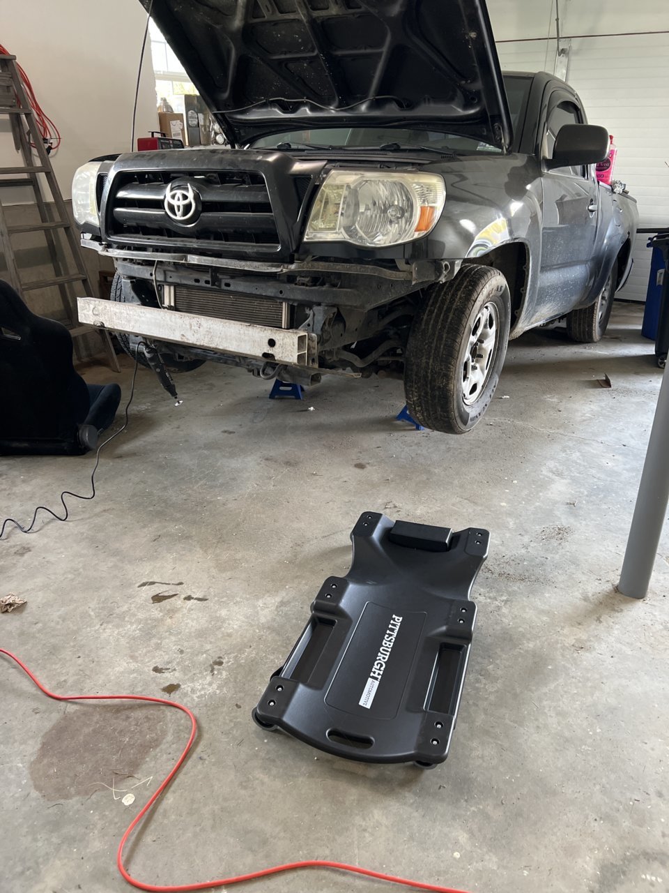

    Here's the setup. Just have to find a way to attach to the engine safely and not lift the whole truck. That's a problem for later me though. Night folks!
  19. Aug 21, 2022 at 5:13 PM
    Plain Jane Taco
    Apr 19, 2009
    #16179
    40,279
    USA
    Loosen all the mounts. There should be some threads holes up near the head to run some bolts into. The factory uses hooks there that are removed after the engine is in place
