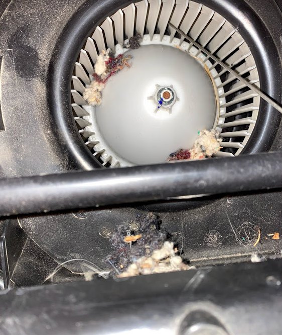

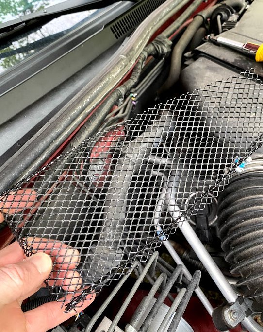

    i know my garage has a an abundance of mice. I've been lazy (hopeless) about combatting the population. that's gonna have to change. The thing is, only on the occasional moto friendly weekend does my truck not move every single day. what you don't see in the photo is the basket ball sized wad of shredded fabric that accompanied these guys. I have (had) a couple of those quilted moving blankets in the garage. a solid 15ft away from the back of my truck. The time and energy that went into bringing all of that across the garage/up the tire/suspension/firewall, under the fairing and past the intake screen (pictured) is amazing to me.
    I got in the truck Sunday morning and thought it smelled a little funky and thought I'd check the filter. It's impressive, really.

    Wow. :eek:

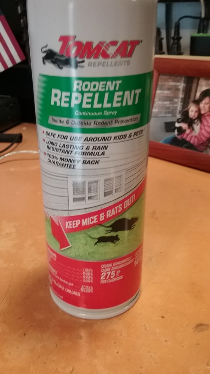

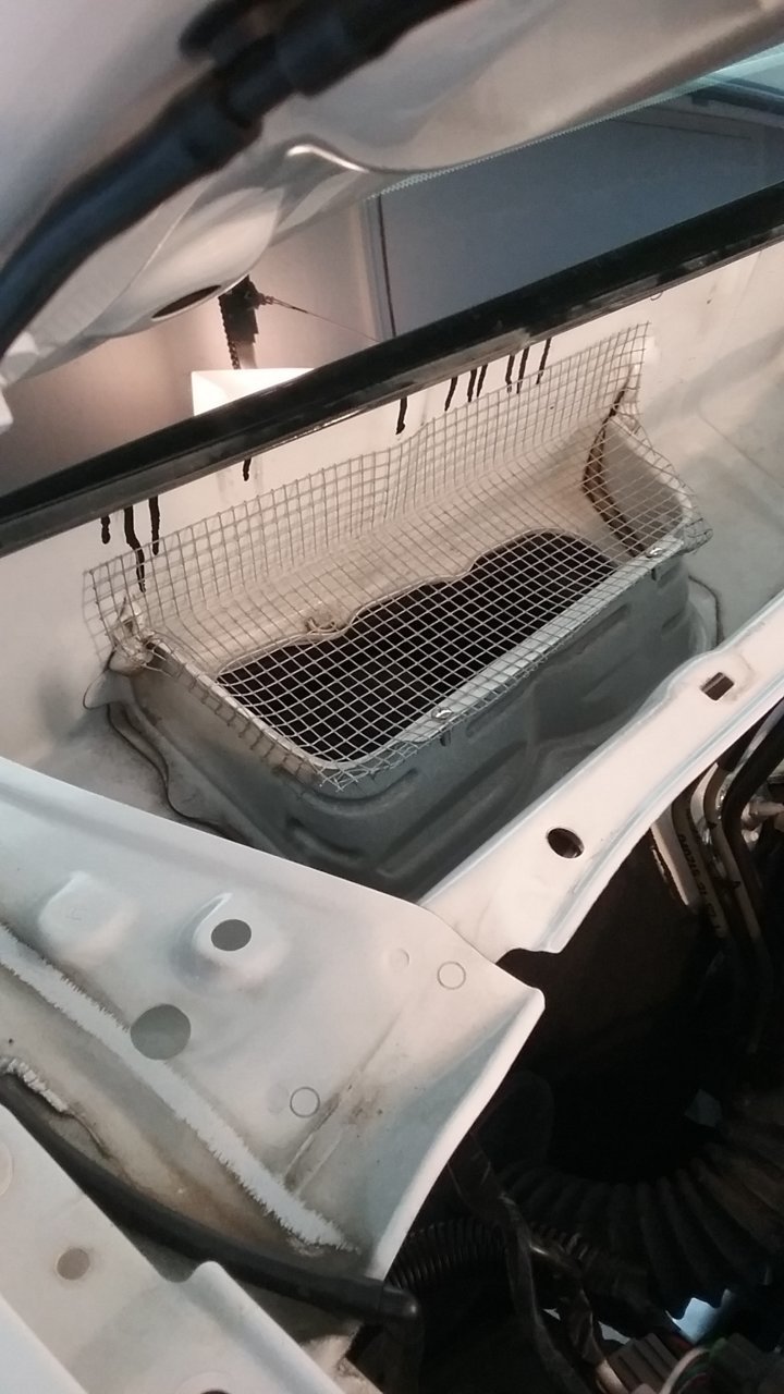

    I worry about them chewing through wiring. I have a screen over my HVAC intake too. 1/4" galvanized. I've got it molded to the shape of the hole very tightly. Hope it's enough too keep them out.
    But I also spray this stuff on my wire harnesses from the top and from below at every oil change.
    After seeing the damage they inflicted on my buddy's '16 4Runner....I try to take precautions against them.

    i had the wire mesh fairly well formed, but I was thinking about vegetation getting sucked in (maple whirlygigs, various seeds and stuff) not a thinking rodent. Where you used screws I used wire ties. Held in place but clearly, it was easily displaced.
    Great idea with the spray.

    Yeah...I used some stainless steel nuts and bolts. I clamped the screen down very tightly all along the rim of the opening. And you can see I ran up the firewall some and really formed it hard against it. I was hoping that trying to force there way down a couple of inches of tightly compressed screen would deter them.
