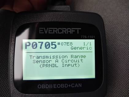

    Truck shifted funny for a moment then stalled. Started back up fine but CEL was on. Pulling the following code.
    After a quick TW search, there was a suggestion to check the IG1 fuse. Pulled the fuse and it was fine. Reinstalled it and after starting truck back up the CEL light was off. Took it for some city driving and all seems fine.
    :notsure:

    I saw transmission and momentarily freaked.

    I bet that plug for the gear indicator on the side of the transmission is full of the ol' green crusties (corrosion)...

    How would pulling the fuse clear the code?

    I think it's on the drivers side way up there, not 100% sure. I bet Mike would know for certain. Either way, you better have skinny arms and a small stomach :laugh:
    ECM fuse will clear the codes as you're taking power away from it. Just like pulling a battery cable.

    90% sure I know what wrong.
    Will happen again
