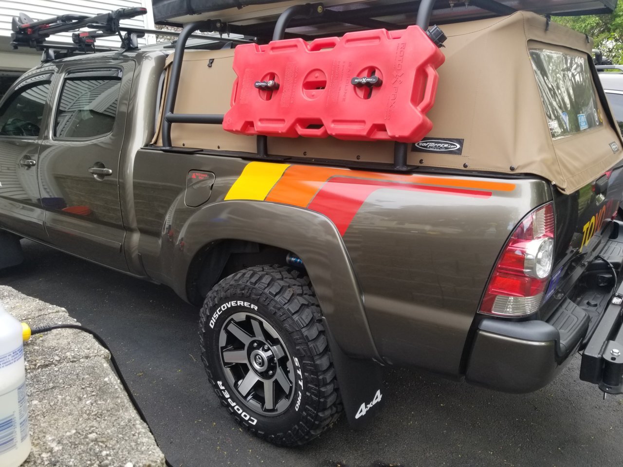

    Got one bed side in today what a bitch trimming around the fender flares.

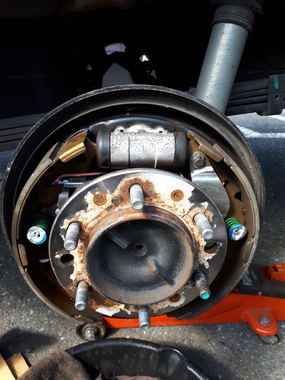

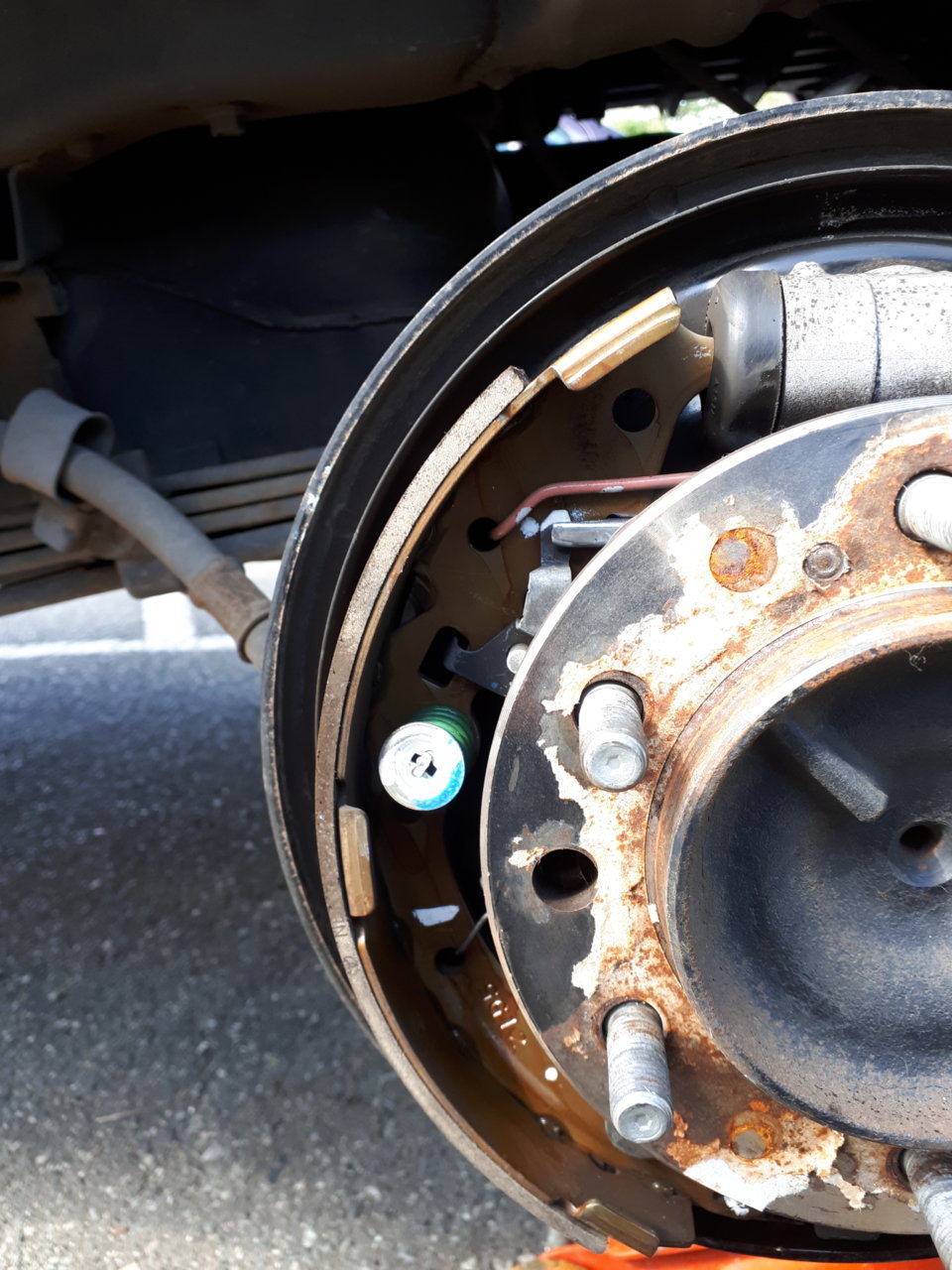

    Pulled back wheels off today to inspect rear brakes. What do you think 30% left?20200518_100750.jpg 20200518_100756.jpg
    Wouldn't have thought the rears would wear faster than the fronts. Which are at about 50%.

    They look good to me. I'd say way better than 30% easily. Clean 'em, adjust 'em and take a Q-Tip with some high temp bearing grease and dab a bit on the contact points. Call it a day.
