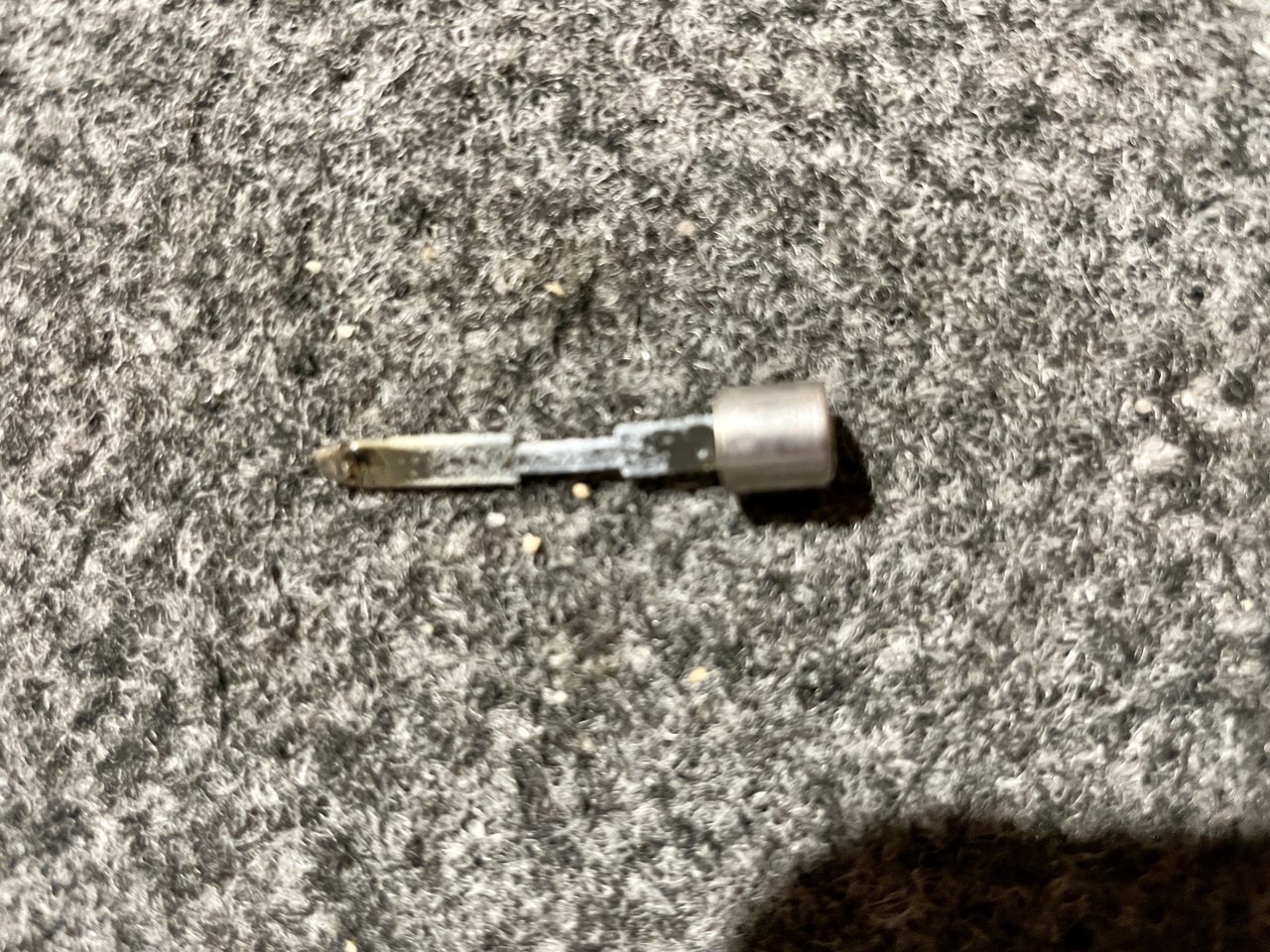

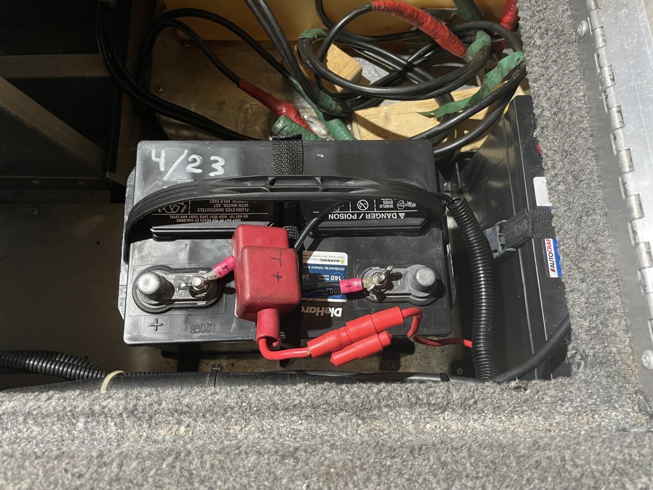

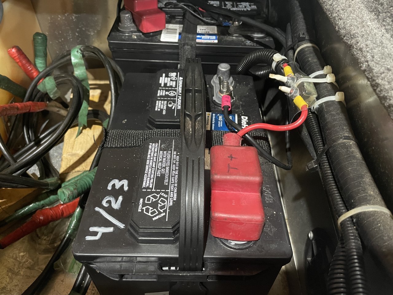

    So after a great outing yesterday, I was noticing a change in thrust in my trolling motor.
    Kinda the second time I was thinking about it.
    So I went out and ran the motor on the speed I usually run. Seemed ok. But sound was off.
    So ran it a little faster and it seemed to struggle.
    Put it on hi and poof, it quit.
    I had nothing.
    So put it on constant and went to the battery.
    Just touched the fuse holder and off it went.
    So pulled the fuse holder and the fuse fell apart in my fingers
    So it took me 15 min to get the end of the fuse out of the holder because of corrosion.
    put the spare fuse in it and off it went.
    Still didn’t sound quite right.
    so I did a voltage drop test and got a .5V volt drop from the battery to a foot beyond the fuse holder.
    Decided to cure this once and for all.
    I installed a 40amp circuit breaker.
    So we will see if I get the full power to the motor now..
    I don’t want to buy a new trolling motor this year…
    We will see
