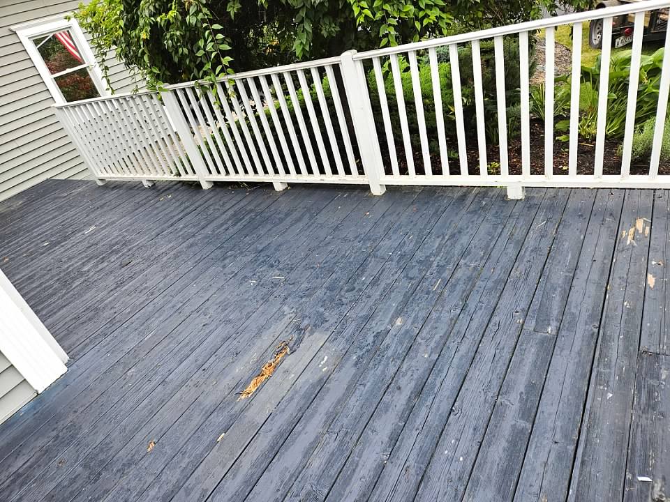

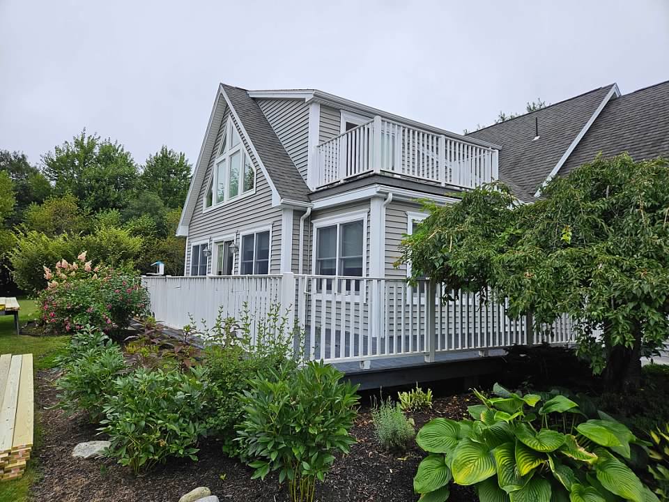

    As often is the case, my works plans changed. Found wet and rotten deck joists during demo and customer wants all new posts & railings. Current wood rail posts are 8' apart. Too far for 4x4 posts. Should be 6' max. So a nice add-on. They want that Fiberon/Synthetic product from HD. They're older so I can understand the no maintenance. At least the decking in wood (PT). So now it's basically a full deck rebuild above the framing.

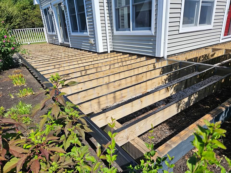

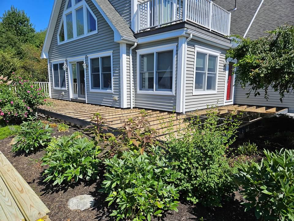

    Day 2. All decking, posts and railings removed on the lower deck (41' x 28'). 2 joists replaced. Demo officially done. And got joist tape on the areas that had a chance to dry out. 1 railings section left, that has a gas line attached. I'm not touching that. Homeowner will take care of it. Railing post layout and installation is next. Old decking was cedar and only 15 yrs old. Never seen so much rot. Not sure what happened.
