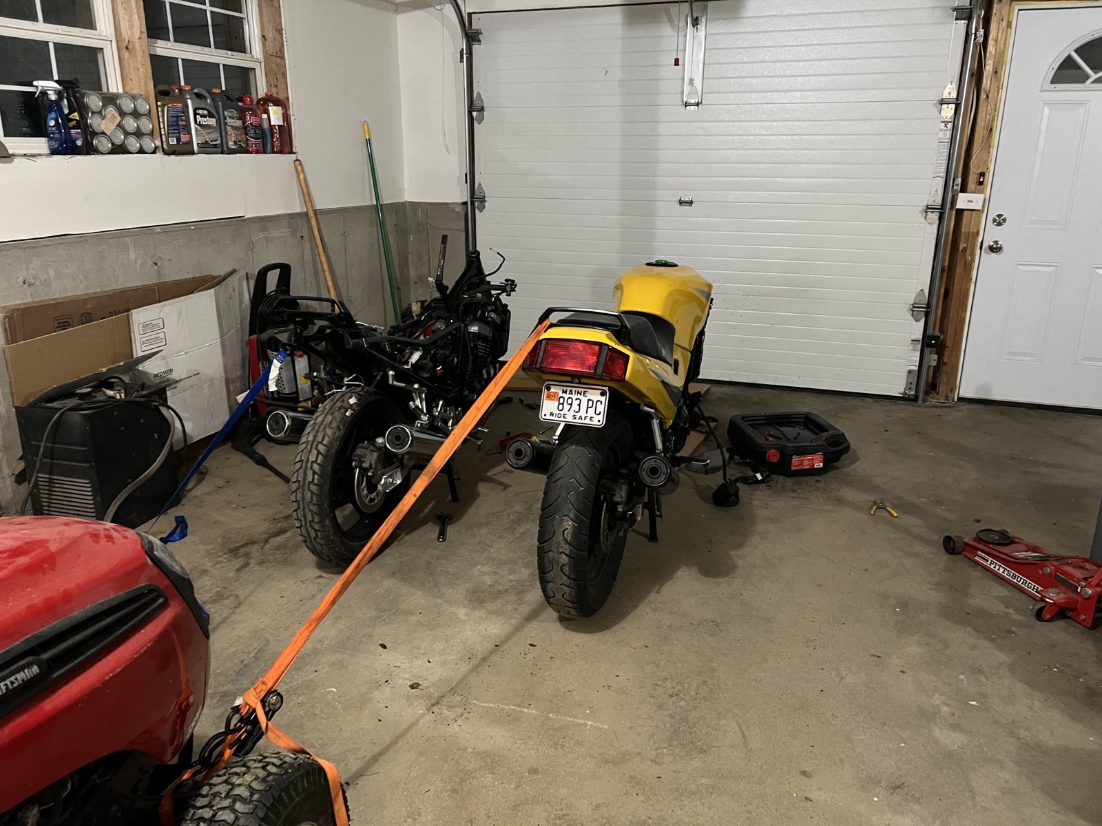

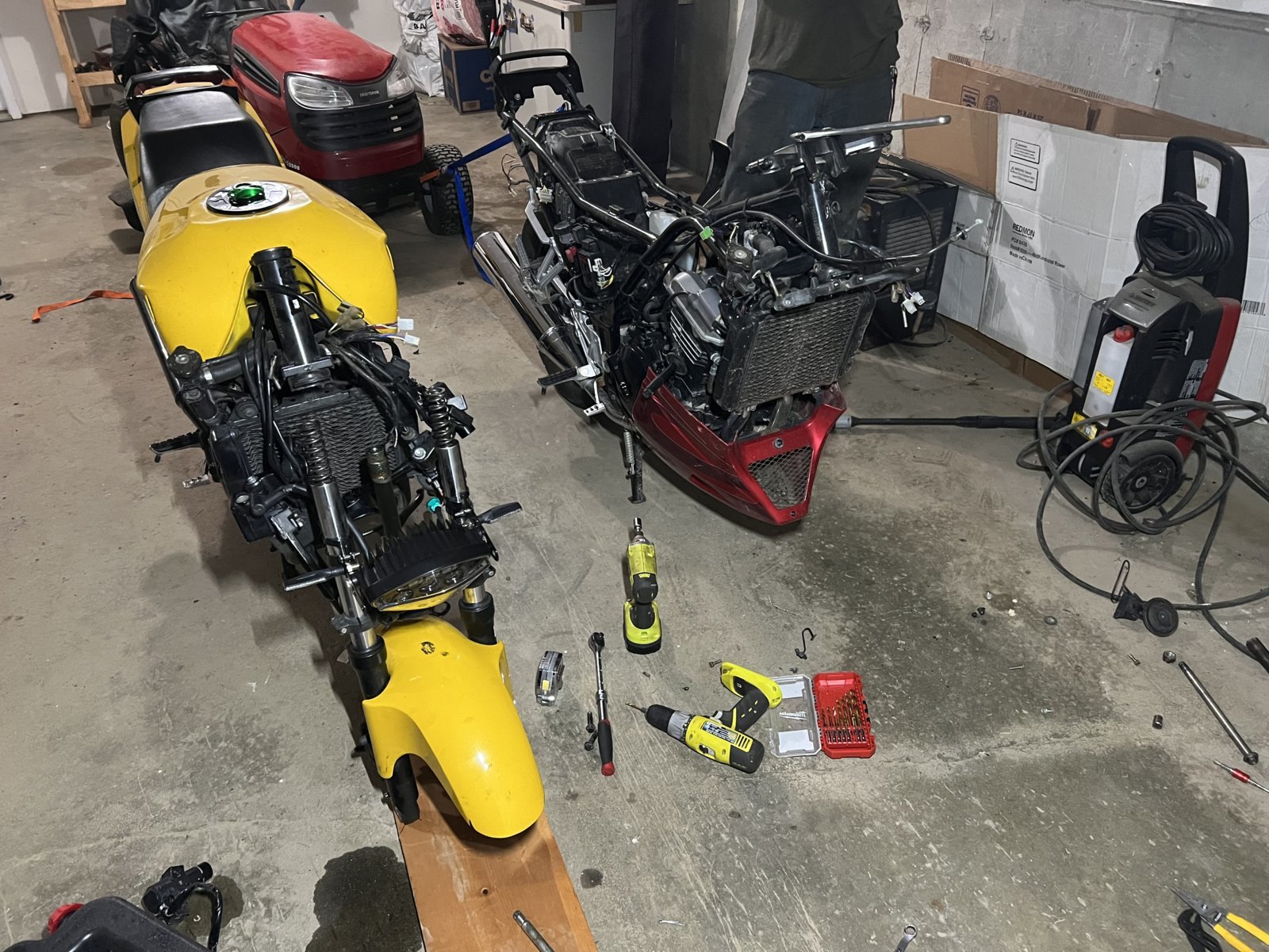

    Unfortunately it didn't come by it honestly, either somebody worked on it before not knowing what they were doing, or this bike has a more sordid past than we knew. The triple tree bolt had backed off, the fork pinch bolts weren't tight, and the most damning is the spanner nut on top of the head was hand tight. Another red flag was when we took the forks down, the upper plug in the fork tube is supposed to be retained by an internal snap ring. Both were missing and the plugs just came shooting out of the forks. Fortunately I had recently bought that second ninja 250 which is identical to his, so we're doing a front end swap.
    I don't have a bike Jack or lift table, so to keep the front ends up while we took them apart, we pulled the riding mower up and strapped them to the front end to hold them in place. Works surprisingly well.
