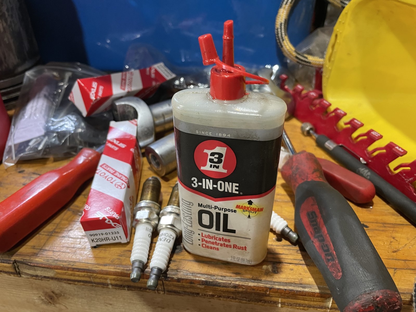

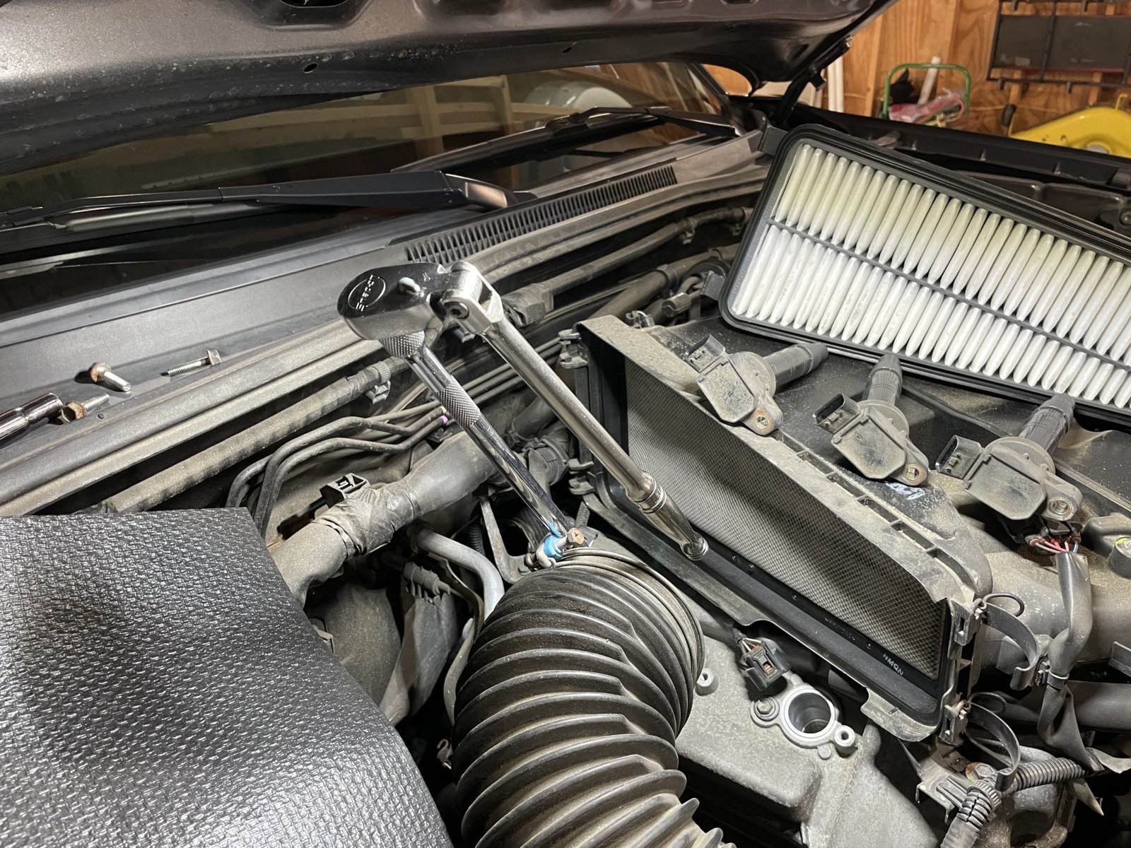

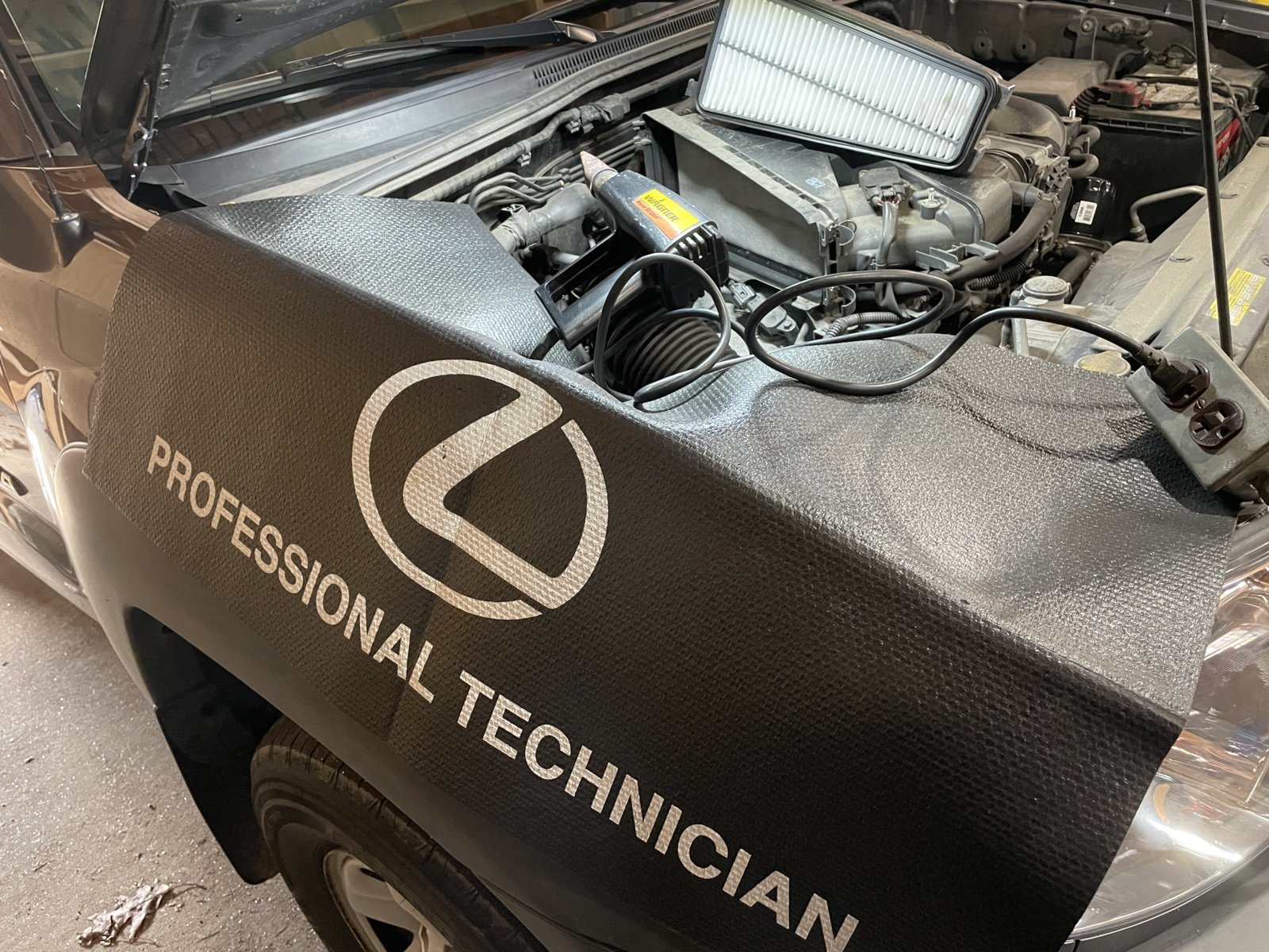

    A little workie workie.
    Work tip I’ll pass along.
    Seen plenty of guys break the retainer off the coil connector in cold weather.
    If you take a heat gun and warm the coil and connector so it’s warm to the touch,
    It makes the retainer more flexible reducing the chance of breakage.
    Fuck you never seize..
    What’s a torque wrench?

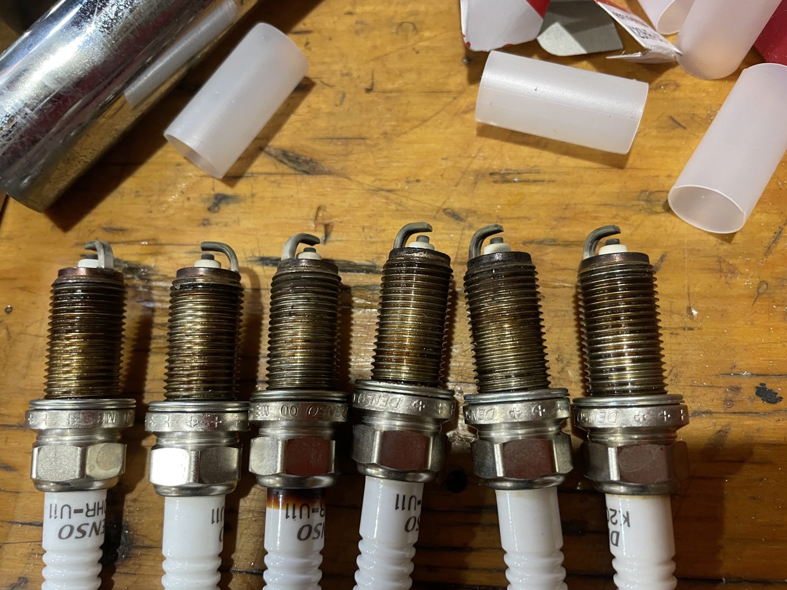

    40K on these plugs.
    Worn .004.
    I’ve put my old plugs in customer trucks before because they couldn’t afford plugs and the electrodes
    were worn off..
    Had a seep in the #2 plug tube last time so I loosened the Valve Cover and tightened it back down
    without a torque wrench… DRY AS A BONE THIS TIME!!!
    I’ll save these plugs for emergency…
