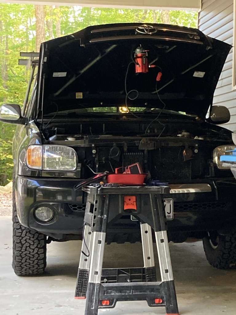

    Hubs is smoke testing to find an evap leak. Replaced the gas cap, no dice. Smoke seeping out on top of the tank under the frame cross member. Bed is coming off. :(

    He just replaced the evap canister underneath and found some rotted hoses but where the smoke is leaking out under the front tank strap theres no openings or anything according to the fiches and diagrams. :(

    Tank rotted?

    So, I'm going to not wish this on anybody, but I've seen where the top of the fuel pump rots or the hard nipple rots. Either way it's fuel pump assembly time. I hope this isn't the case, but I'm curious. I'm sure Mike will probably disagree. I'm 50/50 on it as I've only seen it on Chevy and Ford around here. Not sure if Toyota uses a metal top pump assy.

    He thinks theres a pinhole in it. 20 years of Northeast winters. Hes obsessive about washing and hosing the underfluffies but.. its inevitable.
