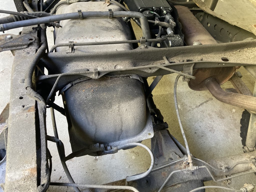

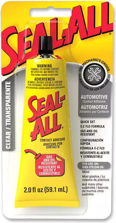

    Seal all
    This shit is good
    sand down the tank and make a nice patch with this. Let it sit for 24 hours.
    Saved my ass many times

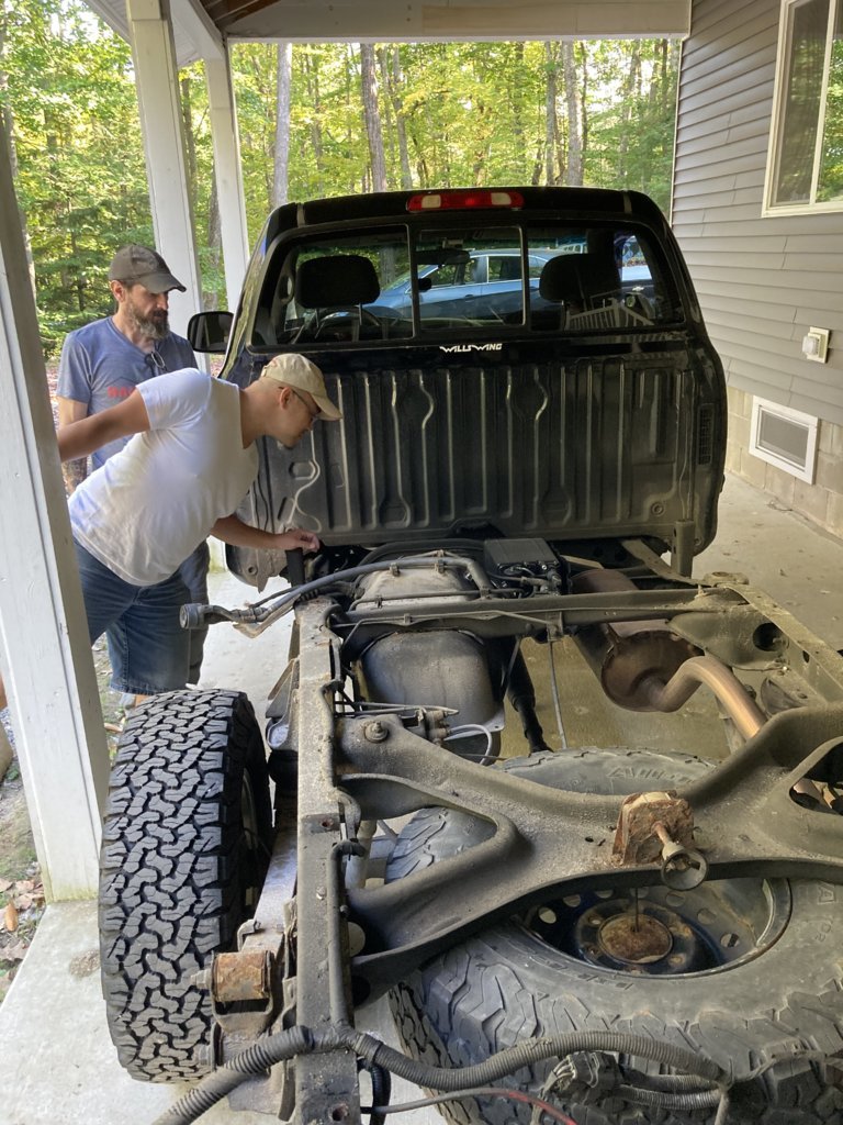

    Trucks dismantled and parked until the tank shows up. Hes using my truck since I have the work van. Not putting it together and taking it back apart again.

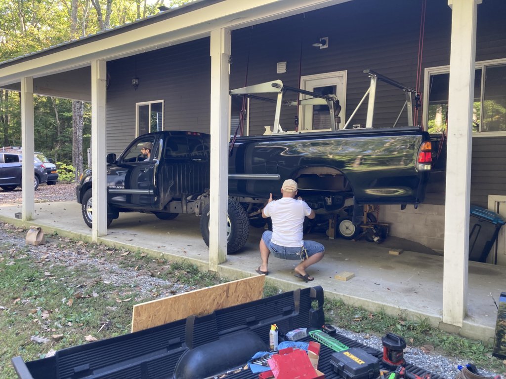

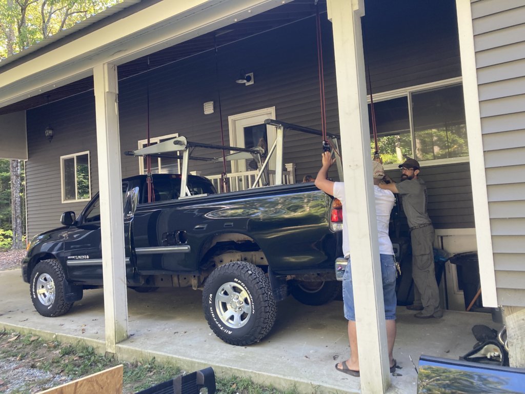

    How did he lift the bed up?

    Ratchet straps. We’re gonna use bottle jacks to lower it back onto the frame once the truck is backed under it.

    I count about 3 snatch block/hoist pulleys in the pics she posted. See next quoted post below.
