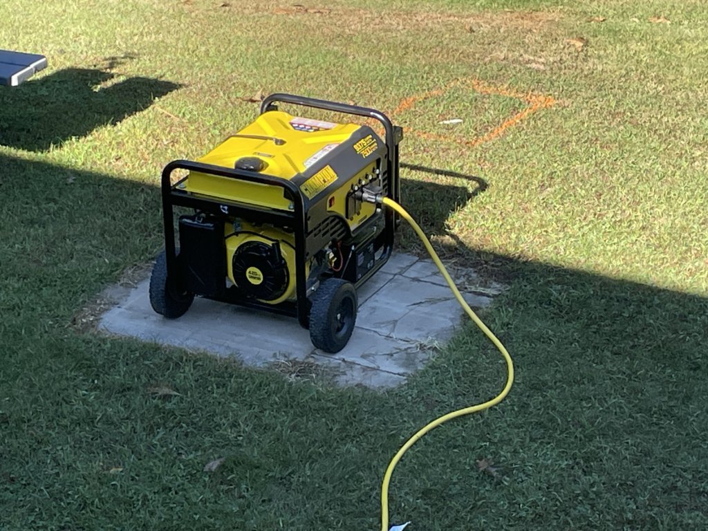

    No frills open frame gens kick ass. Yes they are noisier than the duper duper inverter models but, for 1/3 the price
    And the amount you use it, it’s a no brainer.
    I just got a new one only because I wanted the electric start option. So I went bigger also. Lol.

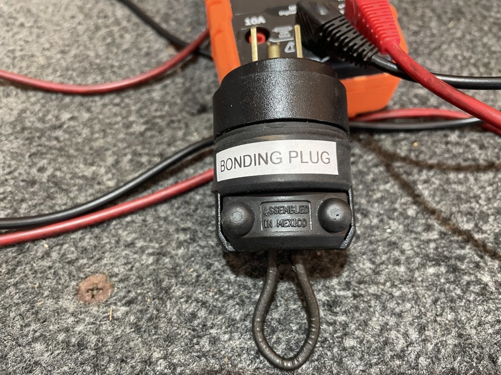

    Only change I made was switching the wiring to a floating neutral and made a bonding plug for stand alone operation.

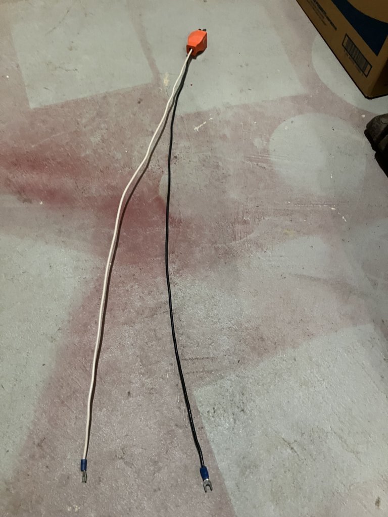

    All I run off the generator is well and furnace, have a hot wire set up. I really should get a more professional setup

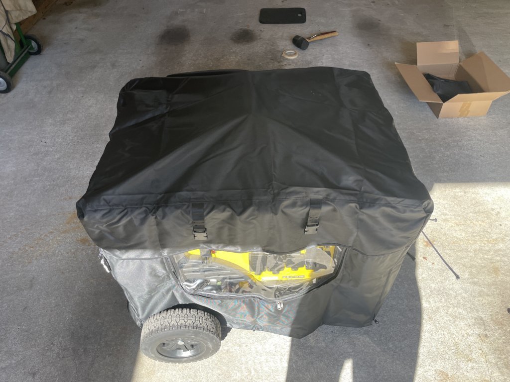

    I did get a use while running cover too since I’m not going to use a Gen box anymore. Since I have battery backup garage door openers now, I can get in much easier in any situation.

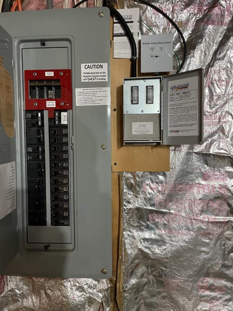

    Yea that’s not the smartest thing to do.
    Not sure if you saw mine but I have a lockout system and I have every circuit available.
    Much cheaper than a switch box.

    I hope your shutting of the main using that..

    Oh yeah, I’m not that dumb, yet :D You should have seen the crap we would rig up on job sites, an upside down garbage can as a “junction box “ cover. :eek:

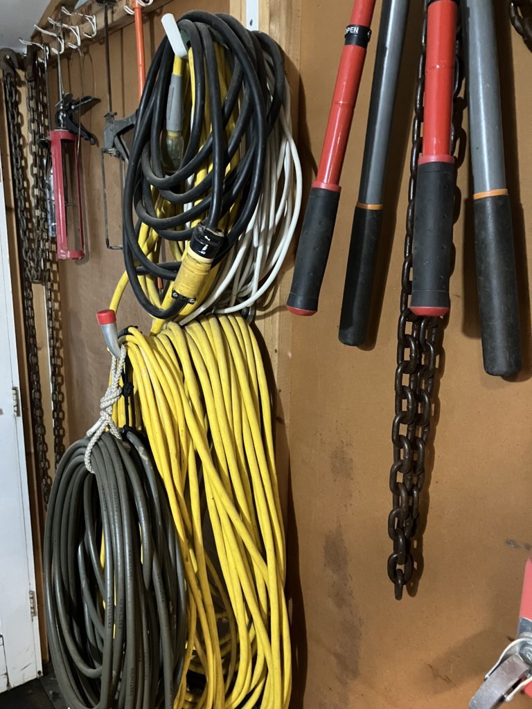

    Some of my rigging gear :D
