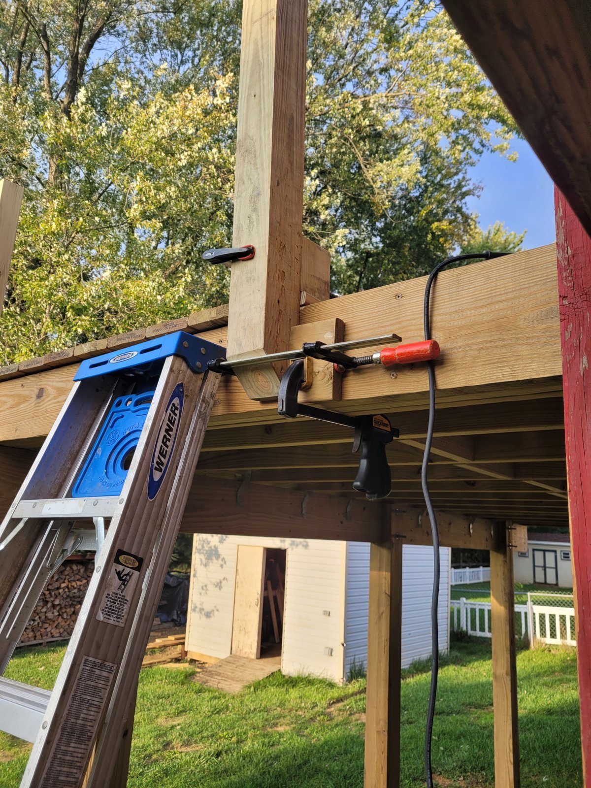

    I am going to ask a dumb question.
    Why only 2 cement blocks?
    I thought there would be 2 on the stair end also…
    Just trying to learn something…
    I know it’s secured to the stairs.
  8. Nov 14, 2024 at 2:42 PM
    Sig45
    Sig45 Well-Known Member
    Jun 21, 2012
    #81045
    23,612
    Mark
    Maine
    I added blocking between the posts, down low. I attached that end of the landing with structural screws. Much like you would with a ledger board along a house. I added joist hangers for added support, although with such a short span, probably overkill.
  9. Nov 14, 2024 at 2:43 PM
    Tacoma Mike
    Tacoma Mike [OP] 48 Year Chrysler/Toyota/ASE/ Master Tech.RETIRED
    Aug 6, 2011
    #61230
    31,162
    Southern Maine
    Ahhh ok..couldn’t see that.
    Way cool..
  10. Nov 14, 2024 at 2:43 PM
    Sig45
    Jun 21, 2012
    #81045
    23,612
    Mark
    Maine
    It's visible in pic #1.
    Plain Jane Taco likes this.
  11. Nov 14, 2024 at 2:46 PM
    Tacoma Mike
    Aug 6, 2011
    #61230
    31,162
    Southern Maine
    Didn’t understand what I was looking at.
    That’s why I asked…
  12. Nov 14, 2024 at 2:47 PM
    Sig45
    Jun 21, 2012
    #81045
    23,612
    Mark
    Maine
    I lagged into the posts too. She ain't going anywhere.

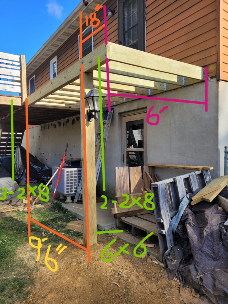

    @Sig45 -
    would it be asking too much if I posted a pic of something I framed, to get your feedback on if I should have another vertical post? I'm starting to second guess myself on progress with a recent project.

    Here's my hack attempt at using MS Paint to dimension a pic..
    My concern is- have I over spanned the double 2x8? I look at the charts for building codes for deck construction, I'm allowed to span a single 2x8 10' to a deck beam, then cantilever 24" past that. This doubled 2x8 is tied into a triple 2x8 and is going 9.5' to the 6x6. In some ways it's being used as a beam, as the 6'er's from the ledger are the joists. I'm not sure if I should add another 6x6 to maintain a 6' span between them, or if this current configuration will be ok. It seems nice and solid. I've decked it since this was taken.
  19. Nov 14, 2024 at 5:23 PM
    Sig45
    Jun 21, 2012
    #81045
    23,612
    Mark
    Maine
    How far out is the wider section to the left (just outside of the pic)? Where is the 6x6 for that? How far from that corner?

    The main deck is 12 x 16. The triple 2x8 spans 10' to the (3) 6x6's that support the deck beam. The deck beam is a double 2x10. ( the deck beam is just out of the frame of the pic)
    you can see the deck beam in the back. The double 2x8 is anchored with a hidden flange hanger right at the inside corner of the post in the foreground.
