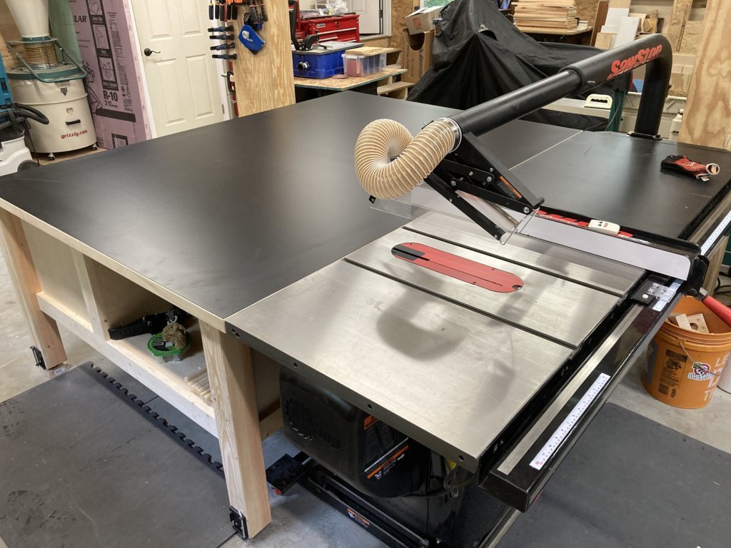

    Hubs just built an outfeed table and did formica over MDF with a maple edge band. Contact adhesive rolled on, routed the edges, and added a small chamfer. Not sure if thats similar but it was pretty simple. Just had to put sticks under the surface and ease on, otherwise it sticks to itself where you dont want it to and turns into a shitshow:notsure:

    Nice saw :thumbsup: ,we used to call them slip sticks or slip sheets , old Venetian blind slats, the metal ones work great . Great job on the saw
    Really jelly of the set up, commercial quality

    A lifetime ago I worked in a cabinet shop, that was their preferred method for re-skinning old counter tops for "budget" refreshes. We would pull off the old counter tops from the customers house then re-skin the original bases ( if they were in good shape). I think that the laminate sheets came in a 5' x 12' size, they were not fun to wrangle into place. They let the sheet overhang everywhere then used a laminate router trimmer to cut it down to size.
