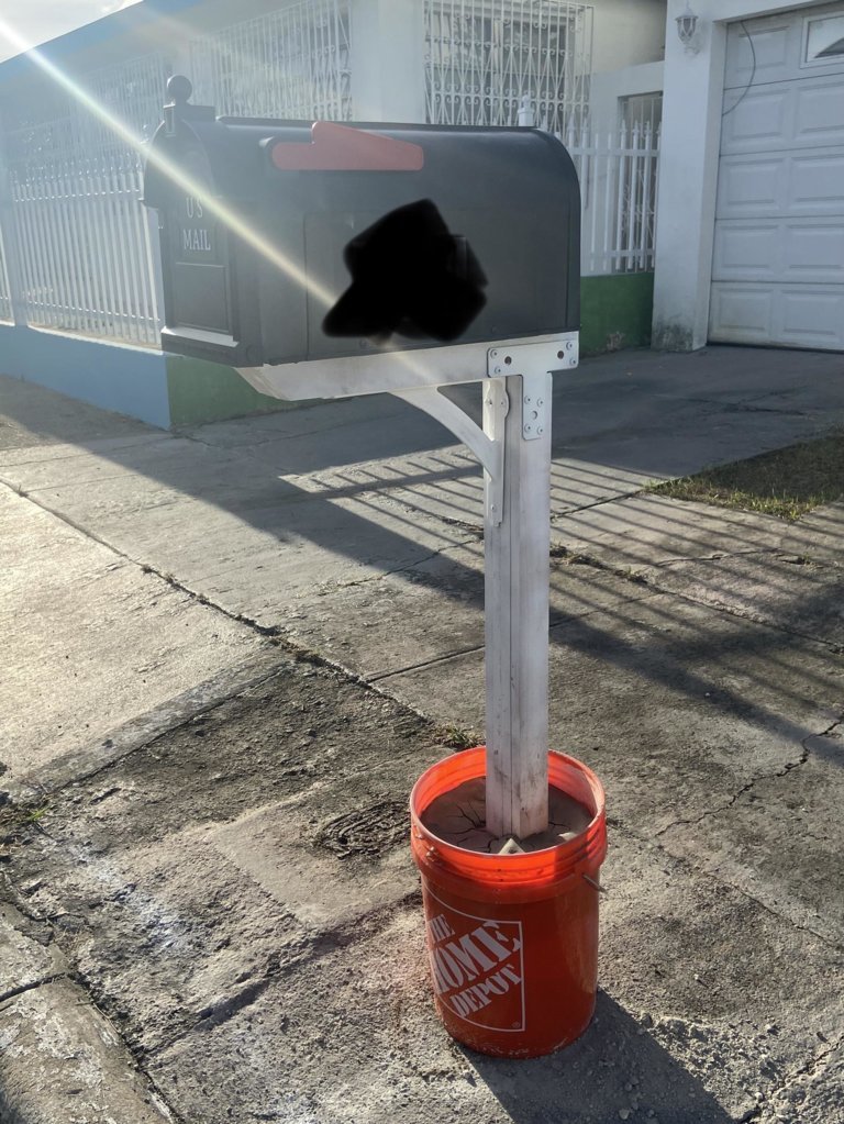

    So I have a question involving electricity. Lets say, for example, I know a guy that was recently hand digging a hole for a new mailbox and low and behold- a buried cable made it's presence know, in the best of ways. The cable was right in the way of where the 6x6 wooden post should have gone, so the best compromise at the time was to push the pole against the back side of the hole and cable and carefully back fill all 30" to keep the mailbox post nice and sturdy. That's how I was told the story... I'm just curious about if there's any generic guide lines that tells a guy how far away a wooden post should be kept away from any buried cables. I'll relay the answer to my buddy.

    The short answer is probably 3 ft. if we're trying to do a good job.
    The long answer from a construction perspective is that you want to keep your structure from possibly contacting the cable, either through freeze/thaw movement, subsidence/sinking, or water action or maybe through a vehicle striking the structure and pushing it into the cable.
    If you have 30" in the ground, I would stay that far away so that the post never shifts or tips and levers the bottom of the post into the cable.
    If this is just some wire the homeowner or someone ran for convenience, it's probably not critical but if it was to the pole from the house or a main line, I would be very conservative. Those are dangerous and expensive and sometimes they try to make you pay if you damage them.

    I wouldn’t get anywhere near that cable.
    If that has to be dug up, a backhoe is going to make short work of your mailbox.
    So I agree with at least 3 feet but I bet cable separation, which I think is 12”, would technically be ok.
    If you start throwing cement down, that’s a whole different ballgame..

    Honestly depends on what this mystery cable is. If its data i’d give it a wide berth but not worry too much. Fiber optic, stay tf away from because its expensive af to fix. Anything with power that can go boom shouldnt be anywhere near his mailbox, like a few feet away at a minimum and he shouldve out burial tape over it while he was burying it so the next dude digging sees it before hitting the wire. The utility owning it would make you be X feet away depending what/whom it belongs to.
