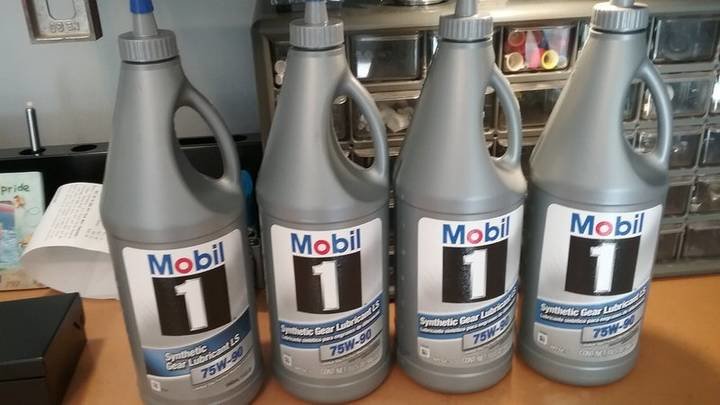

    2 separate things. I use Mobil1 75w-90 in my differential. But any 75/90 gear oil will be fine.
    As for your transmission? Check the manual on the type and weight of the oil.

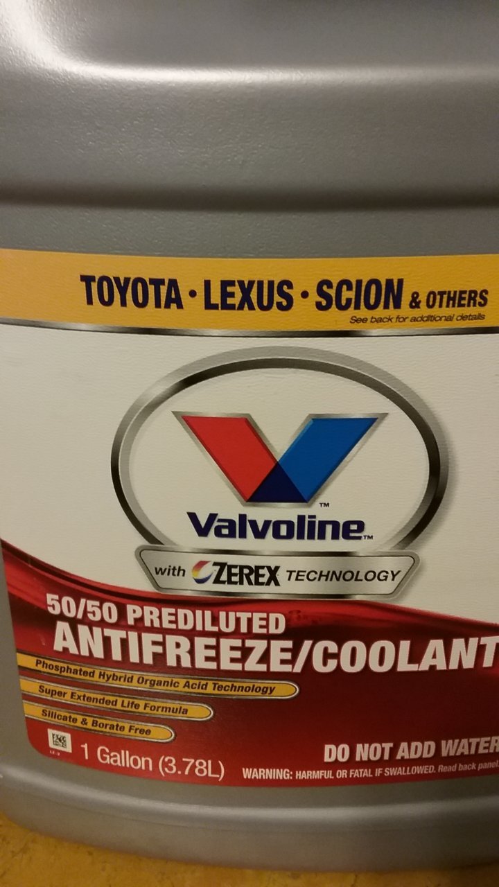

    I use Valoline Zerex pink coolant in all of my Toyotas. Premixed and you can get it at Wal-Mart.

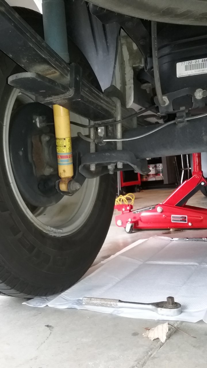

    Did some maintenance on my leaf springs today. Nothing wrong with them to begin with. Just some TLC.
    To open up the springs as much as possible I jacked it up by the frame so the axle would droop. Then I sprayed some Liquid Wrench rust inhibitor/lubricant between the leafs using the straw. Smeared the excess all over the entire pack.
    As it works it's away around over the next couple of days I'll wipe more of the excess that is forced out.

    What? You're not painting them white to match the truck??;)

    Haha...no. :D
    Too many stories about noisy leaf springs. I've never heard a peep out of mine. But the ol' girl is closing in on 5 years old. Figured I would be proactive against any squeaking

    Only time I’ve had noisy springs is after getting dunked in mud/ water. Jacked it up so the leaves separated just like you did and just power washed between, took the squeak right away never to return. Anti corrosion is never a bad idea though.

    The Liquid Wrench rust inhibitor is also a lubricant. Figured if I was going to the trouble to lube them, the rust inhibitor couldn't hurt. It's a rather thick product and behaves much like fluid film

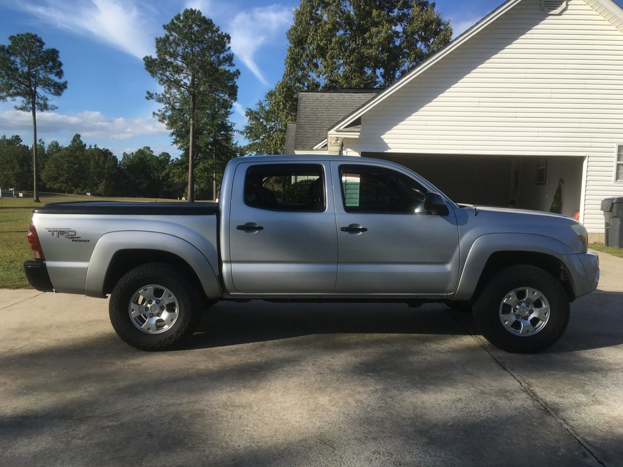

    I’ve never used it but it seems like good stuff

    Did the LW on my old chevy today took a ride across the pasture it worked great toco is not squeaking but going to hit it next week
