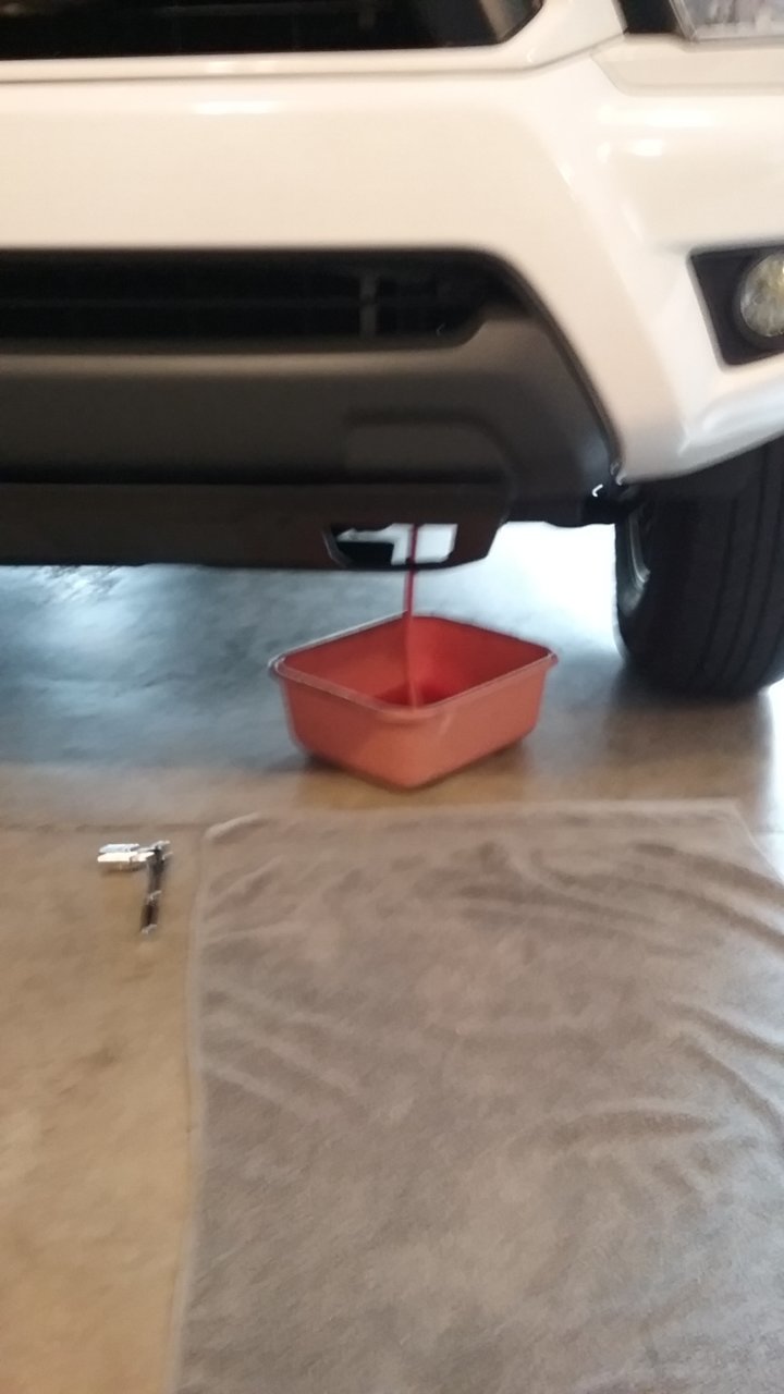

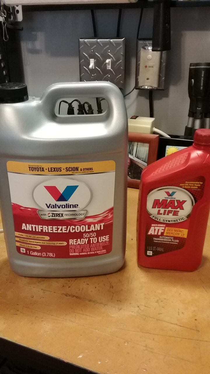

    Let's freshen up that power steering fluid and coolant.

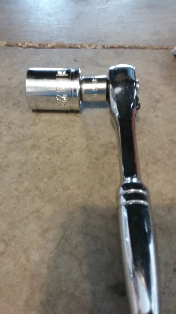

    Tip: A 22mm socket makes quick work of that pesky drain-cock. Just be careful when tightening it.

    I do a suck and fill on the power steering fluid every 5k miles when I do an oil change.
    I flushed my brake fluid a year and a half ago.
    This is my third drain and fill on the cooling system over the years. The Valoline Zerex pink makes it convenient. Walmart carries it for $13

    No issues with the power steering fluid and coolant. I'll adjust the overflow level over the next day or so.

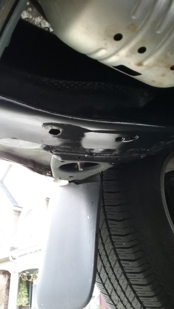

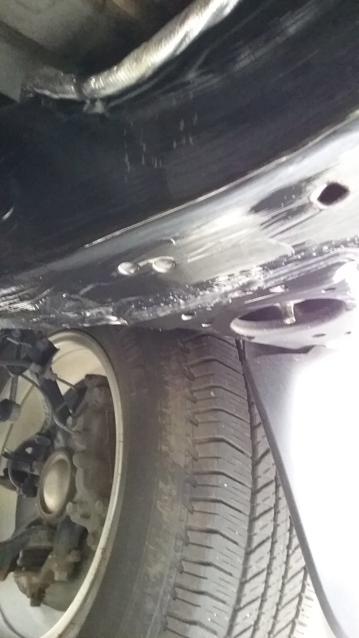

    A couple of weeks ago I soaked my leaf springs with some Liquid Wrench lubricant and rust inhibitor. Decided to do a couple of more areas. The areas around the cats are common rot places...particularly the driver's side.
    I emptied nearly a whole can into the inside of the frame from different angles. There are holes that allow that. Then I coated the outside areas.
    Probably do some more areas too.
    Driver's side
    Passenger side
