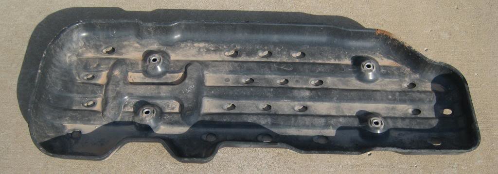

    Uh dude, thread title?
    It's for adding a fuel tank skid to a truck that didn't come stock with one of these:
    Because if your truck didn't come with one of those, it has no studs on the straps.

    Ah, this clarifies things a bit for me.
    Is that the standard method of adding aftermarket fuel-tank skids?

    1. No no, I just meant Amazon / rockauto / whoever you personally like shopping from the best. I have no retail store. ;)
    2. They replace OEM straps. TRD Off Roads came with them, every other Tacoma did not.
    3. The studs allow you to bolt the skid to the tank (well, you use nuts to hold them on but "nut the skids to the tank" sounds silly:rofl:)
    4. Yes it's the standard OEM pattern which all aftermarket skid people should follow.
    The standard method so far has appeared to be:
    1: buy a TRD Off Road instead
    or
    2: Go to the dealer and pay $66 for the front strap, and $76 for the rear strap.
    This product is an aftermarket replacement part that is both straps for less money.

    Ok bro, I was just asking for a friend... don't bang on me! :anonymous: and my friend doesn't have an OR so he would know what to look for since nothing like that there!
    Clear now thanks. Where did you get the gas tank skid from? again ... asking for a friend! :D

    Should work for 2nd and 3rd.

    Keep digging around here. I got mine for $30, some members give theirs away to locals, there's plenty floating around you just gotta hunt 'em down. :thumbsup:
