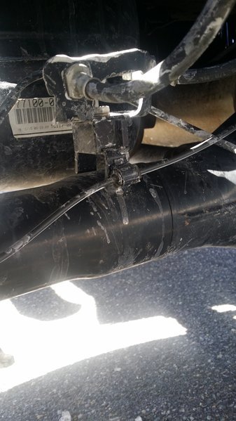

    If its already installed whats the issue? My rear shocks came with a little block thing for the rear brake line bracket but im only like 2" up. Brake cables seem to be more an issue than lines for me though if i went higher
    Edit: bad pic but the black block in there came with my bilstein 5160's. Didnt think it was needed but since i had it i threw it on

    I was swapping my diffs and unbolting the hardline (per instructions) and was like WTF is this block. I have a small one I must’ve put on with my 5160.
    here’s what I don’t get. Why?
    I have extended rear SS lines. As one should.
    is Bilstein expecting folks to do things janky-style with lift and stock lines hence then including a puck?
    I got the puck installed again when I put it back together but am not a fan of the angle, stress tension on the hardline, and how hard it makes it to line up and bolt in.
    Oh well. It’s on there now. And has been there some time without issue.
