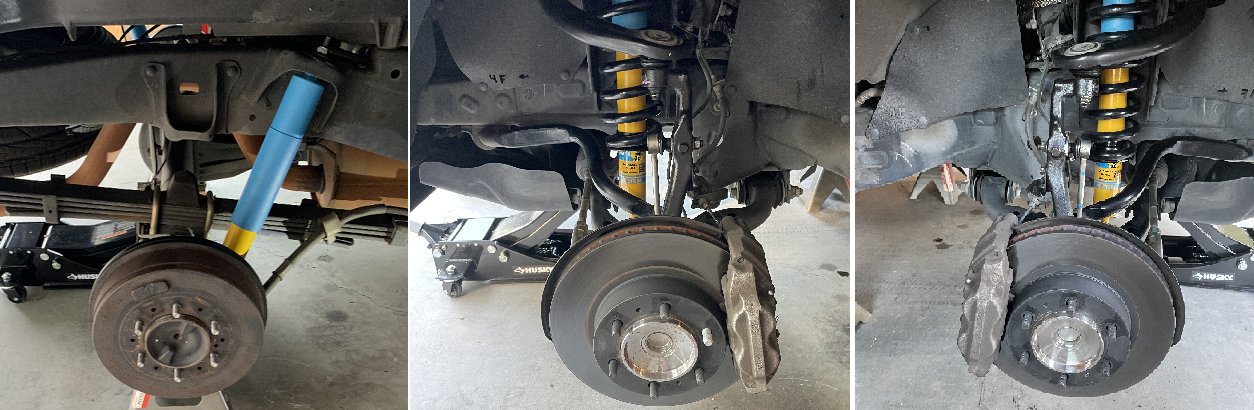

    Finally got around to completing a round of maintenance on my 17' Sport. It's got 116,000 on it now and still had the original Spark Plugs, Shocks, Struts. Ride quality was getting pretty bad.
    Shocks/ Struts for TRD Sport with Stock Springs (My $0.02)
    I've been reading up on the various lower cost Bilstein options and there seems to be quite a bit of debate on which shocks/ struts to pair with SPORT springs to soften the ride, but not make it as soft as the stock TRD offroad (no nose-diving).

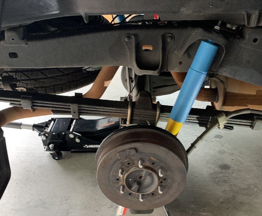

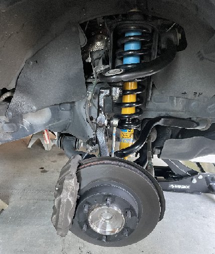

    After lots of reading and advice from a few other members here, I ended up going with the Bilstein 4600s - 24-265973 (4600 Rear); 24-265966 (4600 Front).
    Common misconception seems to be that the 4600s are the same as the stock Offroad - but they are most certainly not. Pairing them with the Sport Springs was EXACTLY the ride quality I was looking for in my truck. Good for daily driving, but softer than the stock sport suspension.
    Why not just go with 5100s? I almost did - I've had them before on my old Gen 2 SR5 PreRunner. They were fine but the 4600s are cheaper and I have no plans to level or lift. My tires (265/70R17) give me a 1/2” 'lift' over stock and I like the current stance of the truck. The 5100s I believe are also a bit 'stiffer' so I had concern with 5100 + Sport Springs = stiffer ride than I wanted. There are certainly BETTER options than 4600, but bang for buck - I don't think you can beat them for normal use with a little fun thrown in every now and then.
    ZERO regrets on the 4600s!

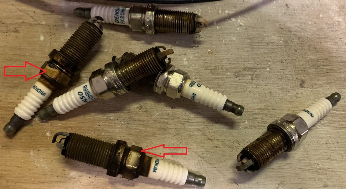

    Spark Plugs (FWIW):
    Unrelated to the title - but I also knocked out the Spark plugs this past weekend and it was definitely time. Passenger side was pretty simple but drivers side was a lesson in patience. It's not that bad once you figure out how to move the brackets/ hoses out of the way and realize that *YES* - a long extention will fit past all of the stuff - and *YES* those coils will come out with creative maneuvering.
    Like I've read from other's experiences - a couple of my plugs were quite loose (could remove by hand and there was some scorching on the coil boot - you can see the difference in the picture below of those vs. the others). I've read debates on 60K (Toyota Interval). vs 120K to change the plugs. My take - if you are mechanically inclined and able to do it yourself and save the labor cost - just spend the $85 in parts and do around 60-80K. If you are paying someone to do it - maybe wait till 100K if it's running fine to save a little money on those intervals. I'll likely do mine again at 200K (which will be 84K miles from now)

    I also just changed plugs @ 74,850 miles. No scorched boots but I did notice that they were not as torqued down as I would have thought. Very easy to turn to get out. The plugs didn't look too bad at all but the truck seems to idle smoother after the change. Only got a few scratches on the inside of my forearms and a couple of gouges on the top of my hands.
