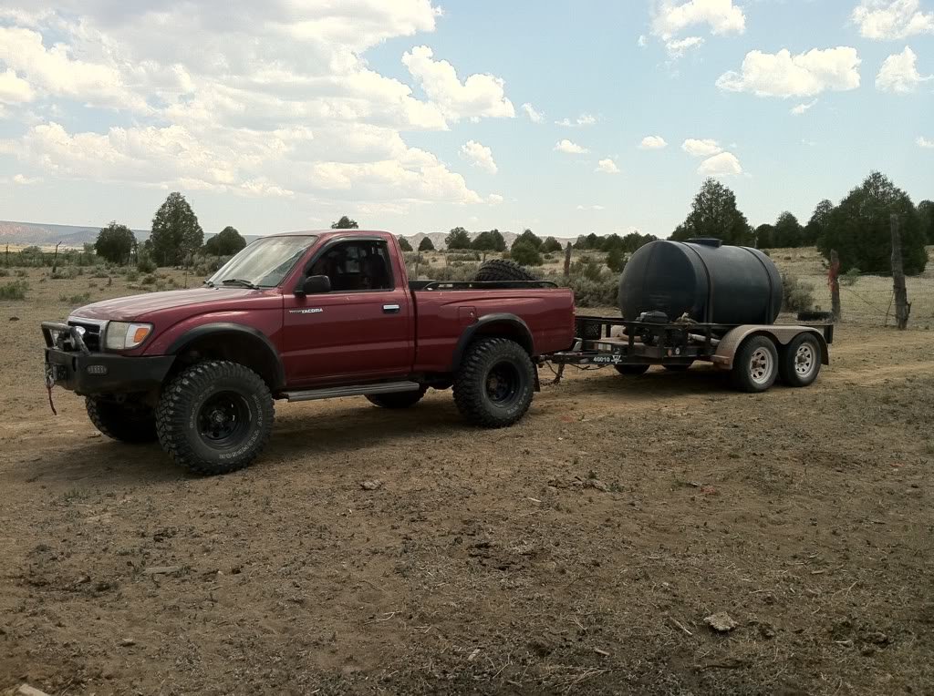

    Yeah my poor truck keeps suprising me on what it can do. I really think 1st gens are meteor proof.:rolleyes: I also have a photo of my truck towing a 500 gallon water tank on a trailer.
