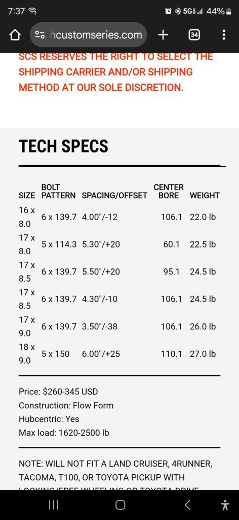

    I use a 17 x9 with a -38 or 3.5 bs I'm on a 34 but I don't rub the frame.and probably wouldn't with a 35 either.

    I hope you know that offset (-38) is different from backspace (3.5)

    Per the mfg.

    yes, that’s the spec of the rim. But you can have a -32, -38, or a -44 offset and still have a 3.50BS. The terminology “or” from your post will confuse people because they will think that a -38 will achieve the same 3.50BS. They’re not the same, guess that’s what I’m getting at.
    “backspacing measuring the distance from the wheel's mounting surface to the back edge, and offset measuring the distance from the mounting surface to the wheel's centerline”

    yes, rim offset is different from backspace. You can have a -12 offset and have a 4.00BS. In my case, I had a -32 offset with 4.00BS. We can’t expect all manufacturers to be the same or assume rim offset will equal the same BS.

    It also has to do with the rim width. I have a 9" wide rim

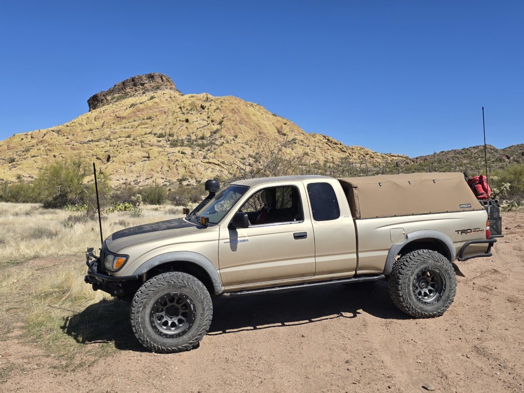

    Can you post a picture, is it the set up in your avatar? Also how much lift

    Thanks for the pic and video, where is it rubbing in the video? Sounds like plastic, I'm hopeful because I don't have any of that plastic anymore.

    Yeah it's some small pices of liner and a bit of the flairs..
