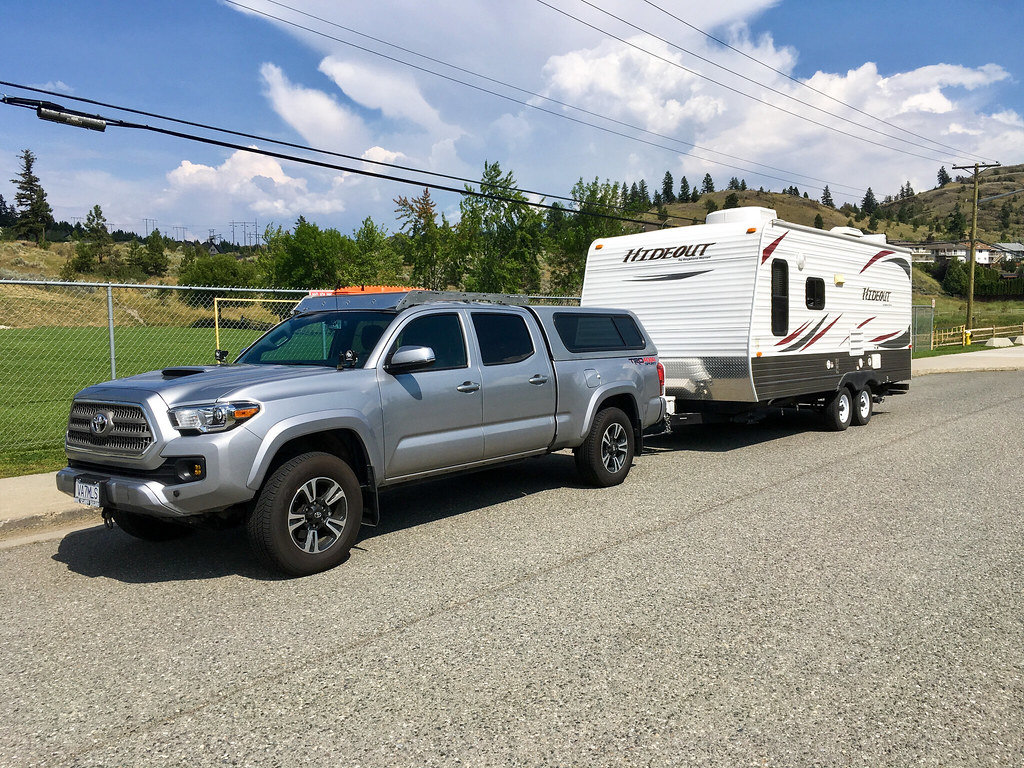

    mike
    Kam,BC
    2017 TRD Sport 1D6
    No worries, put 265/70 R17 Toyo RTs on and towed our 4800lb Hideout all summer..
    Canadian Caber and easy_E[OP] like this.
