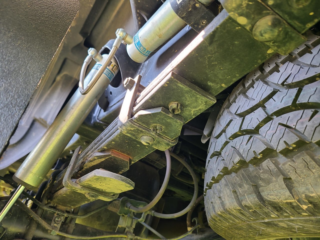

    Yes on the exhaust paint but most of it flaked off, used Hi temp paint too.
    Here is a better pic of the AALs and rear guide:

    That's correct, the AC with MT is lighter that the DC so it lifts higher.
