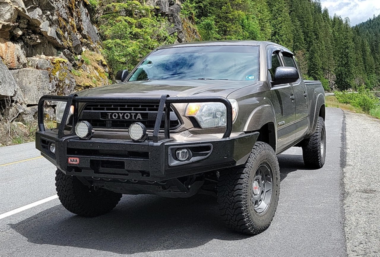

    Didn’t realize how big the ARB bumper is, it’s a tank!

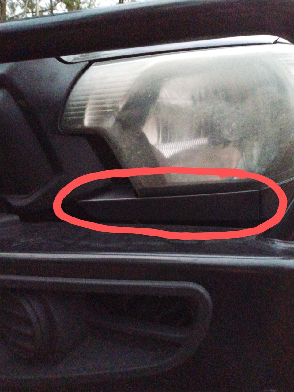

    The original trim pieces that came with the truck need to be reused with the ARB bumper. I had to ziptie mine from the inside to get them installed. See the first pic.

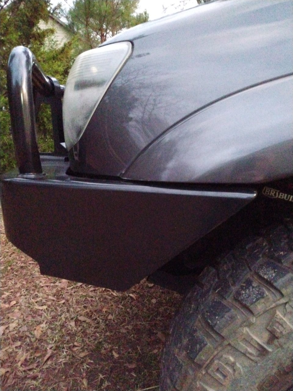

    Also, the final step of the bumper install requires 4 holes to be drilled into the bullbar and 4 bolts to be inserted through the predrilled holes in the actual bumper and secure to the bullbar. The bullbar is what ARB calls the bracket that mounts to the truck which holds the actual ARB bumper. This final step allows you to fine tune the position of the bumper. It looks like this step was skiped and they just tightend the bumper without pushing/pulling the bumper into position, drilling the holes, and securing it. See second pic below where my bumper sits almost flush against the truck.
    I'm also running an 05-11 ARB on my 2012 Tacoma because that model fits a little more snug than the 12-15 ARB bumper but regardless you shouldn't have that much of a gap on your install.
    Keep in mind that the installation instructions are garbage which could be why your body shop missed some of the steps.

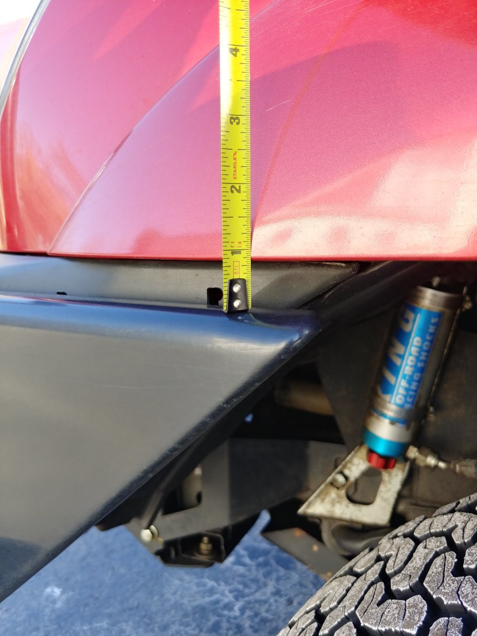

    Just under 7/8" gap towards the rear of the wing. Slightly less than that at the front of the flare

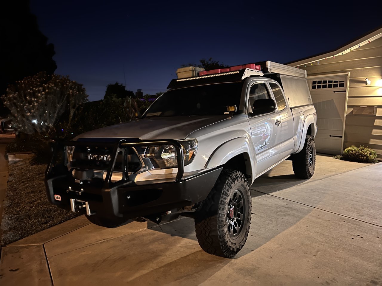

    Yeah so we just finished mounting mine. Probably just reiterating all the other posts but once you cut the bumper it’ll fit that gap a lot. It would be pretty difficult to put on the trimmed bumper after the ARB has been mounted. The ARB has 3 slotted holes on each side of the mounting bracket, so you can adjust it quite a bit. You can only really have a good sense on where it needs to be based on the trimmed bumper. The cut of the ARB bumper fits quite good around the curvature of the stock bumper. Hopefully they didn’t drill the final hole just yet. If not, get a stock bumper, trim it, and you should be just fine. Let me know if you need any pics of the mounting

    I have that bumper on my 2014 AC. Installed it myself. 7/8" gap at the fender is definitely too large, should be about 4/8" (1/2"). Definitely needs to have some gap there as it prevents the body from rubbing on the bumper during aggressive suspension travel.
