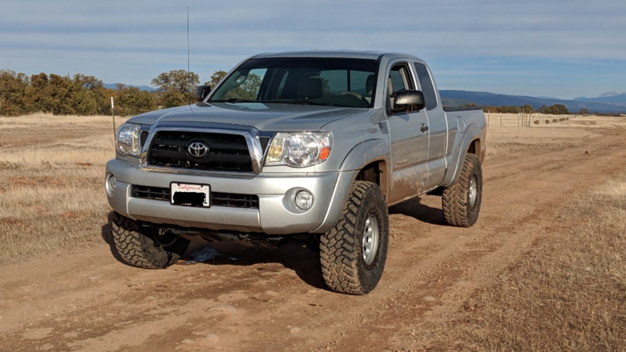

    Hey guys. I have an 09 tacoma I plan on putting a 3 inch lift on. Wondering what size tire suggestions you guys have? Was looking at either 32.6 or 33s. Suggestions or constructive criticism welcomed. Thanks !

    285/70/17 if you have 17’s

    If you want to have little or no trimming but like wider tires, easiest is to go with the Nitto Trail Grappler 285/70R16s. These are the only tire made in this size, which is the biggest downside to these. You get 31.8" height with the 11.5" width when you go with the 70 series.
    If you want the best looks with a 3 inch lift, any 285/75R16 will work, just choose the one you like best. A lot of tire options for this size (32.8"x11.5") You will have to do a fair bit of trimming and possibly a cab mount chop to fit the 75 series though.
    Either of these sizes will still rub if your wheels are too low of an offset. Try to stay close to 0 offset and an 8 or 9 inch wide wheel if you want the easiest fitment.
    Here's mine with just a front level and the Nitto 285/70s for reference. My wheels are a -12 offset 16x8, so I had a bit of trimming.90255760.jpg
