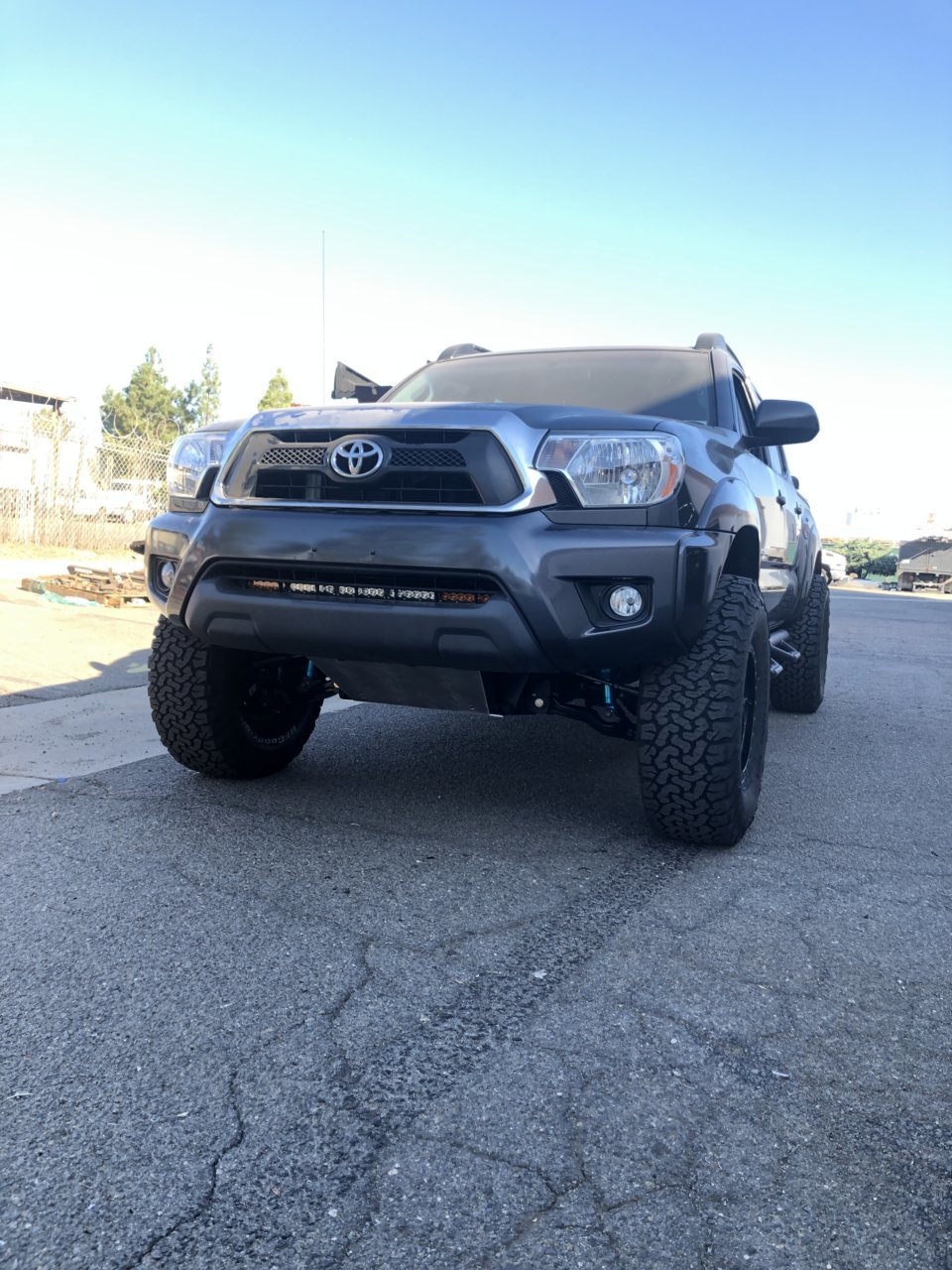

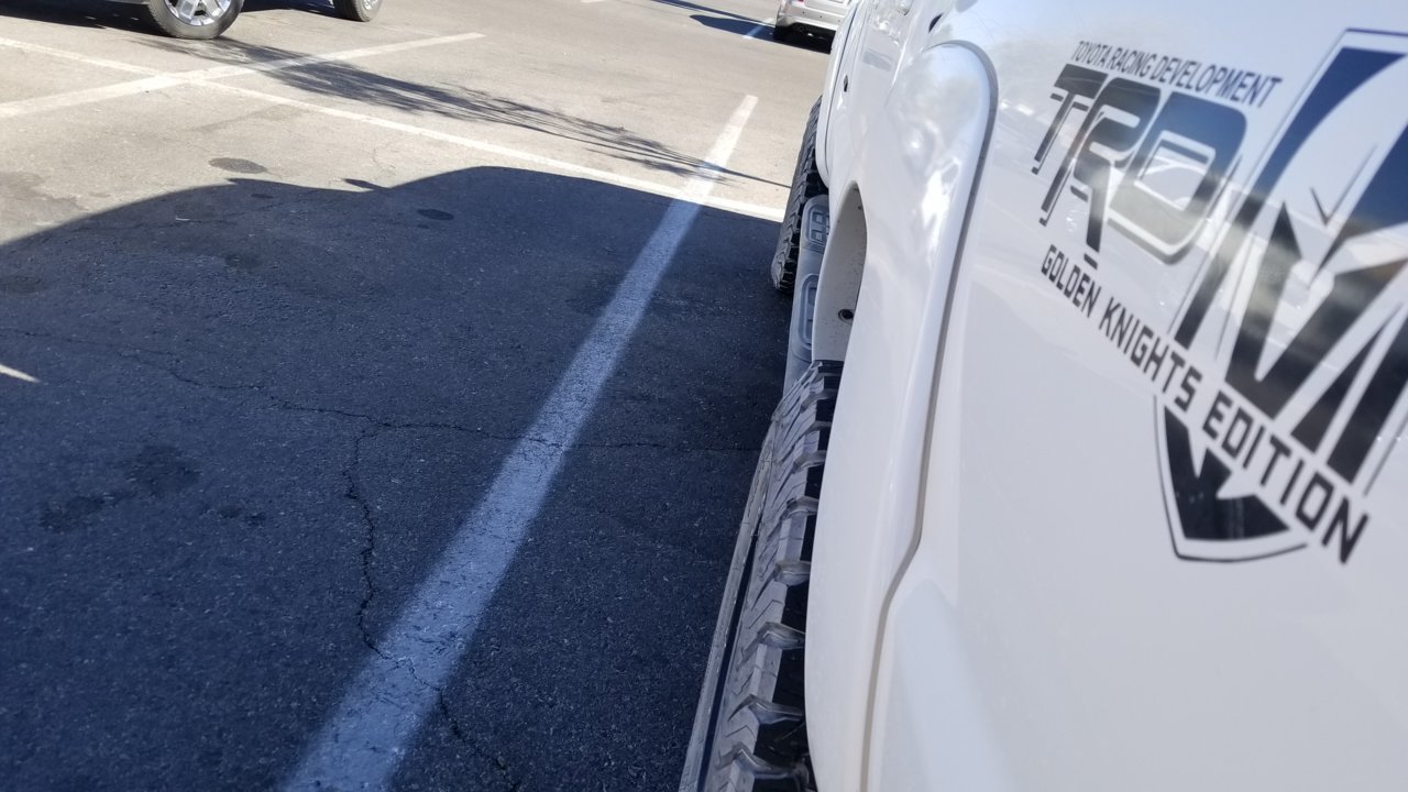

    Not methods but 16x8 with 4.50" bs/0 offset

    The wheel is flush with the fender when running a 265/75 as shown in the pic above. Were you looking for something else image wise?

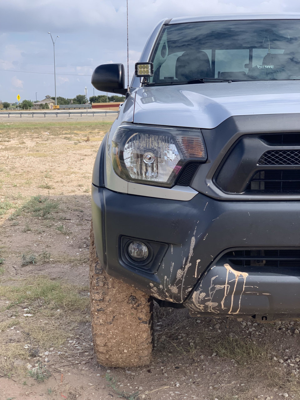

    I have the MR301's in a 16x8 4.5" BS and they sit flush with my fender flares. headon.jpg

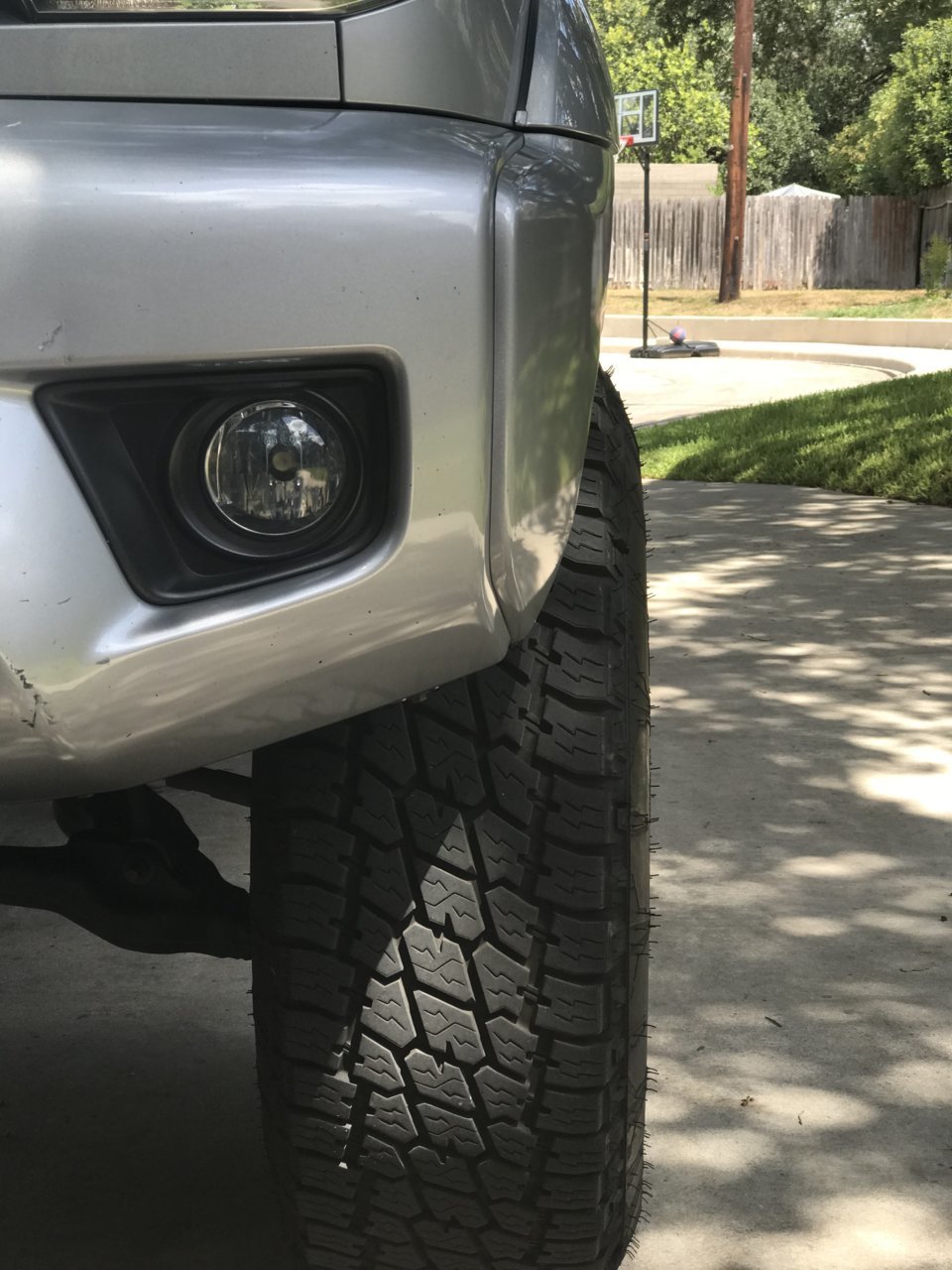

    17x8.5 -10 offset which 4.3 back space. Backspace = wheel width divided by 2 + 1/2”(that’s for a 0 offset wheel) regardless of manufacturer. If you have a positive or negative offset you add or subtract accordingly. 285/70/17 nittos83B8F13F-E1BB-470E-933E-658F32240C2A.jpg

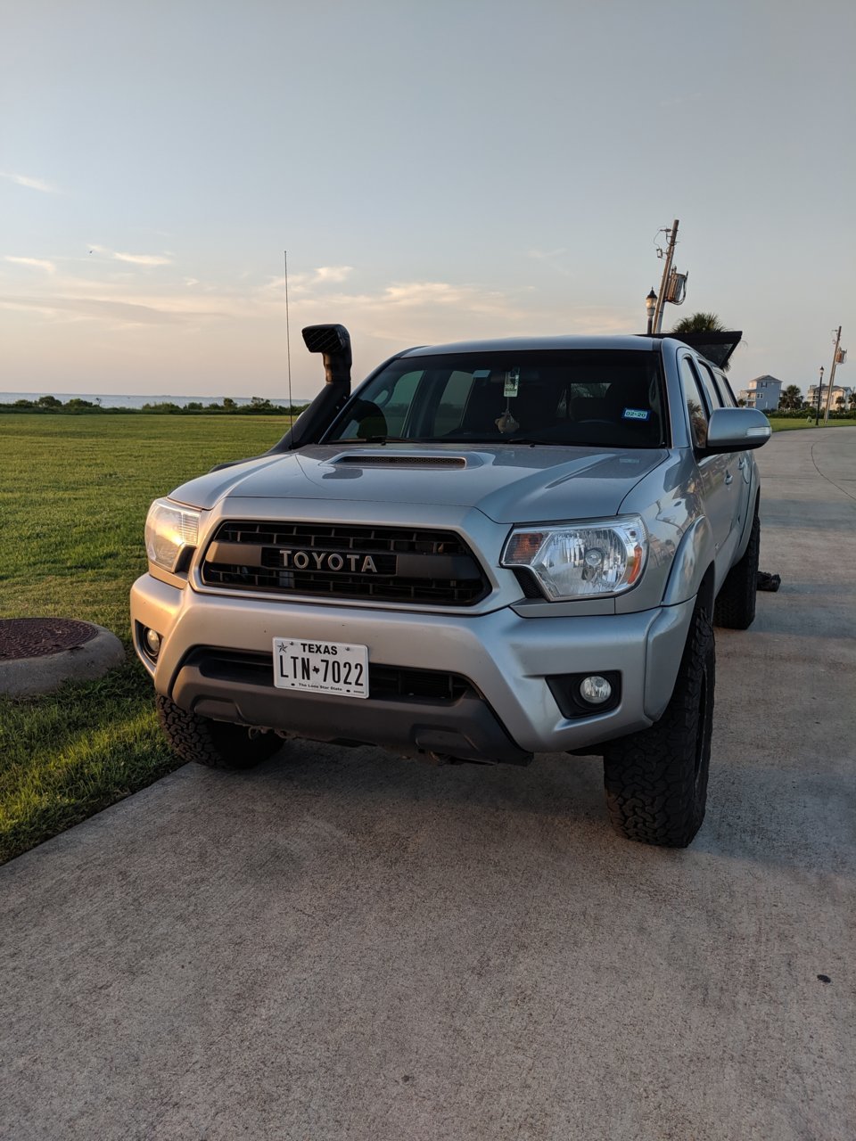

    Here's mine. 16x8 Method NV with 0 Offset. I'm on 265/75/16 BFG KO2. All stock suspension too. For me, it kind of sticks out, but not too much. Personally the perfect amount for me.
    Sorry I can't take better pics at the moment cause I'm at work, but I think this photo gives a pretty good idea?

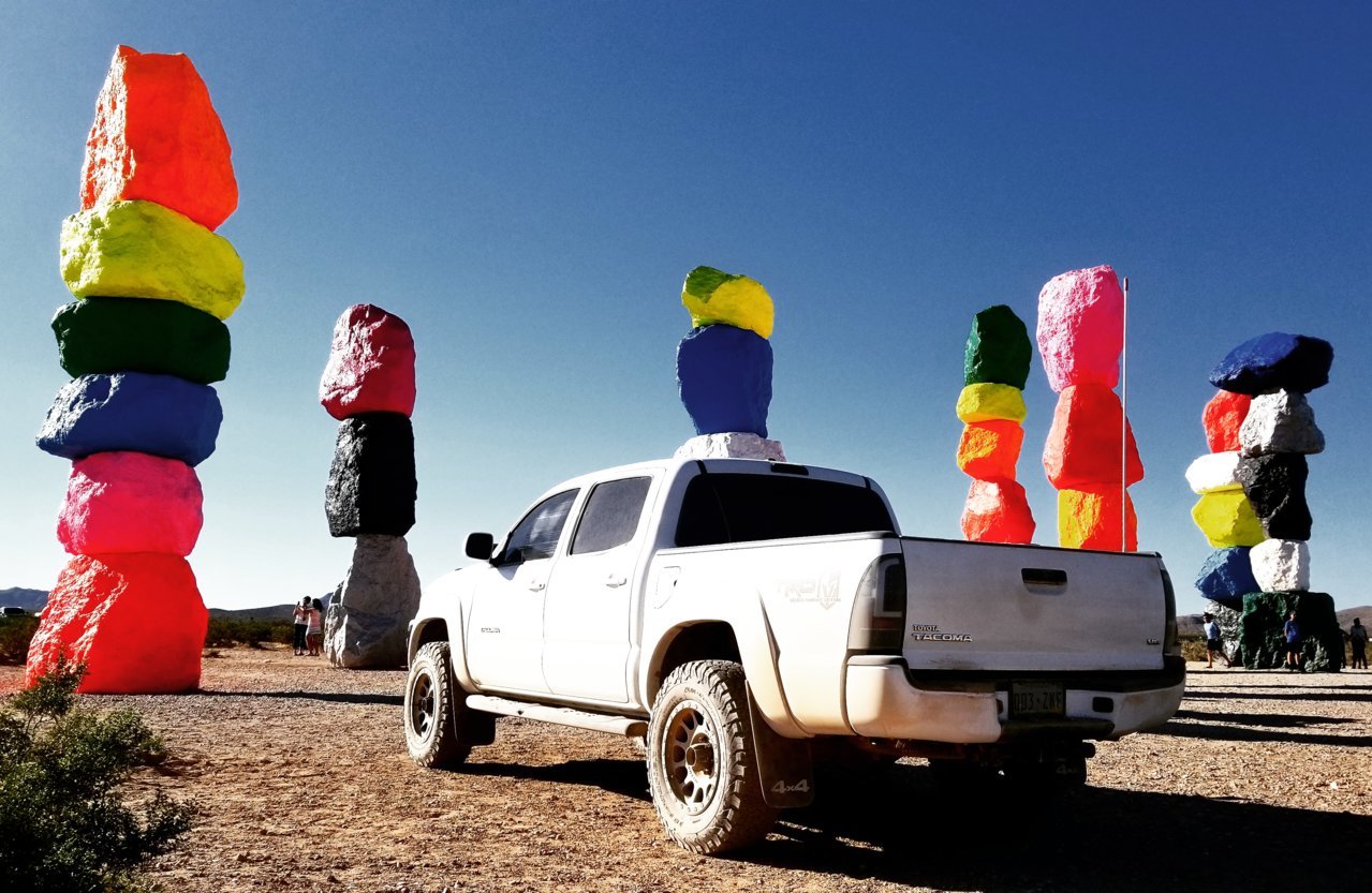

    I have 0 offset methods but I have 265/70/17

    This looks about like what I want

    Ya looks good!
