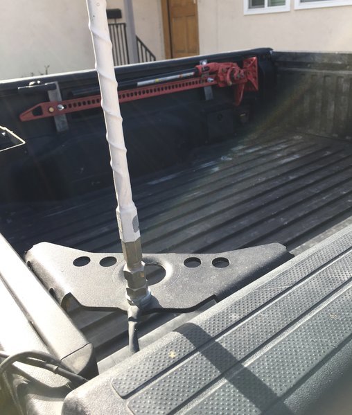

    I unbolted my back seat panel compartment which revealed a rubber grommet thing as well just slid it though there and up in between bed and cab...not the best pic but only one I have right nowIMG_4140.jpg

    Oooo which antenna mounting bracket is that?

    I used a uni-strut L bracket. Drilled a hole under the rail and ran the cable between the cab and bed.

    No prob... I like the extra mounting points mine are just rattle can primered with bedliner which held up through my Death Valley abuse this past weekend

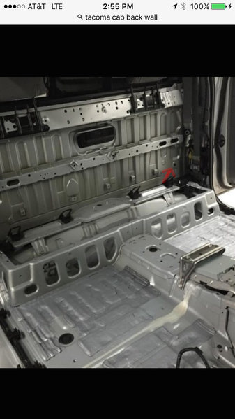

  14. Apr 26, 2017 at 2:29 PM

    any body got pictures of these grommets to run the cable.

    Pic is from the internet but the one I used I drew an arrow to
