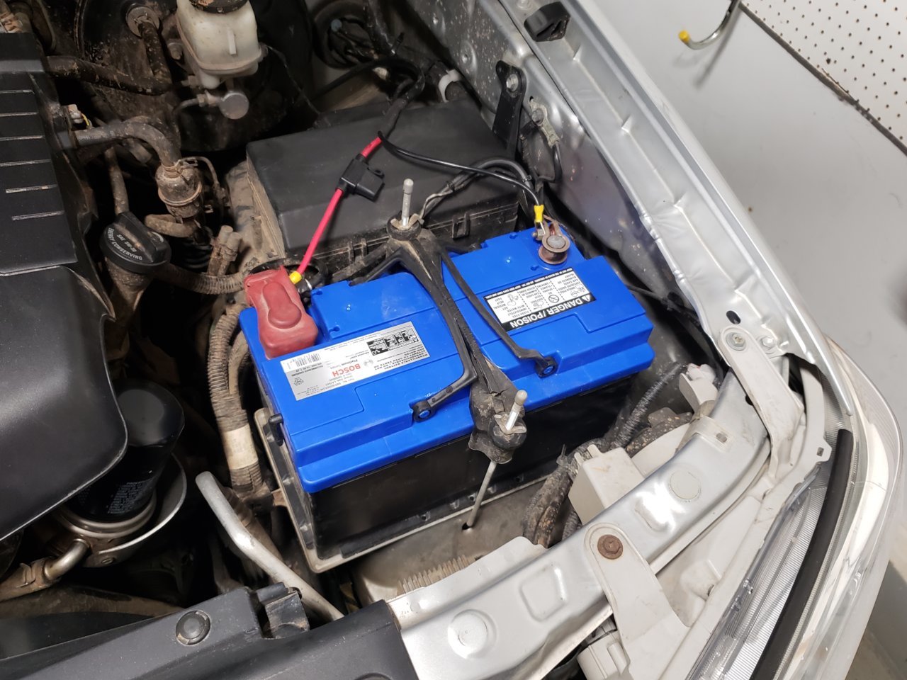

    I have a Bosch 94R AGM 80AH battery. It runs fridge and lighting and have never had power issues with it. It's a pretty big battery.

    Mine fits..
