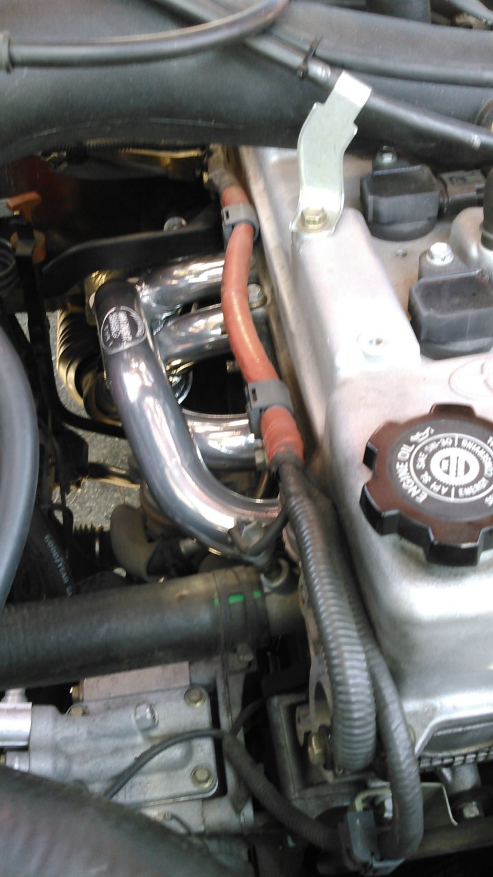

    Also running a Doug Thorley TRI Y Shorty header with merge collectors

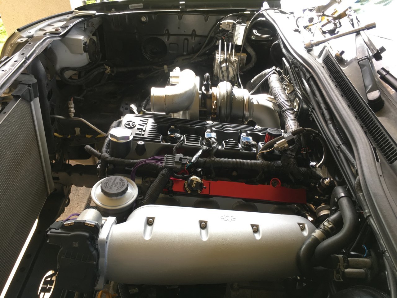

    Build your own, I did... but you can’t do it for $2k.
    I did it because I wanted to stay in 5th going up hills.
    For the money, possible to do a V6 swap (and recoup by selling your 4cyl)

    Don't know yet, my clutch slips before I even get to 2500 rpm when I get on it. I'm in middle on deciding upgrading clutch or swap to auto transmission at the moment.
    edit:
    full disclosure, this is a built engine with upgraded internals and I'm running a turbo that puts out 40psi+ [currently using a 10psi spring]. I wouldn't worry about HP numbers, just know the driving experience with 5psi would be completely different and this engine could definitely use it. I can go up large/steep hills with cruise control in 5th @ 65mph no problem (requires 3-5psi).
    I feel OP's desire for a little more, even if just to keep up with traffic.

    Is that your intake space in there?

    You have a different intake manifold being your a first gen. Ports are different from 2nd gen. Same motor just different ports

    The intake flange used is what the spacer is based on
