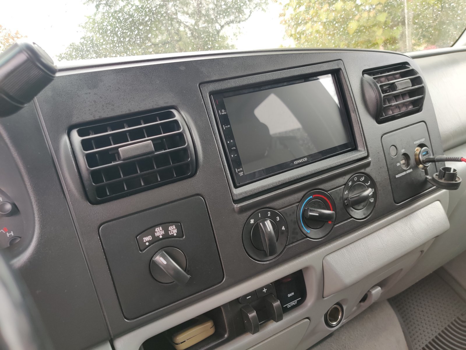

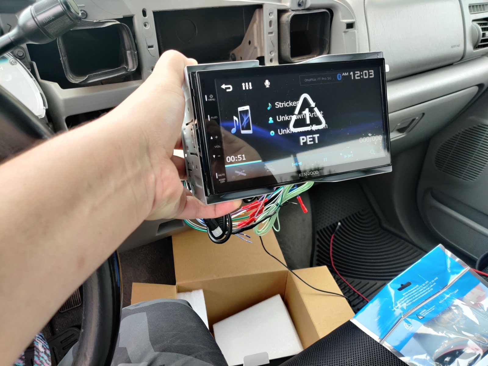

    First mod on this stock truck is a Kenwood Head unit, was hard driving around w/o my music. I cleaned up behind the dashboard, I need new dashboard clips, 2, and will need a new dashboard panel as it's broken by the far right ac vent when I wire up for a backup camera. As the truck is stock and almost 20 it needs some attention. Current to do list for it is as follows.
    New Bilstein 4600 shocks, new keys, jbl 6x8 speakers, new grill badge, new dorman 905-113 shifter, new clock spring/horn contact-need I need trouble shoot why cruise and horn do not work, morimoto 3rd brake light and new tail lights (anzo OEM vs recon led), xdp coolant cap, add aux upfiter panel, blue spring mod, 6.4 power stroke banjo bolts, mishimoto catch can, truetrac LSD, synergy mfg heavy duty steering kit, banks vs mbrp turbo back, fass vs airdog lift pump, new spicer u joints, and gauges.

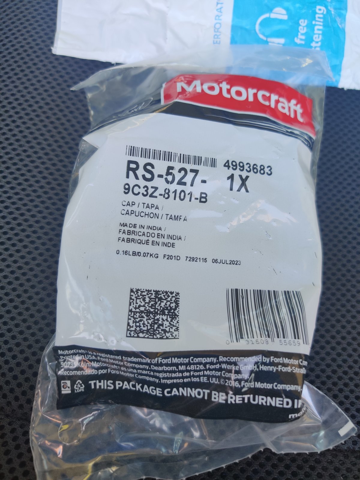

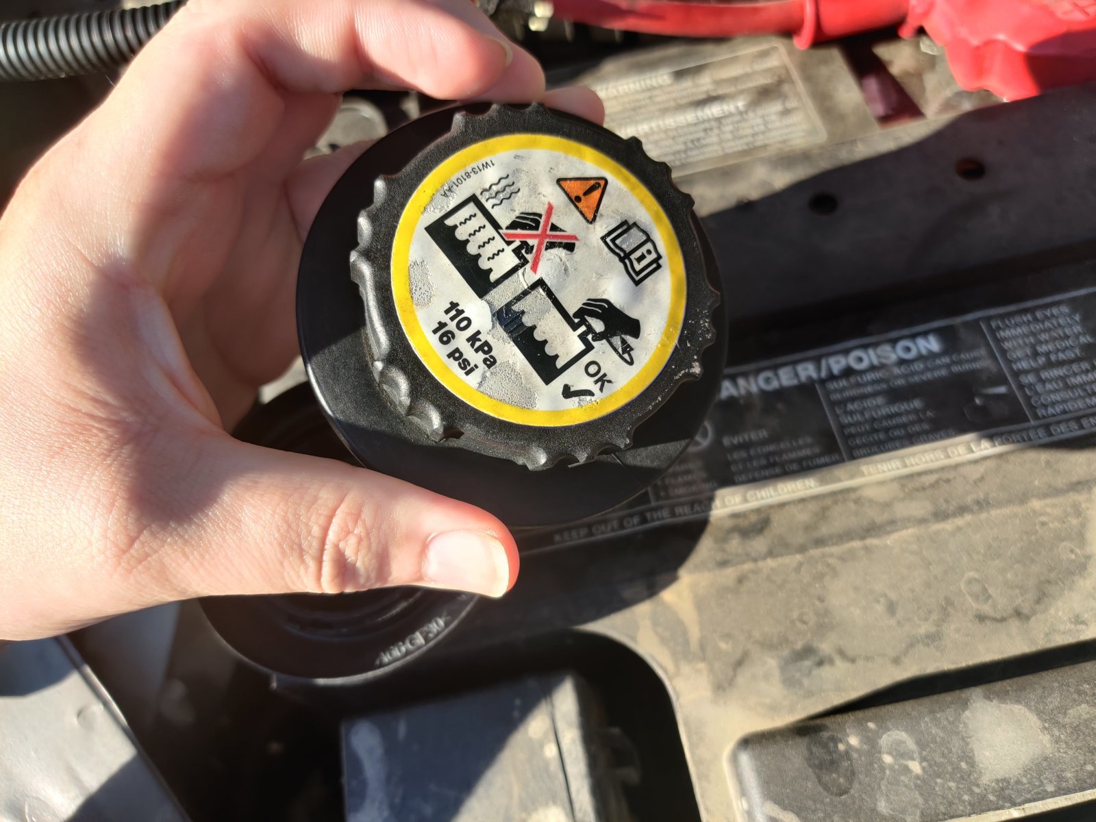

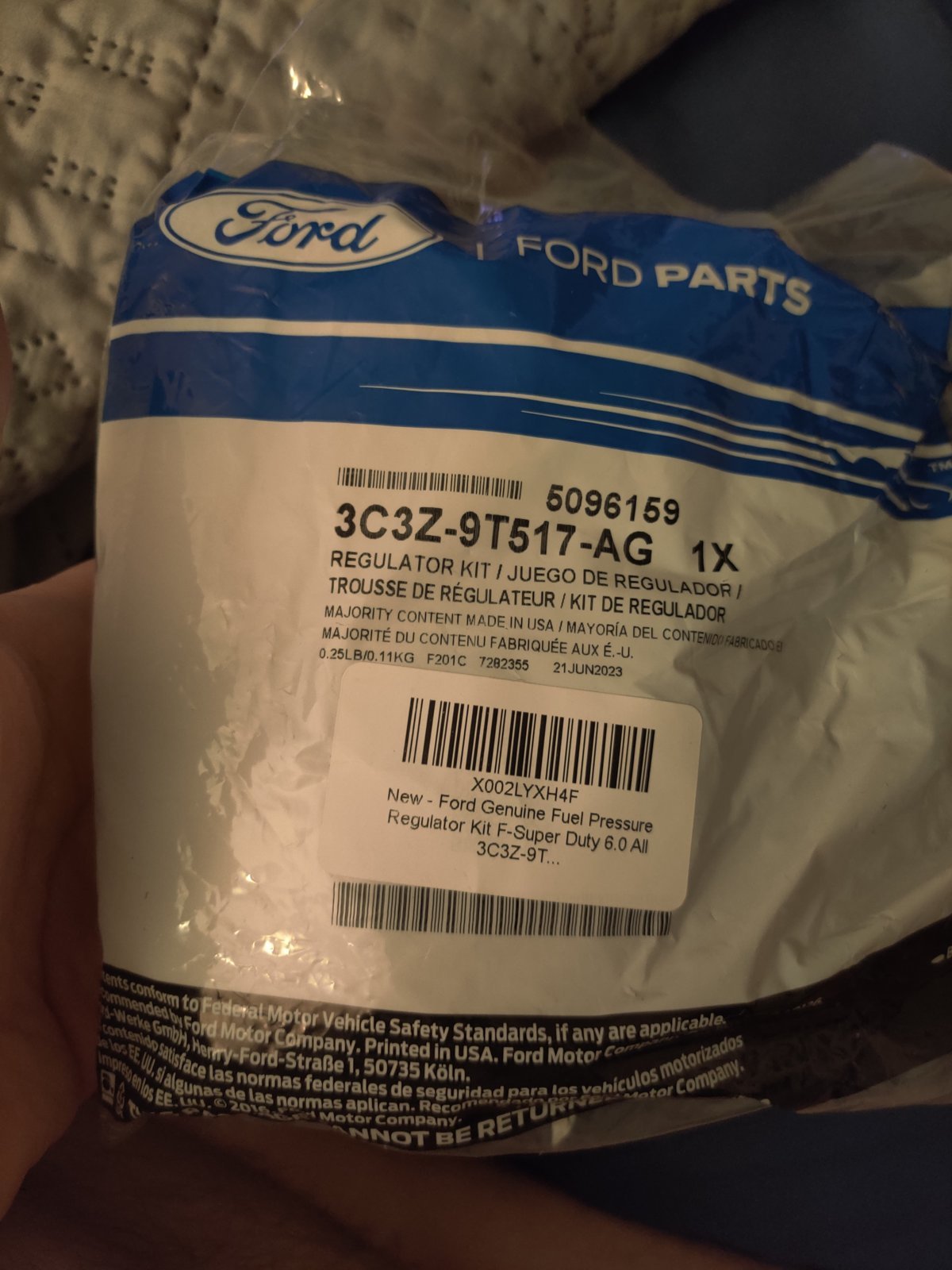

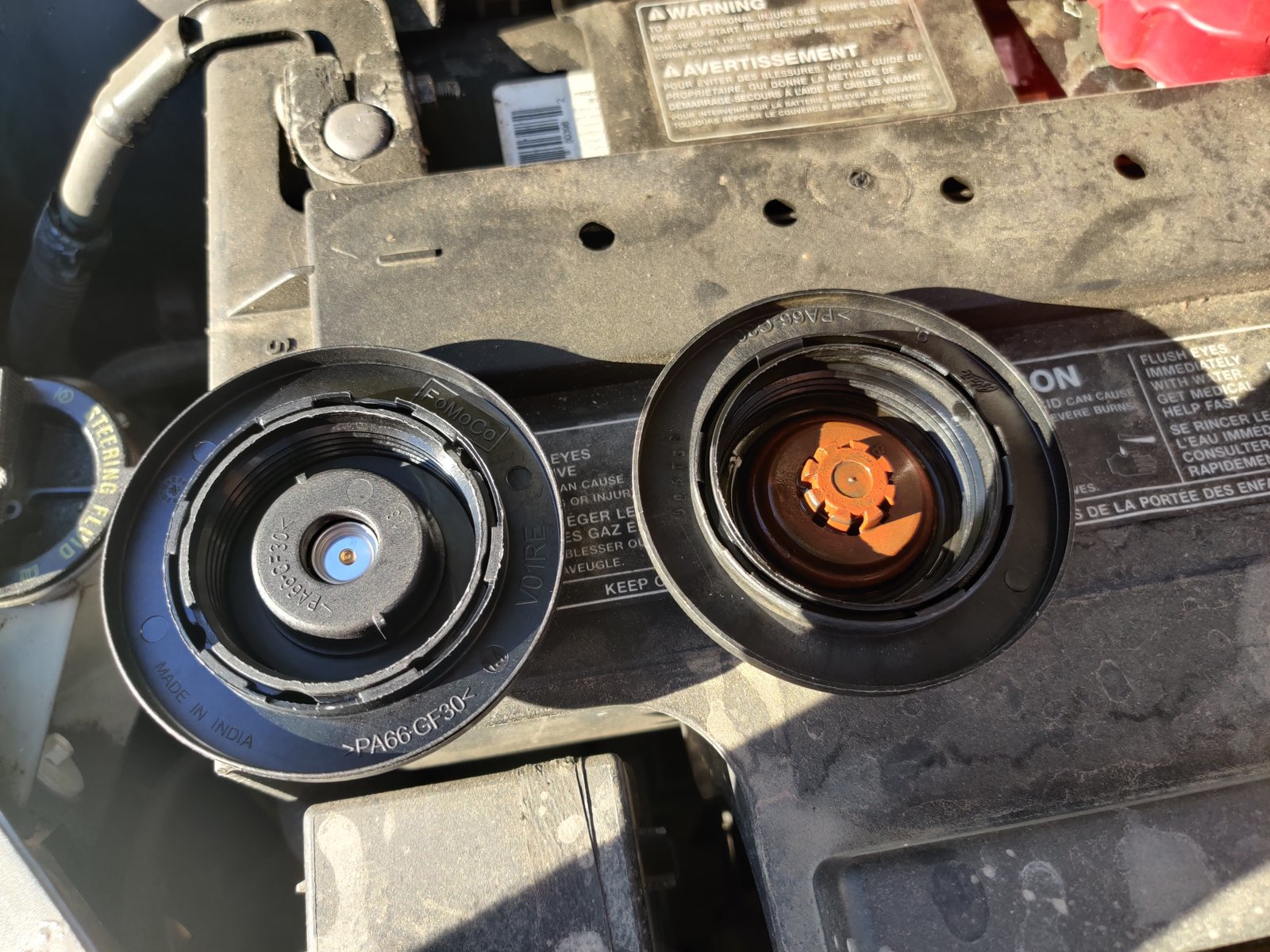

    So got a new updated OEM cap, cheap insurance at $8. Old one held pressure fine but idk the brand. Ordered a blue spring mod kit as it was on sale. @Torspd and I might also look into the upgraded kc turbo wheels.

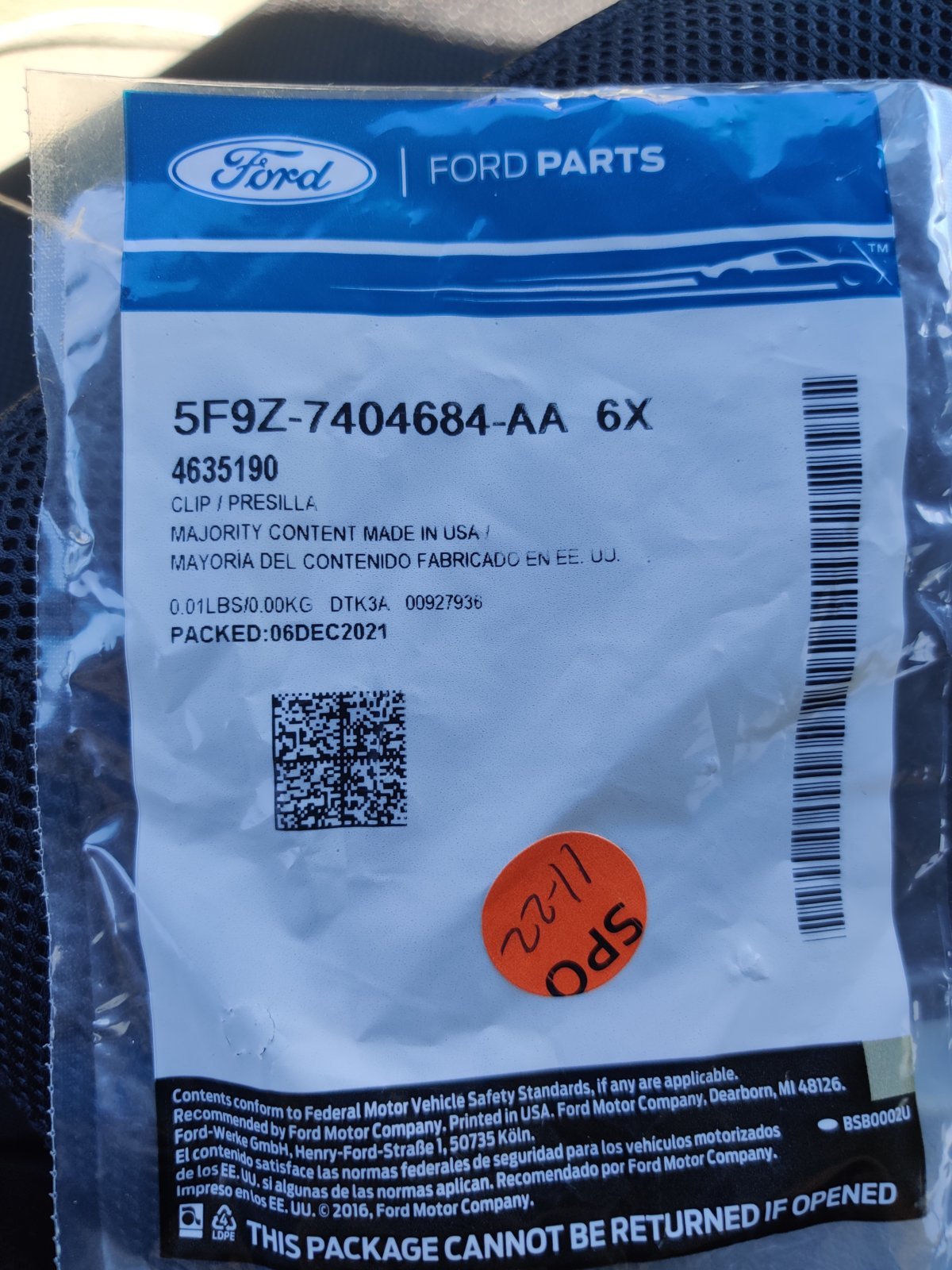

    Dashboard clip part number, couldn't find these anywhere.
    Just an fyi to just run the OEM blue spring vs the aftermarket.

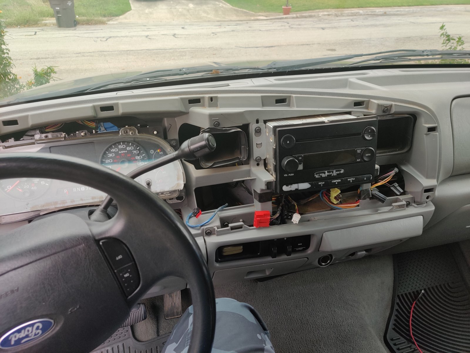

    The clips showed up and now the dash is happily retained.

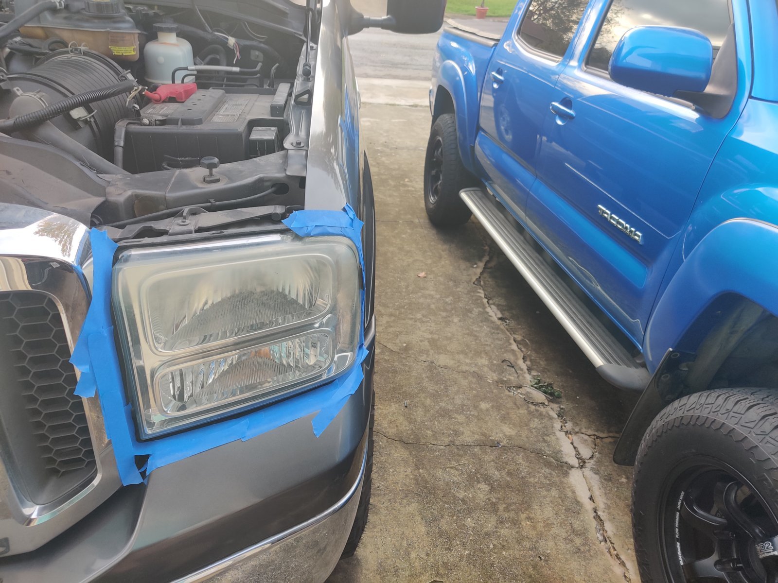

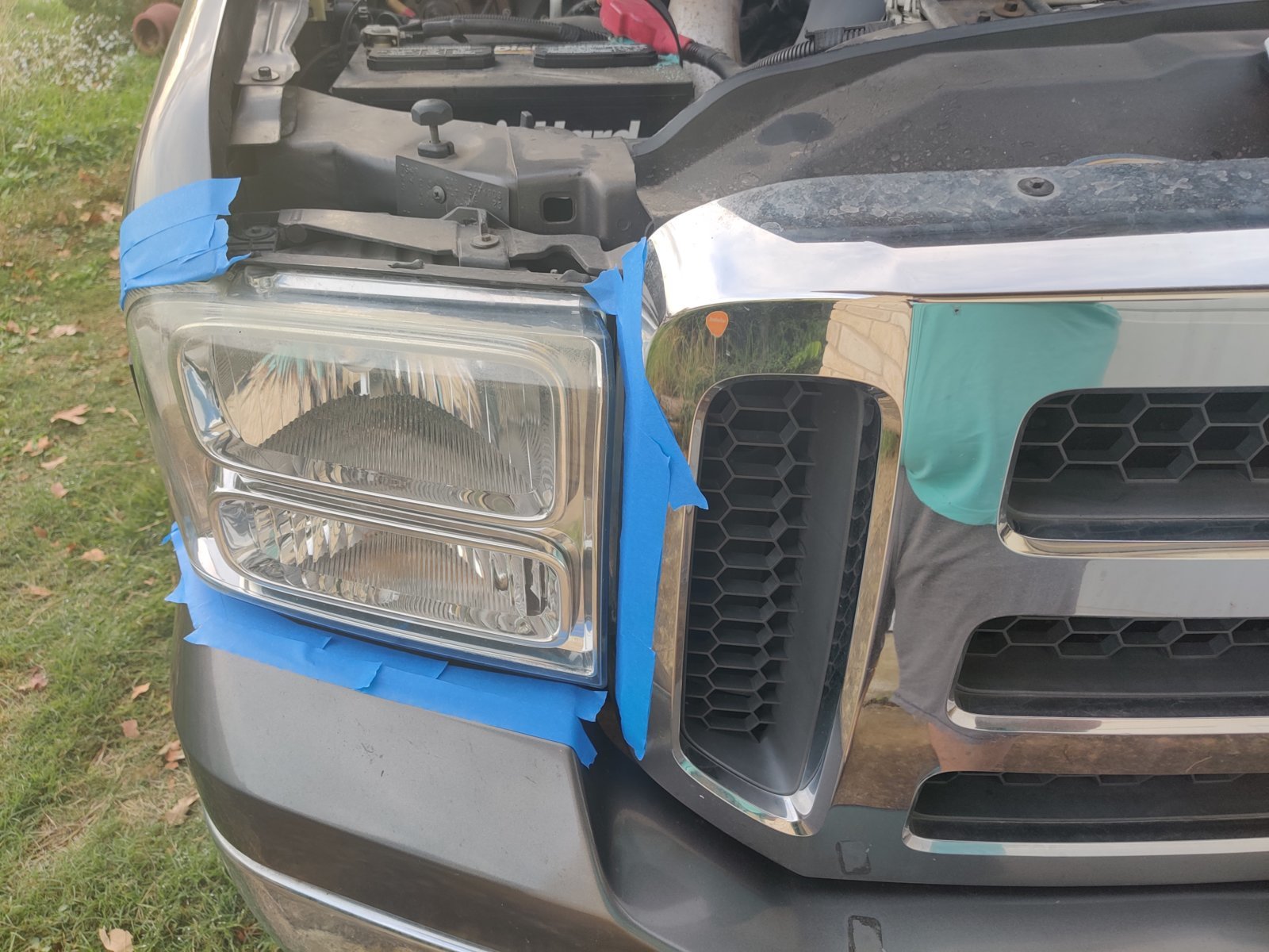

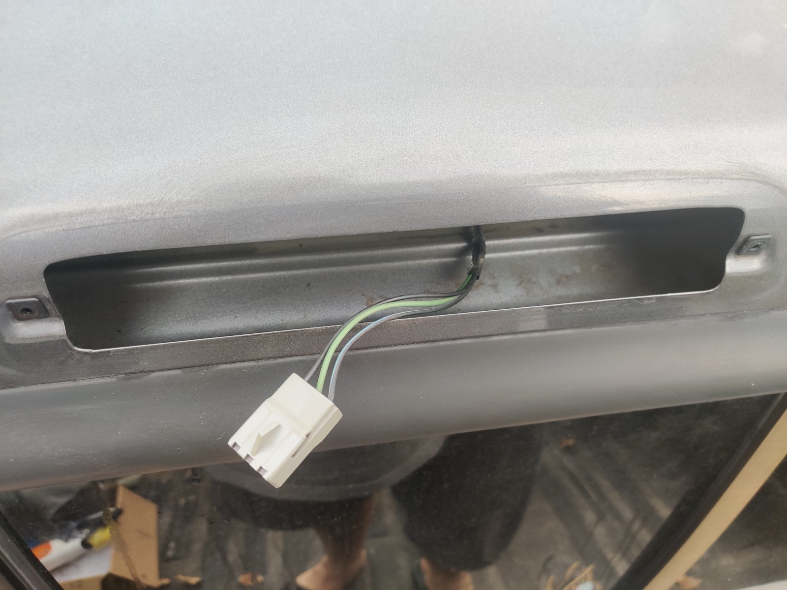

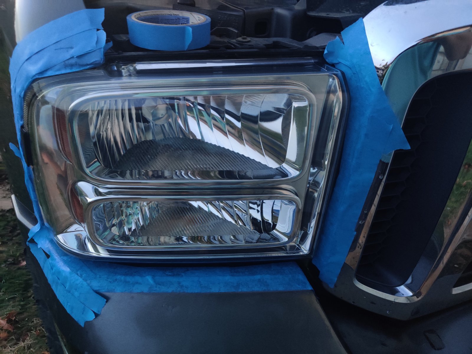

    Did the headlight restoration. I think it help a little bit.

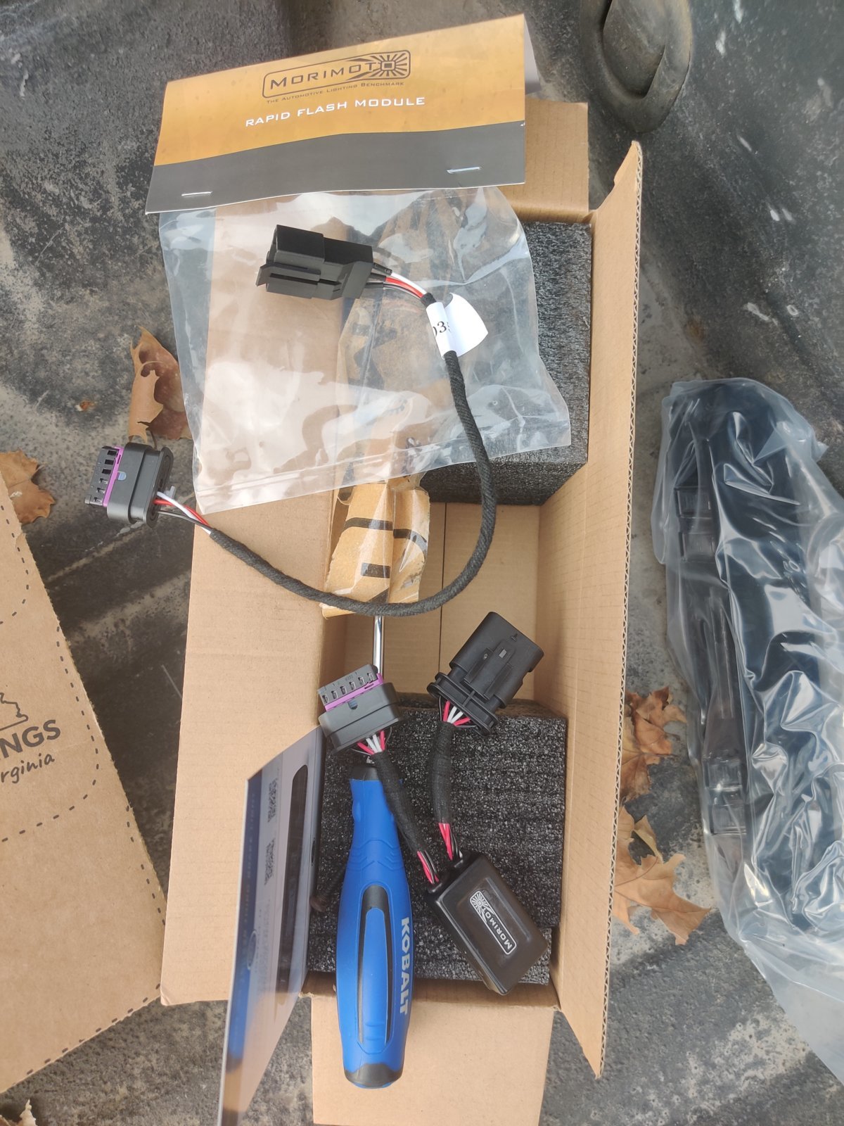

    3rd brake light came in thanks to @memario1214
    memario1214 likes this.

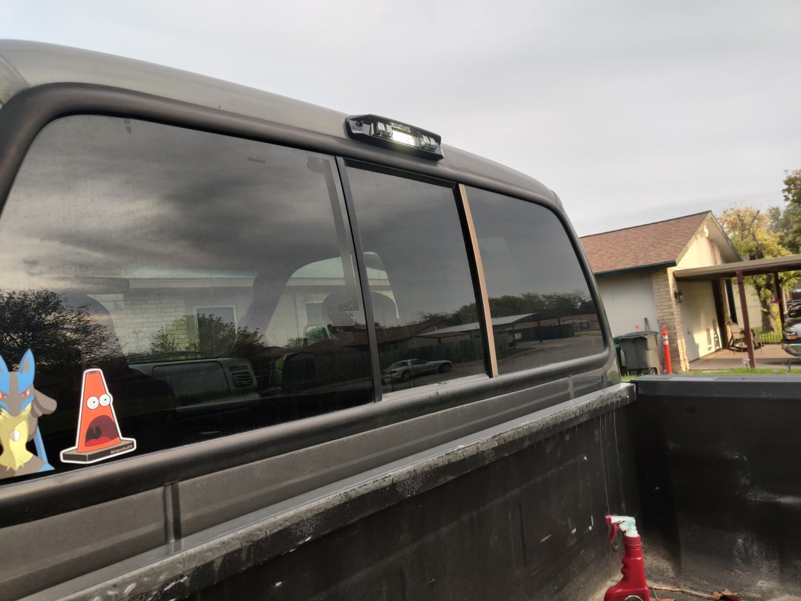

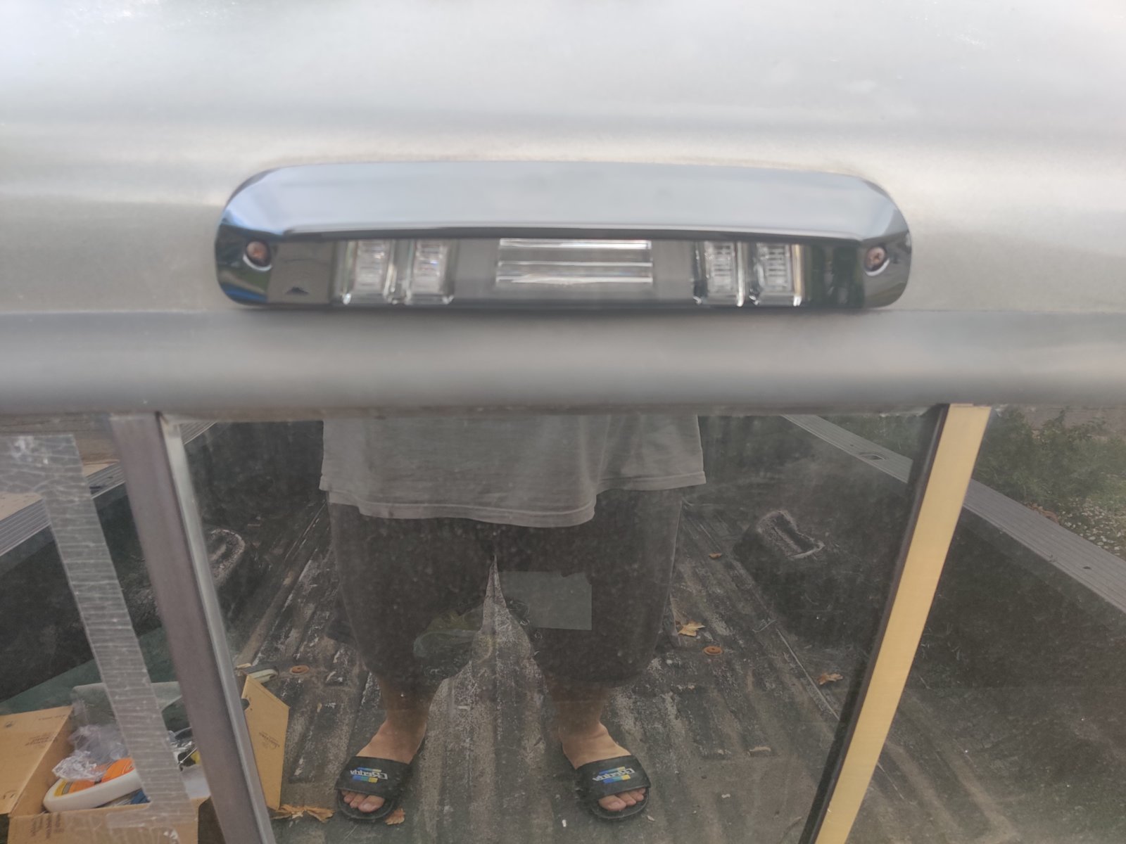

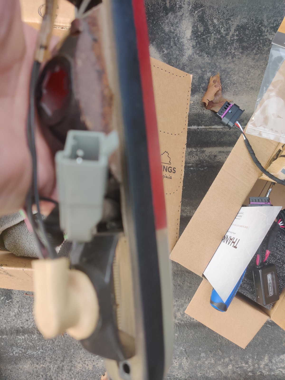

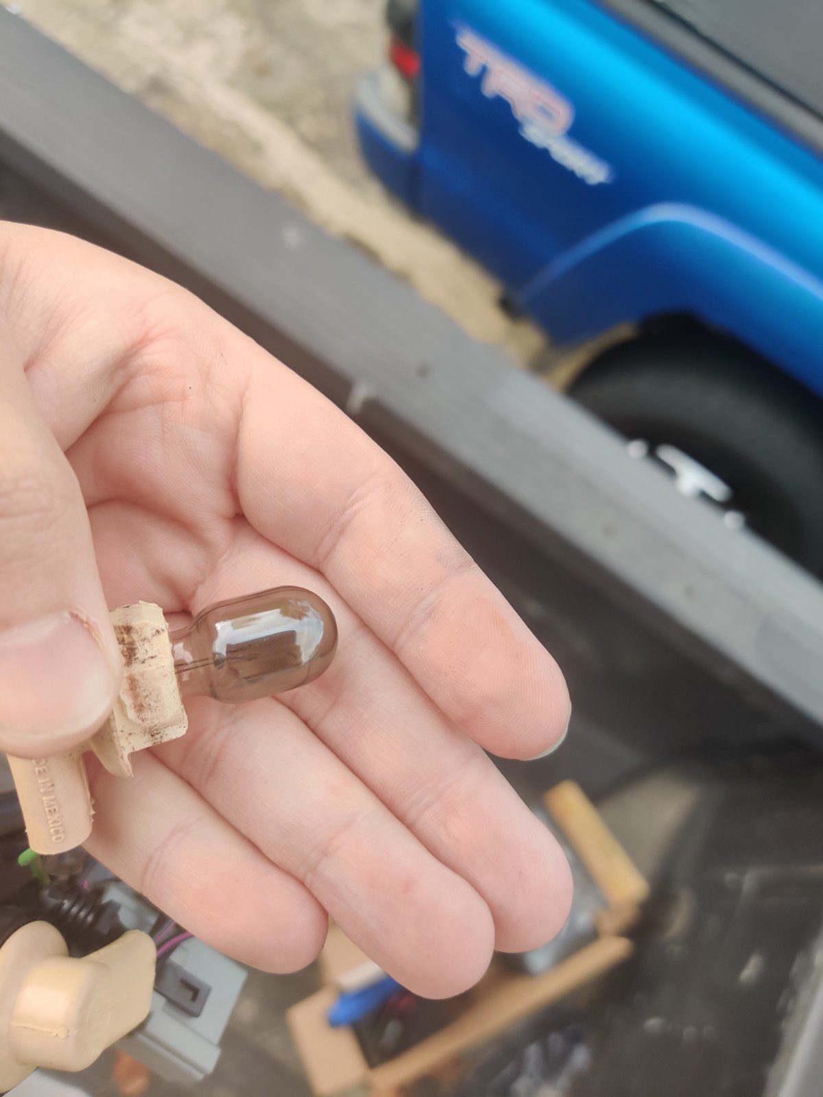

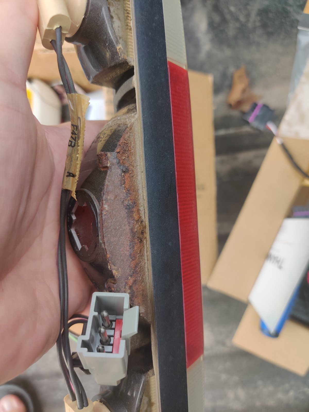

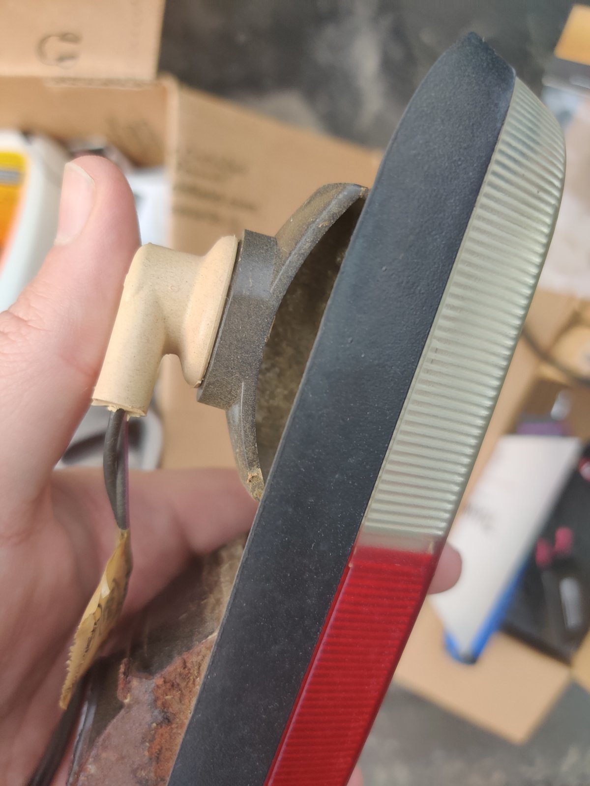

    So my suspicion was accurate where the brake light blue was burned out. The housing itself was pretty rusty.
    Inside of the cab was very clean. Weird.
    What also did not make sense was the lack of carbo light bulbs.
    Finished result is decent. I might need to invest in thee morimoto taillights.

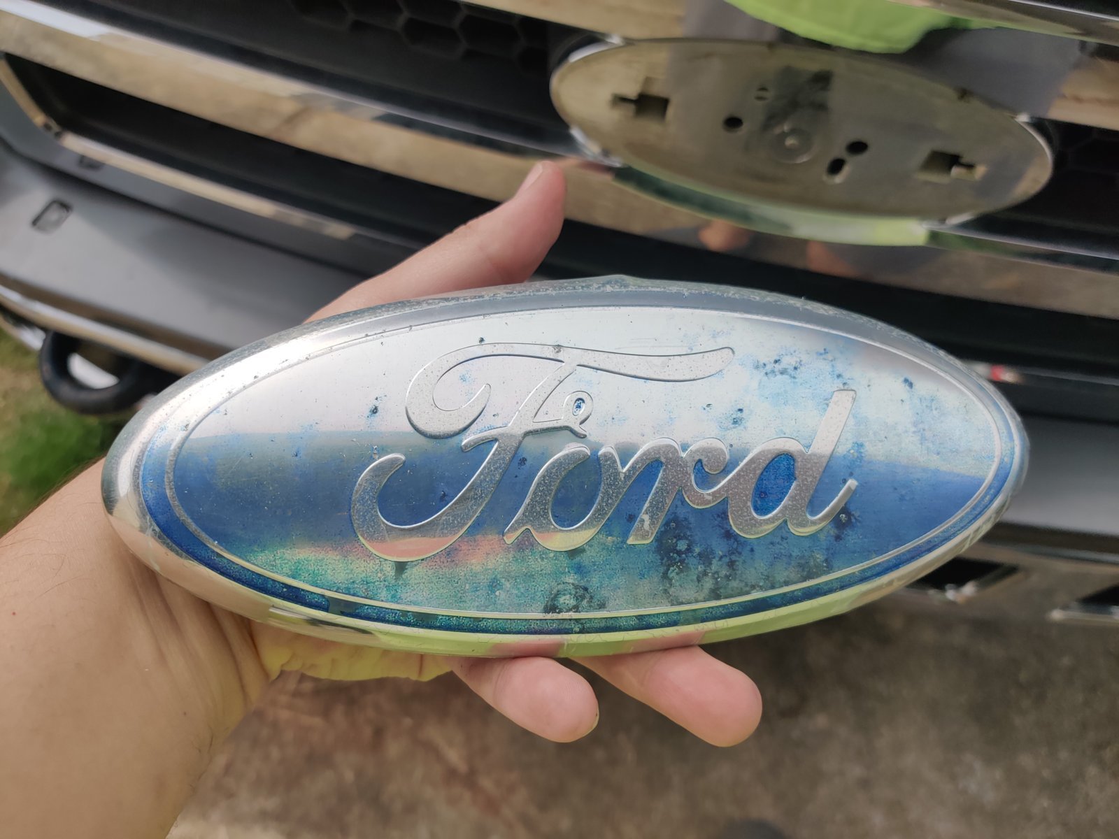

    New grill badge was delivered as well. I'll most likely install both the new badge, speakers, and blue spring tomorrow if the weather is nice.

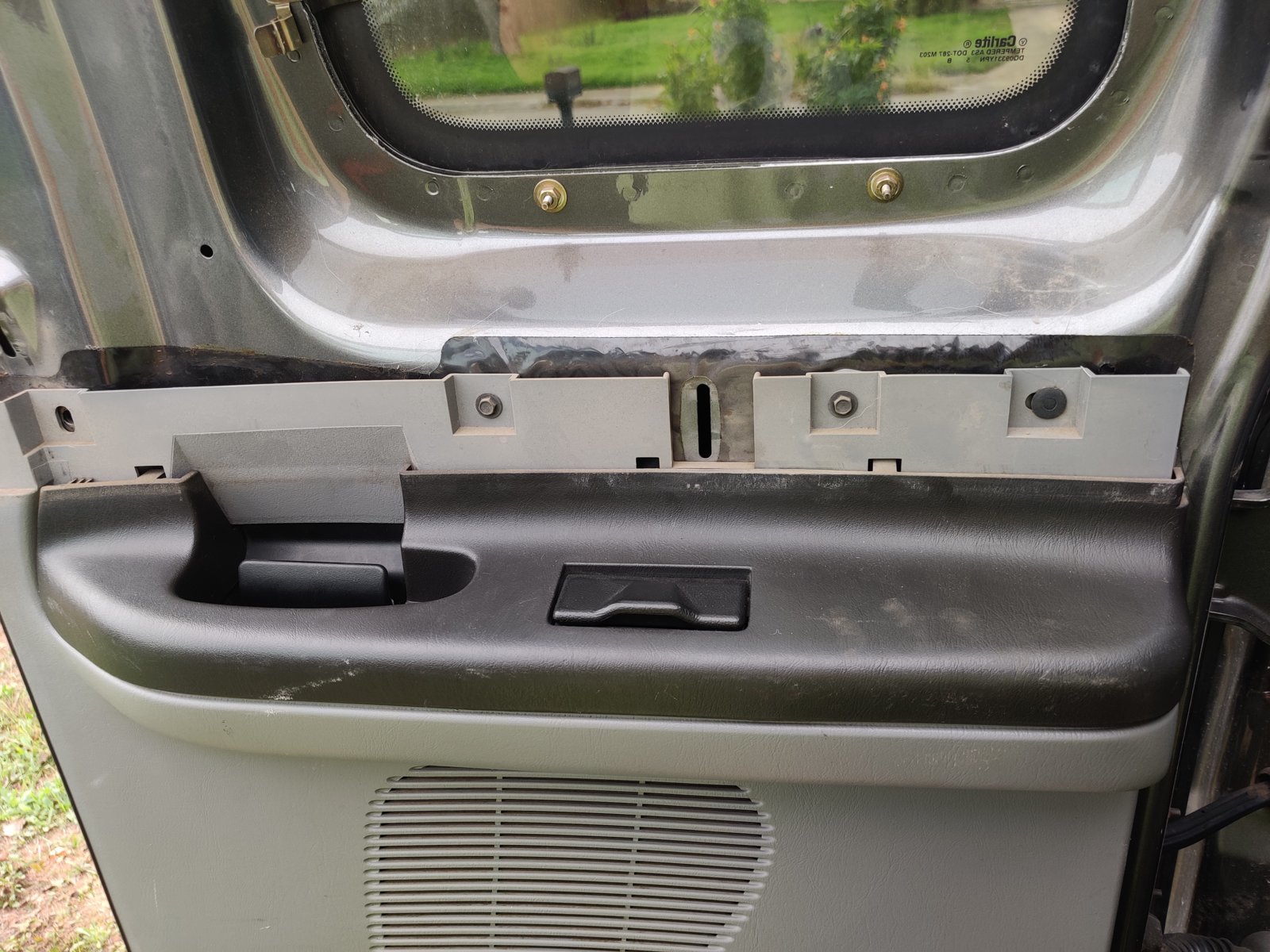

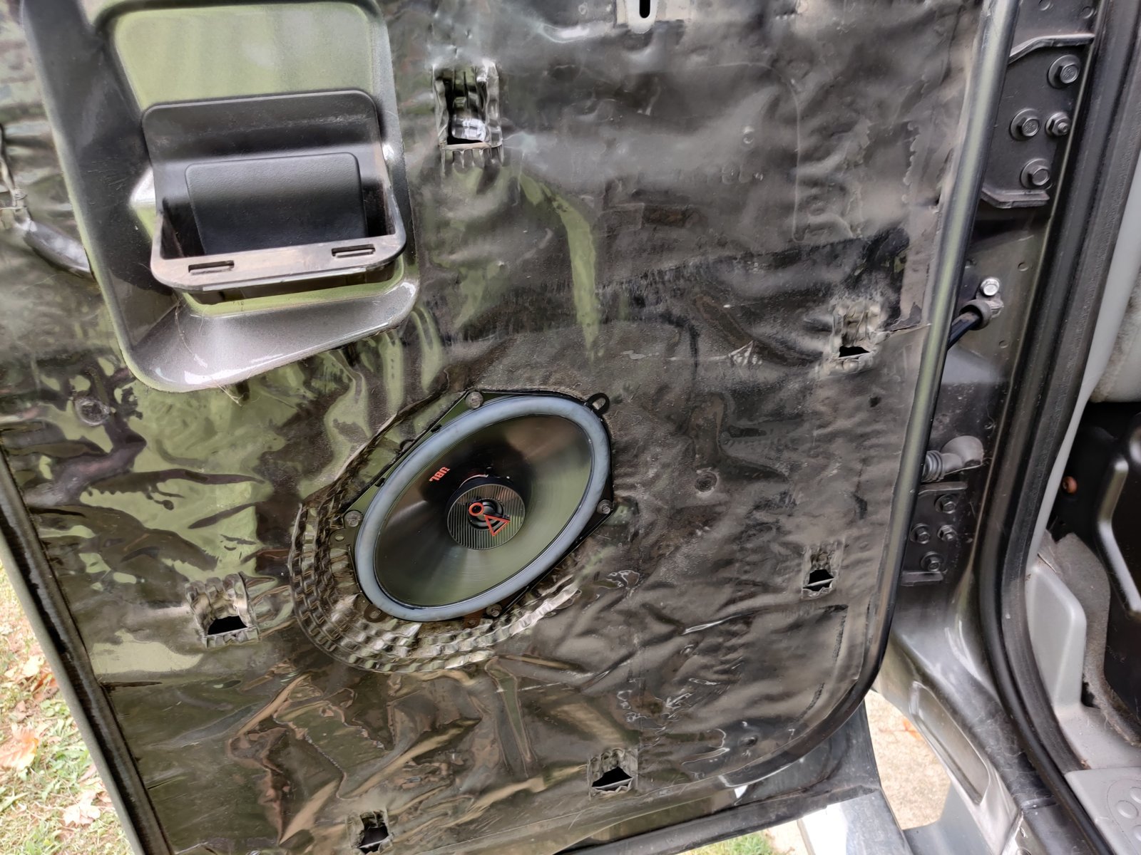

    Went from this
    To this
    Looks much better.

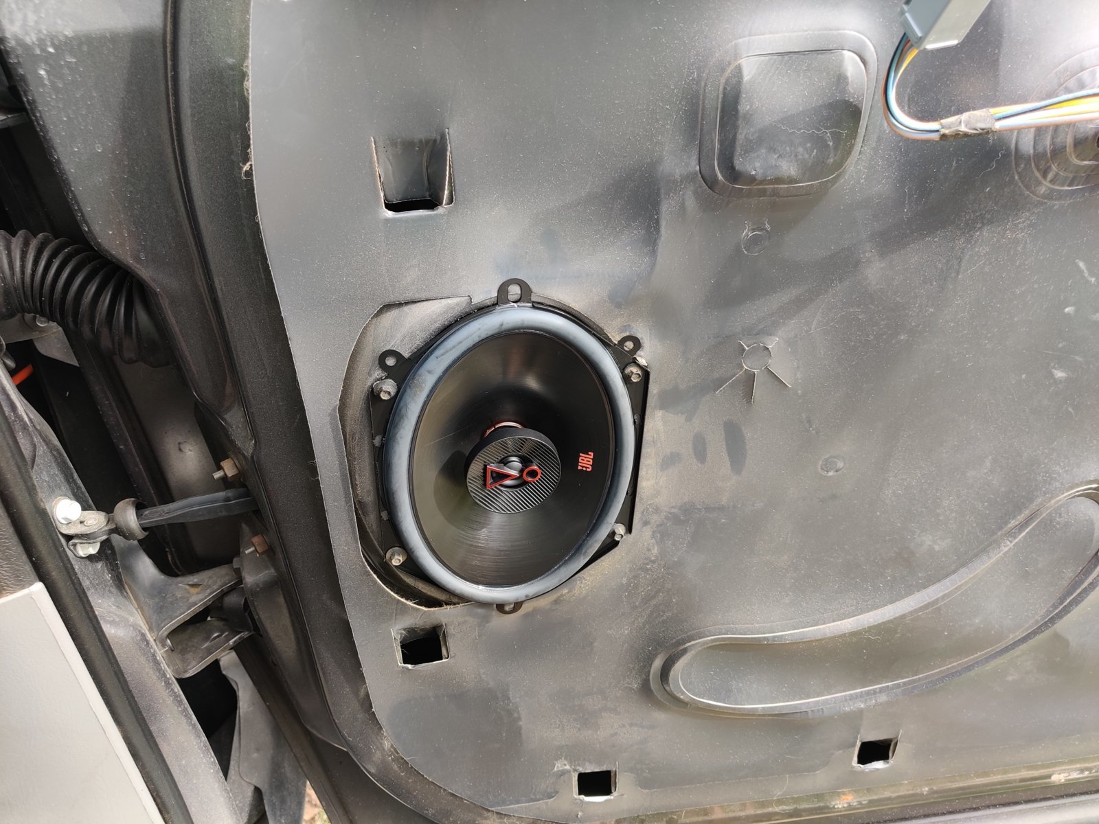

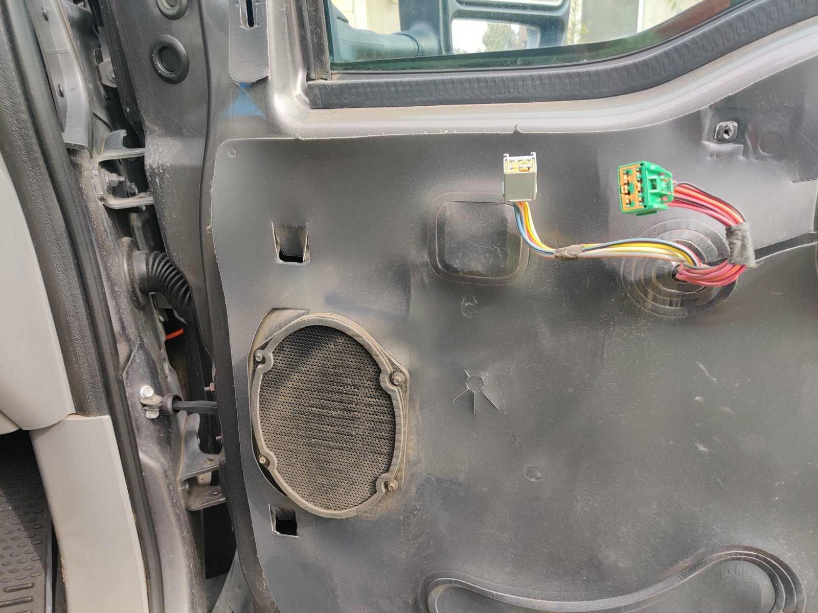

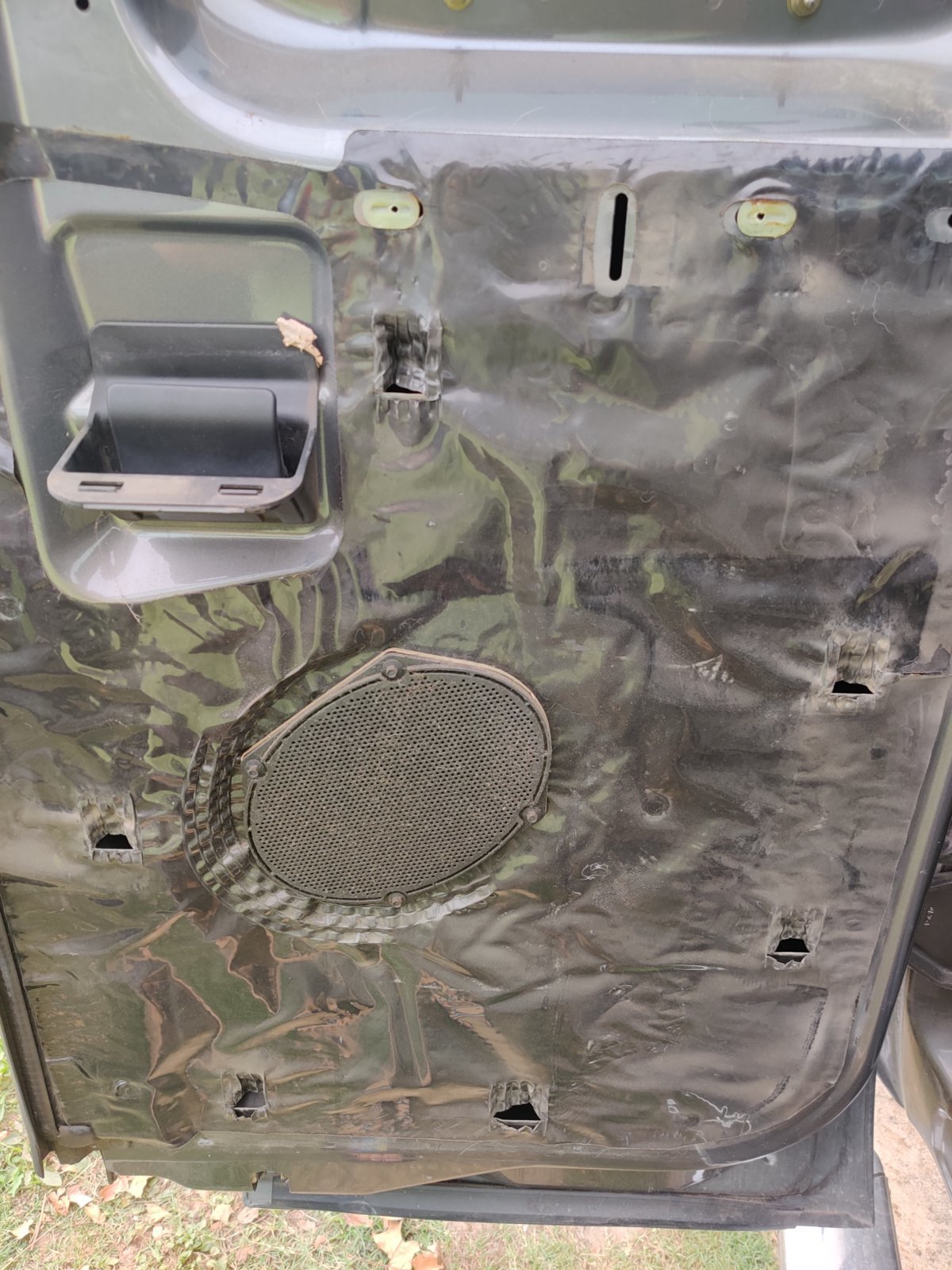

    Seems simple enough that even I can install these speakers.
    IMG_20231202_140416.jpgfront door installation.
    Undo the window hinge from door
    Back door done. Same on driver side. Sound is so much better. Will pick up some fuel filters later for the blue spring install.

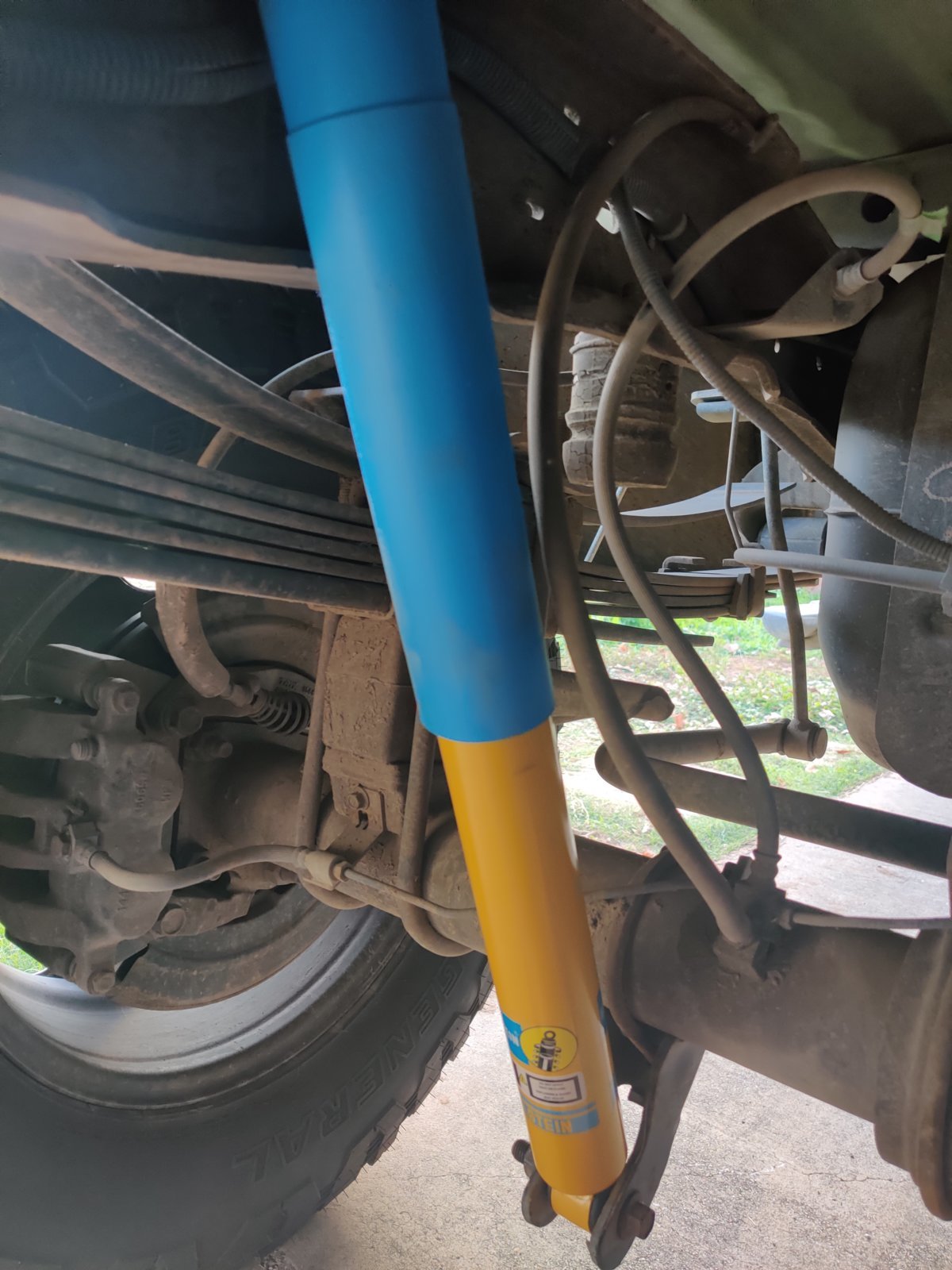

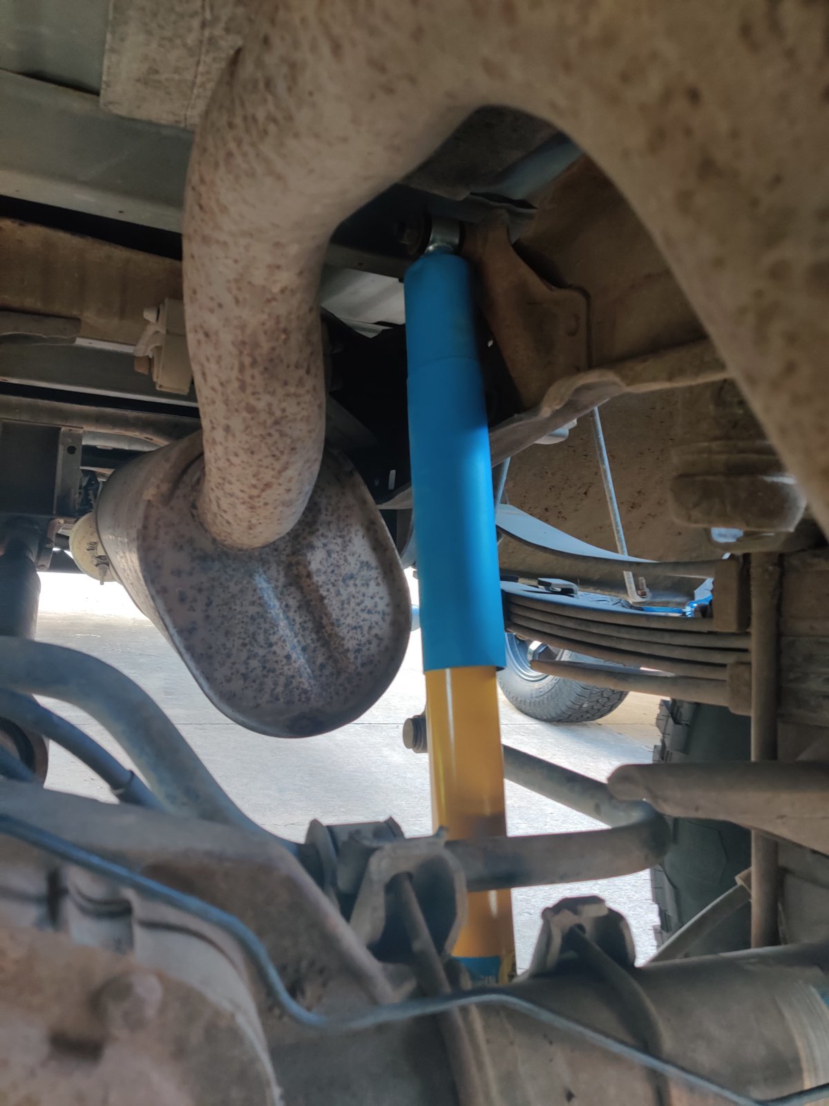

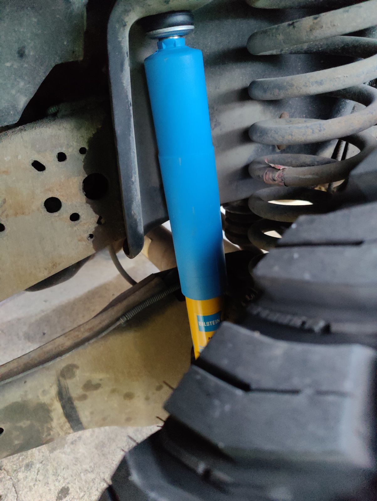

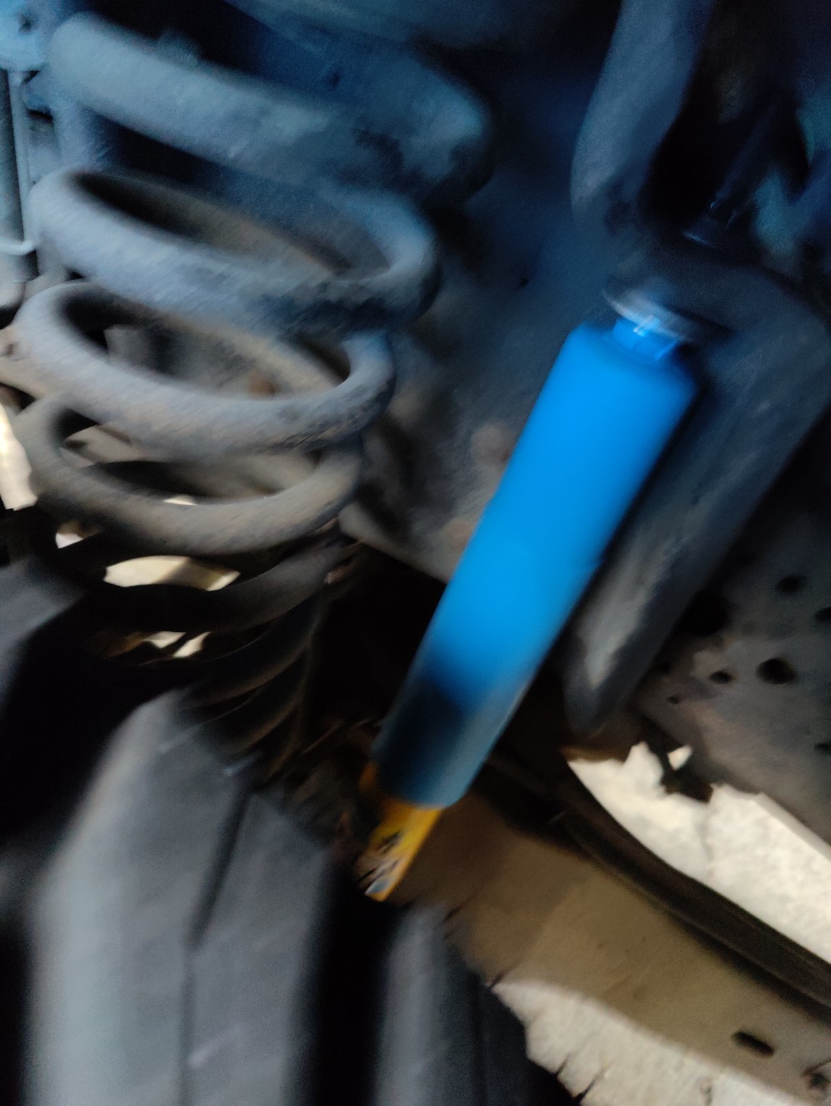

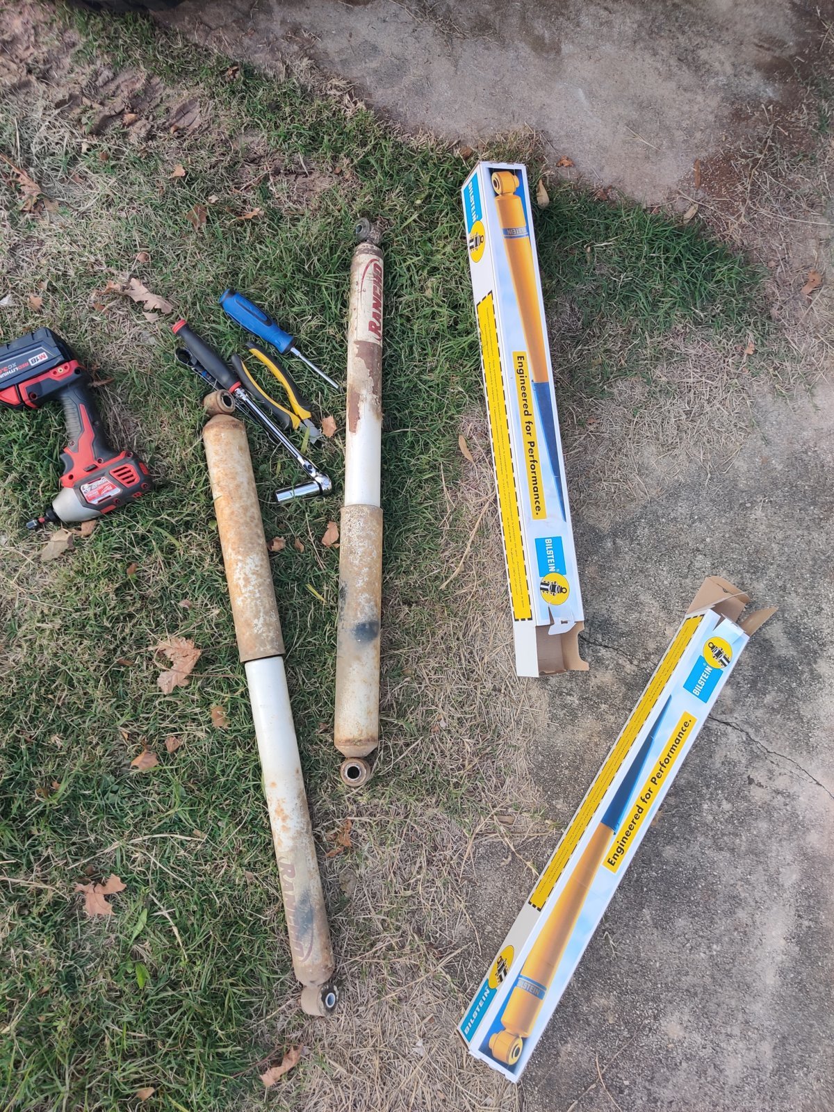

    New shocks arrived.
    Rear.
    New Bilsteins in.
    Old shocks out, I think they're the originals. I ran outta energy and daylight so I'll do the fronts later. The rear shocks have MUCH more resistance than the old ones. Should help the ride and handling.

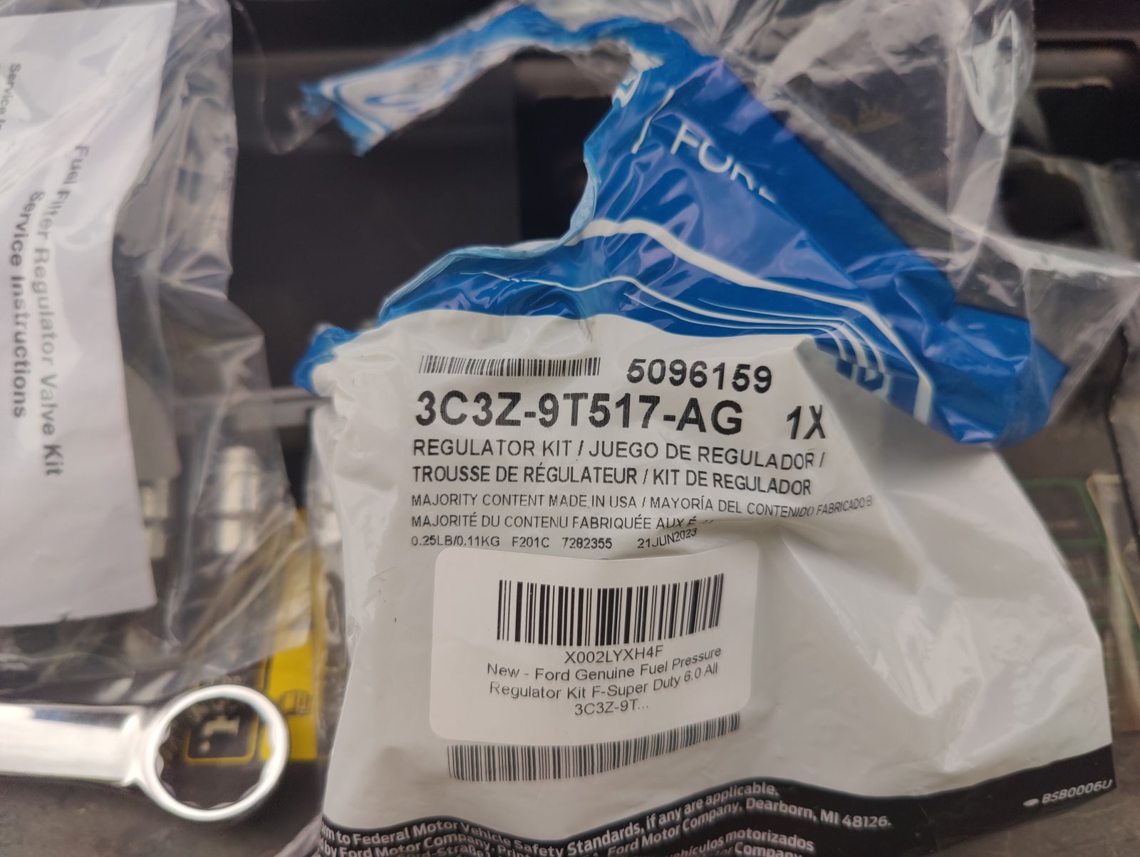

    no pictures as the screen on my phone is only half working but i kinda fixed the driver side rear speaker as the oem connector had pushed the pins out of the speaker adaptor. i might have to order another set as no matter what the pins will not stay in place, however the speaker is working. I have also installed the front bilsteins. wow what a workout. the oem ranchos were JUNK, also the passenger side top bushing was installed wrong from the factory as it was pinched at an angle, but all the bushings were wasted. passenger side axle shaft seal is leaking a bit so it needs to be replaced but that'll be sometime next year. i am hoping tomorrow that i will be able to install the mbrp turboback.

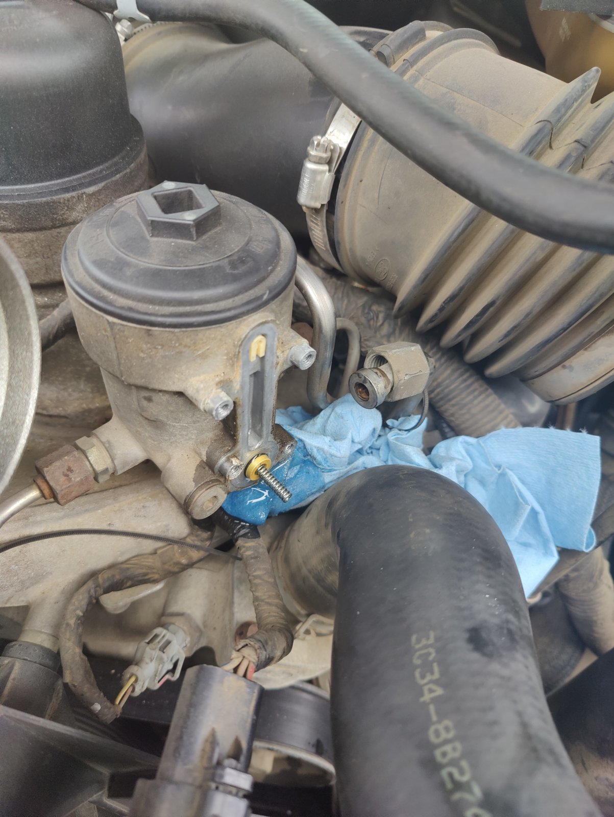

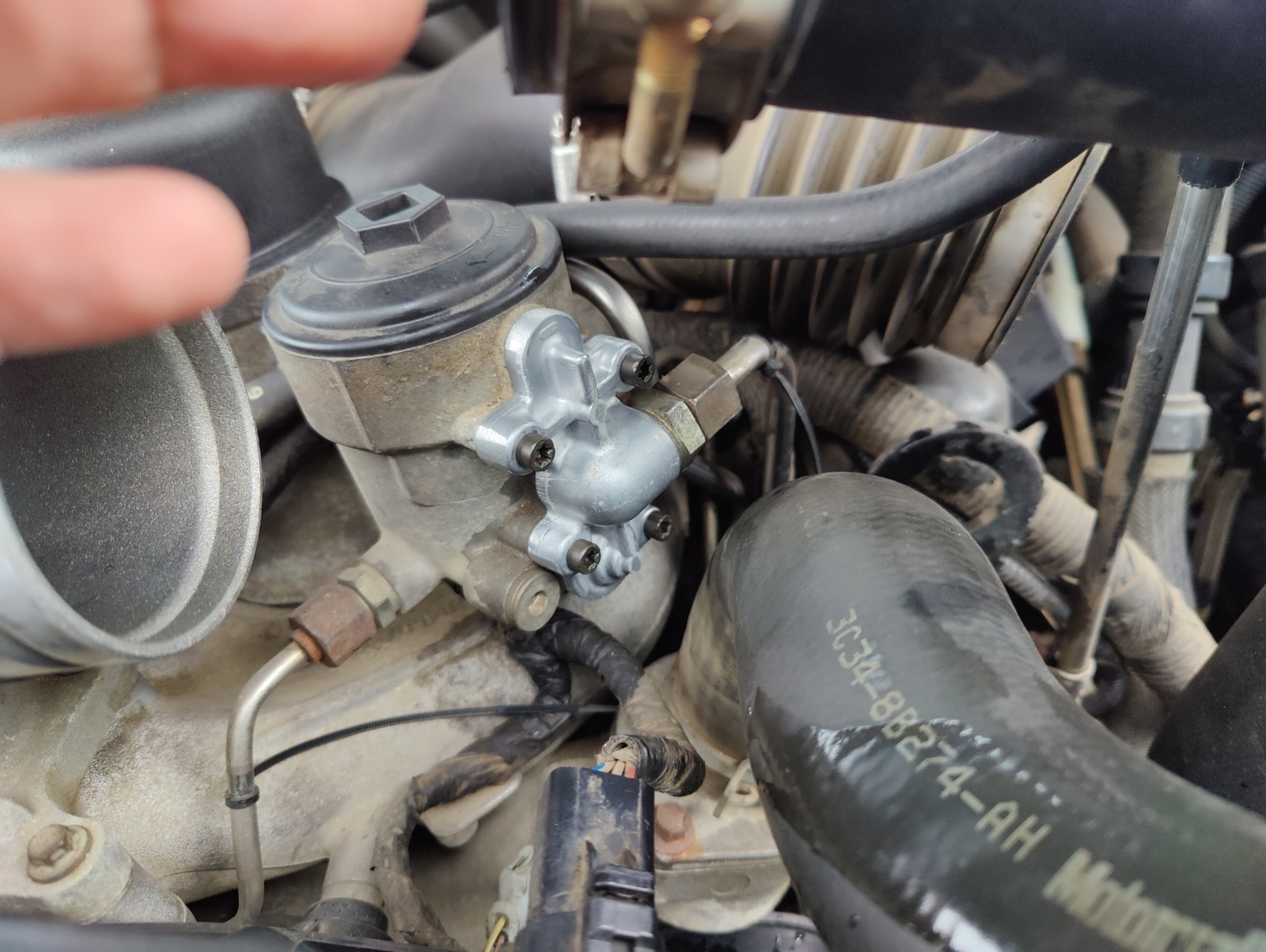

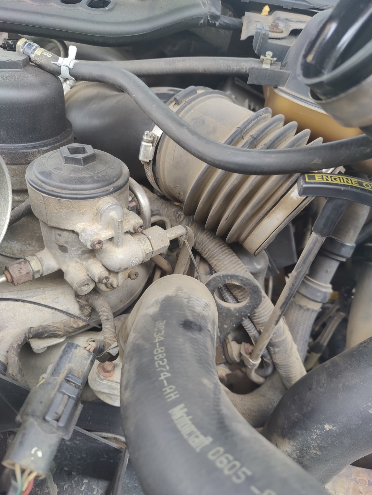

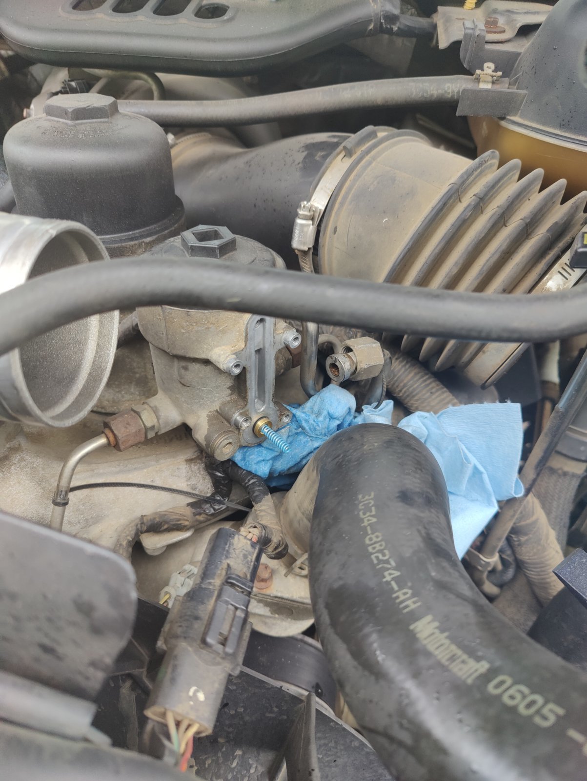

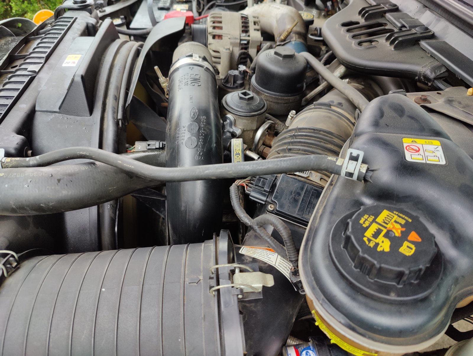

    Decided to do the blue spring after work.
    So they don't want you to clean the maf. The stock intake while I understand it's construction, does not make taking it off suck any less. Will be looking at a new one for sure. Afe momentum vs s&b intake.
    So going by the zip ties there is evidence that someone was here before. IDK what was done but there was work done. I was hoping that maybe the blue spring mod was already done however the casting on the cover indicates that it was not done. Only way to confirm is to pull the cover off.
    Confirmed blue spring was not done.
    A little clean and it's ready to be reinstalled. Rain is in the area and will pause installation until it passes.

    Got a small break from the rain. Primed system no leaks, will reattach intercooler and intake and test the truck once the second rain has passed.
